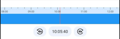

I am using a Hikvision camera, and when I enter playback mode, the timeline appears as a solid green bar without any highlighted event markers to indicate detected activities.

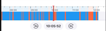

On my iPhone, the event highlights are displayed correctly, as shown in this screenshot:
Screenshot

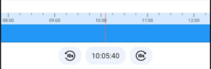

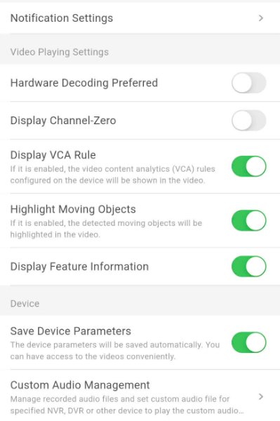

However, on Android, the event highlights do not appear. Here are my configuration settings and the playback screen on Android:
Screenshot
Screenshot
How can I make event highlights appear on Android, just like they do on iOS?

Are you logged into the same Hik Connect account on the Android phone as the iPhone? The markers don’t work if you added the system to the app as a local device.
Not all are different accounts. I use several Android devices with account A, which is shared with three other accounts: B, C, and D. Among these, the two accounts (B, D) using iPhone (iOS) are highlighted, while my account and the remaining shared account (both using Android) (A, C) are not highlighted.
You need to either log in on the app with the same account that the system is registered to OR use the account that the system is registered to, to share the system to other accounts. When sharing you should ensure that the appropriate permissions have been selected before sharing the link/generating the barcode. If you already shared the system, try removing/de-authorising the share before recreating it (making sure permissions are correct)

Some functionality in the Hik-Connect app is limited to systems that are registered to a Hik-Connect account. Push notifications for events, Human, Vehicle, Event filtered playback, remote arming/disarming of event notifications are some of the functions that are not possible unless both the system and app are logged in to the same account. The server is not necessarily in China, it could be anywhere depending on your region. It’s still worth having your system added to Hik-Connect using its local IP address as a backup in case of issues with service.

Probably down to the age of the DVR or firmware. The event filtering is only available in later firmware. As Hikvision stops releasing new firmware for models after some time, it may be that the feature won’t be available for you even on the latest releases firmware. That’s just the way it is unfortunately.
