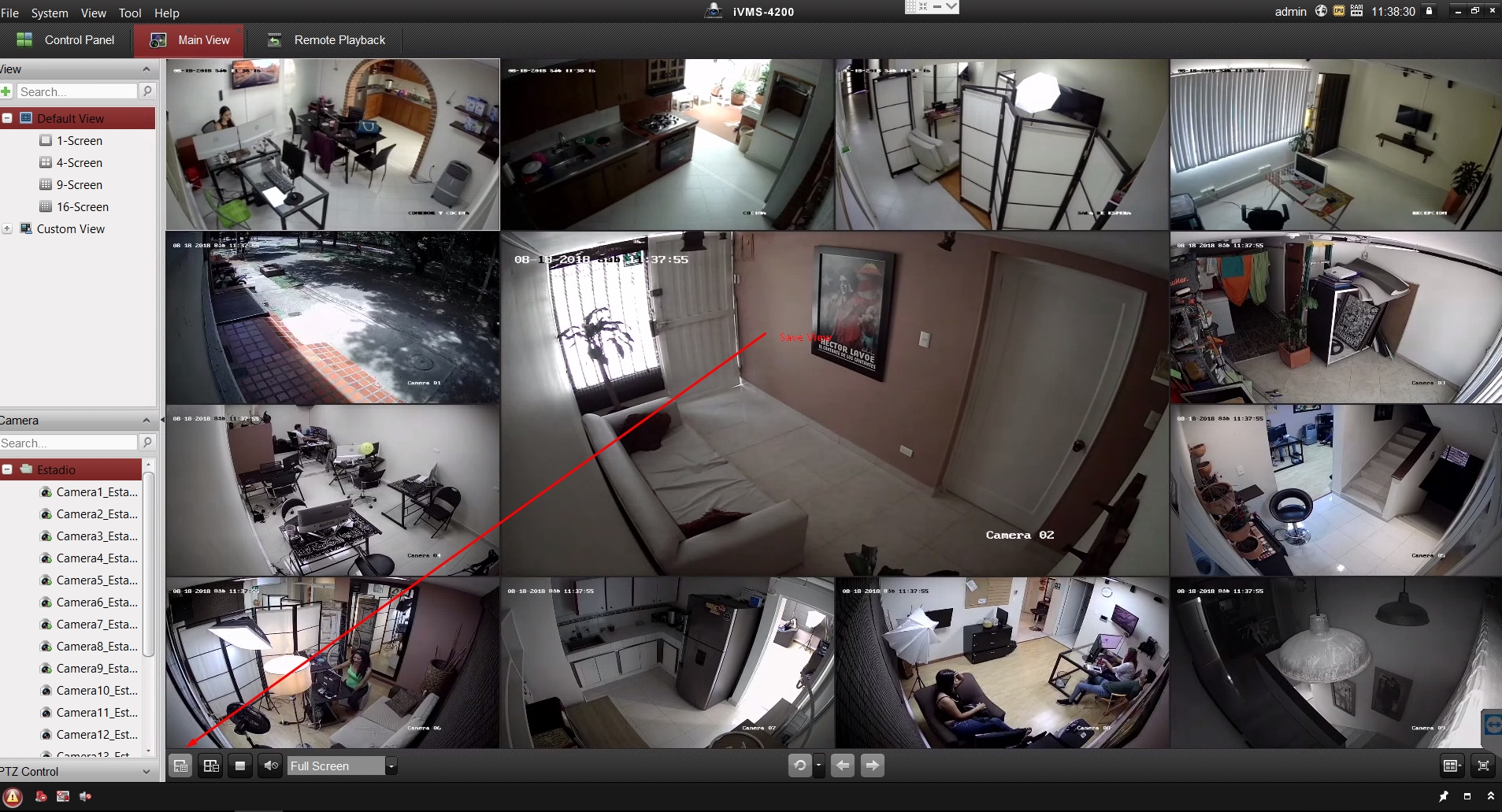

You can achive that in version: iVMS-4200 following the next steps:
1. Go to "Main View" and set up the "Custom View as you wish"
2. Once you have the desired view, click the small button at the bottom left of the screen called "Save View"
I hope it helps
