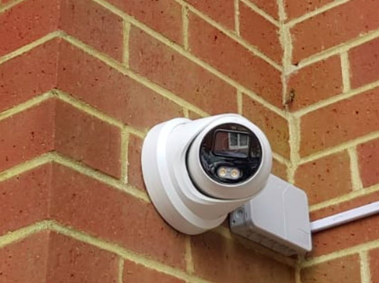

The Turret on the other hand can be placed on a vertical wall and has a huge range of positions. You won't get a 90 degree left-to-right angle like a bullet but one of mine is covering the driveway at a tight angle that you would have thought only a bullet can cover. The turret is basically a ball that can be positioned how you like.

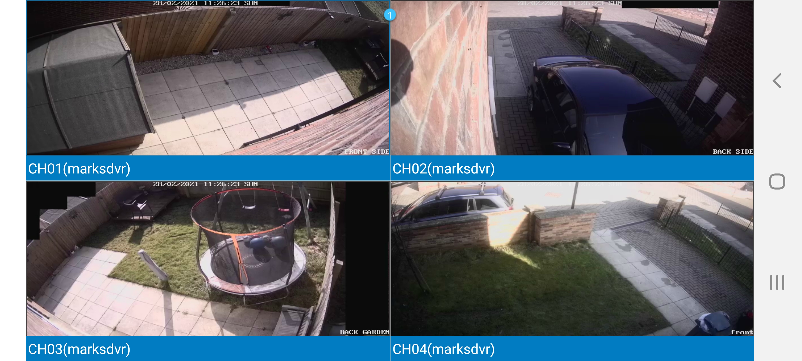

This is my current views.
Looks like you have it all covered as far as trigging motion alerts. Ch1 looks nice for line crossing. Only thing you may be missing is cameras lower down to capture faces. I have a lower one at front door, a dome to get people approaching door, and at the back garden a PTZ.

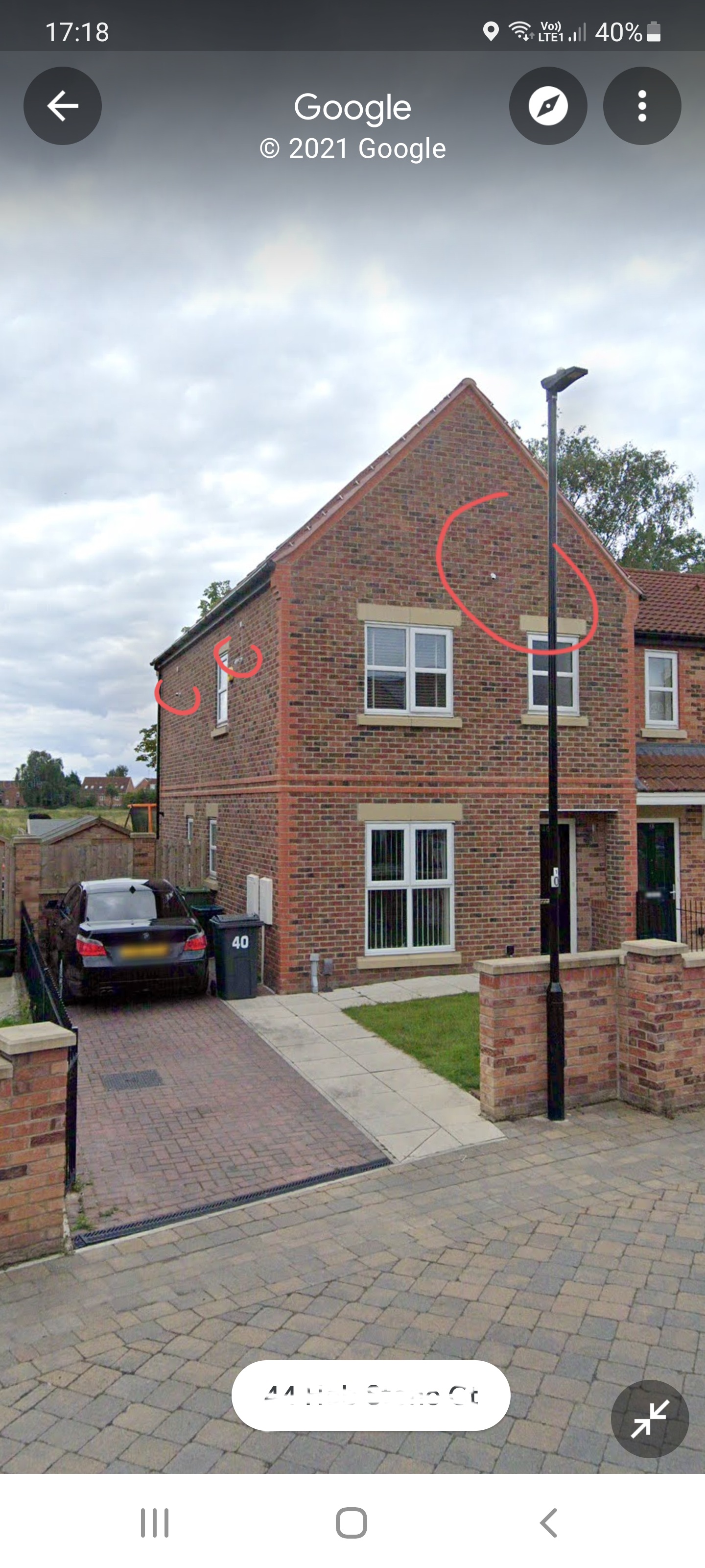

Those are where my cameras are at. All bullet.
So I'm relying on your expertise to tell me what best suits my needs in way of cameras.
It depends on your needs to be honest, what is it your hoping the set up will offer you? If you already have bullets there then you can just replace it with the ones you initially intended. I was going to install bullets but after some reading turrets kept coming up. I think as you installing them so high you wont have vandal issues like I would at 10 feet up, hence why I went for Turrets as one of the reasons, harder to knock out of position.
It comes down to your needs within the DORI standards which would determine a lot. Here is how I determined my own install. If I had my cameras higher up as you do then I would assume Recognize and Identify would not be a need. The good thing however is they will detect well due to angle. This is only my opinion based on my research and completing a CCTV installation Course, and being a Telecommunication Engineer. I have had a lot of crime in my area so had to think and research a lot.

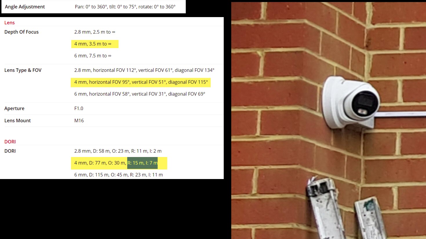

I have moved 2 cameras to positions in green aiming the way of the arrows.
I want to identify people including clothing. The side camera is lowish but could a turret camera replace it being on a side wall with an angle towards the front of the drive? Unless they are mounted horizontal then do they only aim up and down if on a side wall?
According to the specs it should be able to do a 90 degree, Mine is about 75-degree pan. My camera is on a side wall covering the whole drive way.
So I wouldn't need the bullet cameras on the side of the house if after all. This should do it.
I used the data for my model. After getting the field of view ranges, the DORI distances, and could see how much others who have them could pan and tilt theirs, I was sold on these. If the mini bullets are high enough then no problems providing you don't get the dreaded spider webs made over them which happened to me often.
Lower down the wall Hikvision Turrets which lock into position with a screw so they wont be easy to knock out of position like a bullet. Then very low down Dome cameras which at this time I don't think you can get with ColorVu and Acusence. Domes have their issues also such as collecting dirt, so I have to clean mine once a week.
One of my main concerns and misconceptions where that Turrets could not be put on vertical walls, and were limited in positioning, so when I got mine the first thing I did before doing anything was test its pan and tilt range, then I knew it would be fine for my side vertical wall.

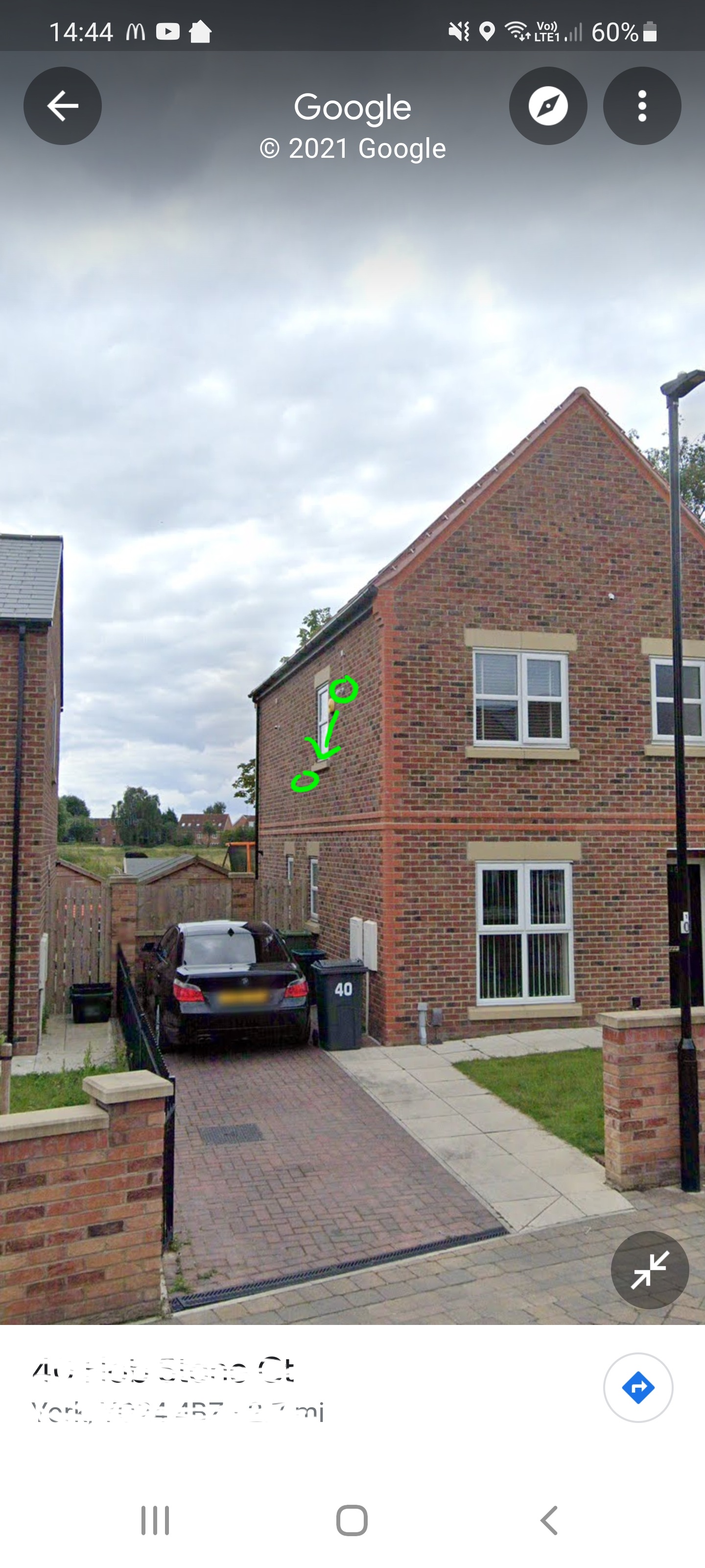

This is where my camera on the side is. Lower position is where I moved it too.
Do you think a turret would go here?

Looking at that location I would think it would be fine to capture your car as long as its not too close, this is where you need to look at the FOV and distances. You will ultimately need to hook the camera up to a POE to get a live stream to see how it and make adjustments accordingly. A camera from above the car providing its the right distance away could pick up someone walking into frame toward the car and trigger an alarm such as a push notification. Using my mind's eye I can see you may not get a full face shot unless the led lights come on, or you had a PIR flood light come on to make them look up at it.
Tweaking is the key. There is a tool called Lens Selection that lets you select the camera of choice and place its location. It shows you the FOV. I used this tool and made a 3D model of my house and planned off that but don't think many go to that length.
I have cameras from multiple angles looking at my driveway so I prioritized the ColorVu cameras getting the face over getting the ideal trigger angle as I have other cameras to trigger off the Push notifications. As it happens after some tweaking I did get both the face view and trigger if walking toward my car.
