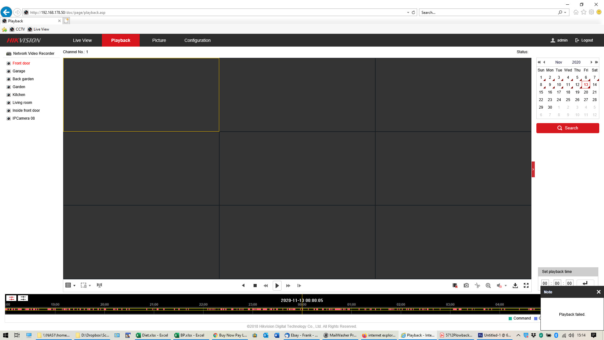

A can post a screenshot (thanks for the offer). What would you want it to show?
It'd be useful to see a full-screen view of the page with 'playback failed' error message showing.
I'm not sure how helpful this might be...
Hi, the screenshot is helpful - it confirms that you seem to be doing all the right things! :confused:

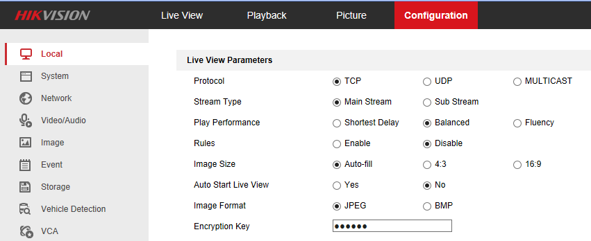

I don't suppose that you have recently configured an Encryption Key?
[I would expect a more precise error message]
You can disable encryption via the direct-connected monitor - might be a useful quick test.
Thanks. My laptop screen looks like yours but I cannot find a screen on the directly-connected monitor on which to set/unset encryption. Could you give me a clue please? And thanks for sticking with this!
You’ll need to do this by a directly connected monitor to the NVR, and going to:
Configuration -> Network -> Access Platform and untick "Enable Stream Encryption".

The solution I've found is outside of Kaspersky. If you go back into "Configuration" on the NVR and then "LOCAL", change PROTOCOL from TCP to UDP. You should then fine playback works again.
