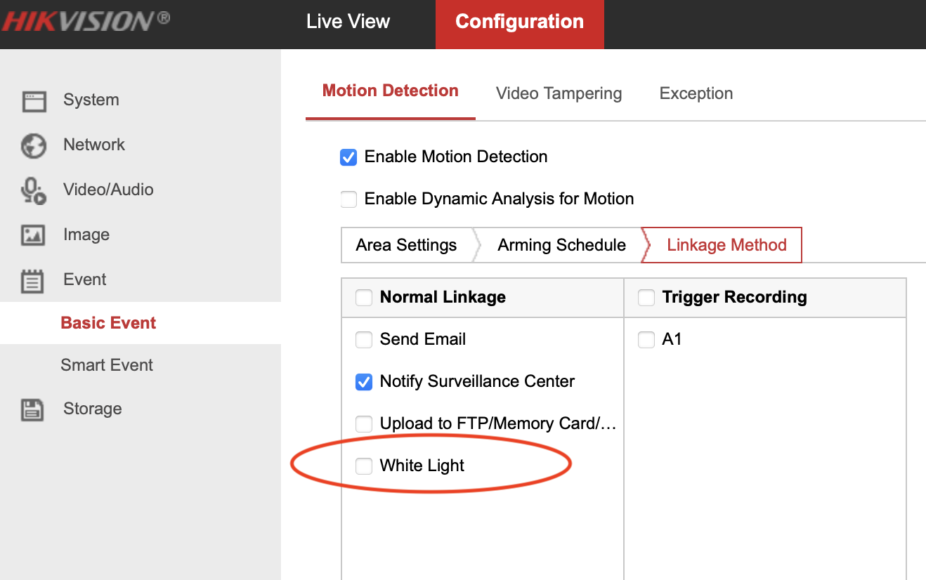

Hey all,
Can someone tell me if the newest version of firmware for my camera includes the "LED on with motion" option? I had to roll back firmware last year to 5.5.114 because the newer version did not include this feature. I'm hoping the latest version of firmware for my camera will include this feature, let me know. Also, can someone provide a link to where I can download the new firmware? See attached for my camera specs. Thanks.

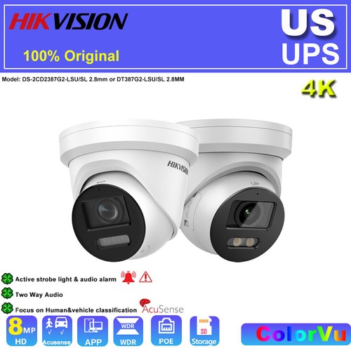

I have model DS-2CD2387G2-LSU/SL and using this latest version of firmware and the option for "White Light" is not there.
But I do have "Flashing Alarm" & "Audible Warning" but that is due to the model variation I have.

Well, that's a huge bummer. What does the "flashing alarm" do? Does it flash the LED? I like the setup I currently have where the LED turns on with motion and lights up the dark alley. I can't imagine why Hikvision would get rid of this feature as it startles people and scares them away.
Does anyone know of any similar cameras that will allow for the LED ON with Motion?

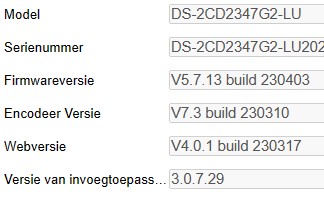

I have a DS-2CD2347G2-LU with latest firmware and the white light is working (supplement light and alarm). Like many others I tried all new firmwares but as this function was missing I rolled back to the custom 5.7.2..
Maybe because all of the rollbacks I start suffering from gaps in the recording (NVR 7608 I series) and spontaneous reboots (see post#19). I also found out, that when I login with hik connect and not ivms the output is set to "video only"and not sound
To solve this I start upgrading again, did restores, fresh installation, restore etc., but the white light functie is still there! My other problems also unfortunately
Yes it does. You have a G5 LU model which supports White Light on event in the latest firmware.
That's correct. The L(U) model and the LSU/SL models both use the same firmware version (G5 for the newer c revision models); however the LSU/SL does not support white light on event as it has the strobe light.

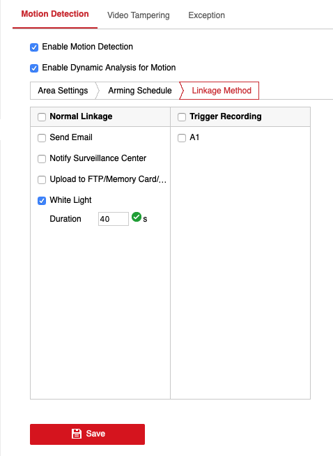

Got it. Can I set it up for the light to come on with motion and not flash? I don't want it flashing, I just want it to come on for whatever duration I set it to when it's triggered with motion. Thanks in advance.
You cannot get your model to flash as it does not have the strobe light. You just need to load 5.7.13 and that will support the LED being linked to an event as shown below (screenshot from G5 camera with 5.7.13):

No they haven't got rid of it with the newer cameras. There are two different variants:
Models ending LU - Has the feature (as it has no strobe/flashing light)
Models ending LSU/SL - Does not have the feature. It has a separate strobe/flashing light
Both of the above variants are current models - the LSU/SL model is not a newer version of the LU. They're the same model but the LSU/SL has two way audio (microphone and speaker) and also the strobe light. So for your numbered queries:

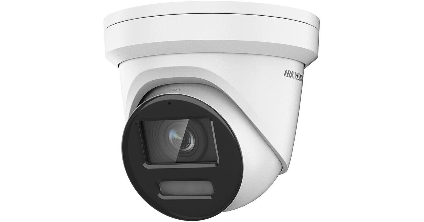

Okay, thanks so much for the great information. So if I buy either of these I'll be able to use the LED on with motion option in the latest firmware?
Do you see any much superior quality cameras being released anytime soon that I should wait for? I need about 6 of them and I don't want to buy something now if something really good is around the corner. I know it's hard to predict but if you are aware of any new technology coming out let me know. Otherwise I'm going to buy several of these soon. Thanks again.
The first one probably. What you need to be aware of is that there are two versions with the same part numbers. The original G2 hardware model used the G3 platform for fimware and will not be updated beyond its current version 5.5.801. The newer model uses the G5 platform for firmware and is the current model. The latest firmware for that is 5.7.13. On the packaging the newer model part number has a (c) at the end to show it's the later revision but not all sellers specify that information. Unless you speak to a seller first to ensure you're getting that (c) model you can't be sure. I think in the UK, the 2387 (8MP version) was never available in the older obsolete version, so I'd not worry about it here but that might not be the case in the US.
The second model you linked is a G1 camera. That is an older discontinued model (it has ColorVu but does not have AcuSense). I would advise against that.
