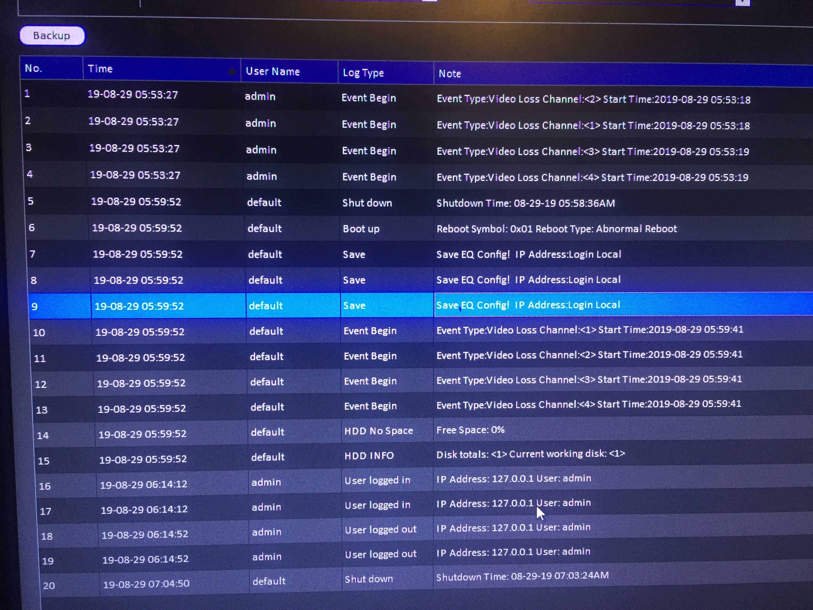

Hi all, I really hope someone can help. I have a Lorex 1080p HD recorder, device model LHV2004SP, firmware version 00007 and all of a sudden I've lost the video feed to all 4 camera's, i've formatted the drive as there was no space left on there thinking this would correct things but nothing. Does anyone know how fix this please?

have you check the power supply to the cameras? easy way to check if they are getting power is to go outside in the dark and see if the red infra-red lights are on, if they're not on new power supply, if they're on then may be worth factory defaulting the DVR.
