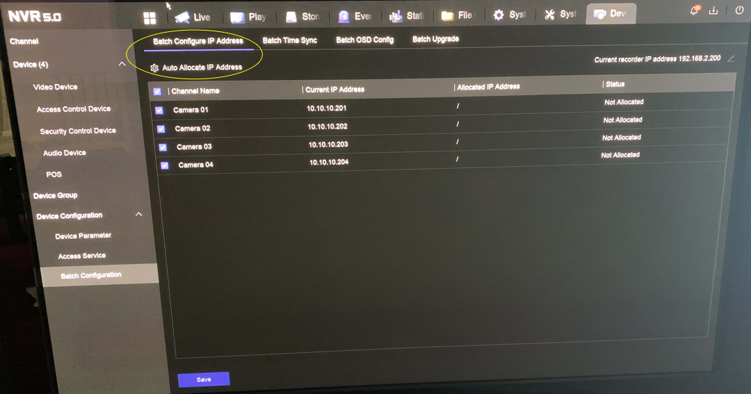

Just an observation: NVR GUI --> Device --> Device Configuration --> Batch Configuration --> Batch Configure IP Address (Auto Allocate IP Address)
Is this new,
with Firmware V5.04.080 Build Date 251226 ? (or was it there in earlier firmware releases & I never noticed? I don't use the NVR GUI very often.)
Note: doesn't seem to be available in Web GUI.
hmmm, ok. I guess I missed it, whenever it was when HIK added Batch Configure IP Address (Auto Allocate IP Address). In any event, thought I'd mess around & test it. The feature/function didn't quite meet my expectations. There were a few side affects, so I think it's safe to say I'll never use that function again. :)
You may reach a different conclusion(s).
Here's my obsevations on a non-POE DS-7616NI-M2 with networked cameras attached via POE switches:
  • yes, it did correctly re-allocate the IP Addresses.
  • BUT there are side affects..... outlined in the table below.
  • there may be more Options affected..... but the table indicates only those Options that I thought would be of interest.
  • Bottom line:
    • I had to manually log in & selectively reset Motion Detection / Video Tampersing (UPDATE: and Linkage Method) back to their previous settings. Did not expect that.
    • DHCP issue I had would likely not come into play with cameras wired to a NVR's POE ports. DHCP would have been OFF initially. (I don't have a /8P, /16P NVR, so wasn't able to test for this).
CameraOptionBeforeAfter
G2 & G2H cameras @ V5.7.19 build 241207DHCPONOFF, static IP assigned okNot surprised, but would have liked a warning of some type to indicate the camera's DHCP setting was being turned off
.Motion DetectionOFFON
.Video TamperingOFFON
.Intrusion DetectionONONok, no change
.Linkage Methodsome ENABLEDall DISABLED
Panoramic cameras @ V5.7.20 build 251125DHCPONOFF, static IP assigned oksame as above
.Video TamperingOFFOFFdifferent behavior from G2/G2H cameras

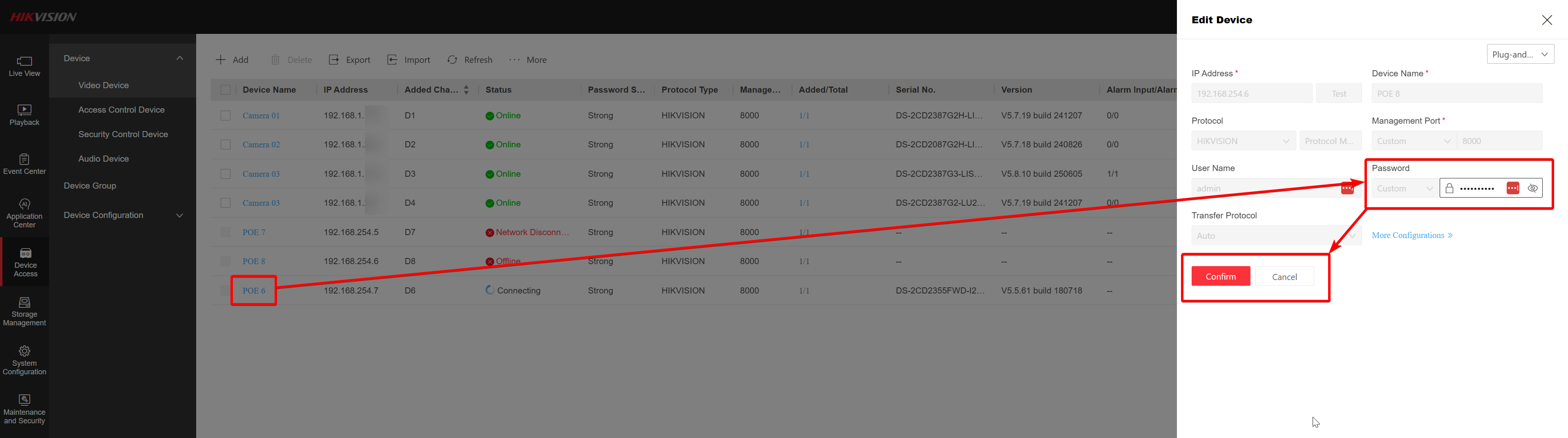

Just to share - we've found that (on both our and a customer's NVR), after upgrading to V5.04.081 build 260112, the NVR seemed to forget the passwords for Plug & Play cameras, which would show either a 'network disconnected' or 'offline' error in the device access menu.
Cameras that were manually added weren't affected.
You just need to click on the device name, and then re-enter the camera password, and they'll reconnect:
