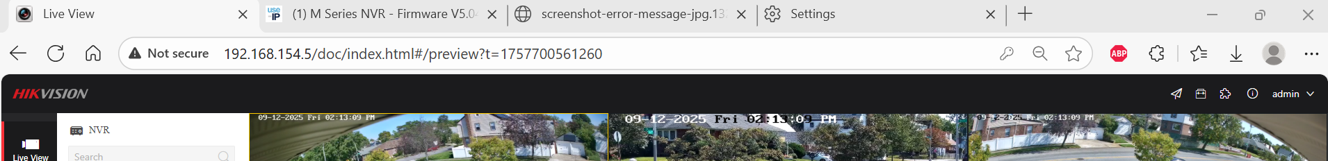

That is strange looking... is it the NVR GUI or a camera GUI that you are accessing there at 192.168.1.102? Something does not look right here:
Can you post a pic of the first page you see after you login to the NVR (or camera) like this:

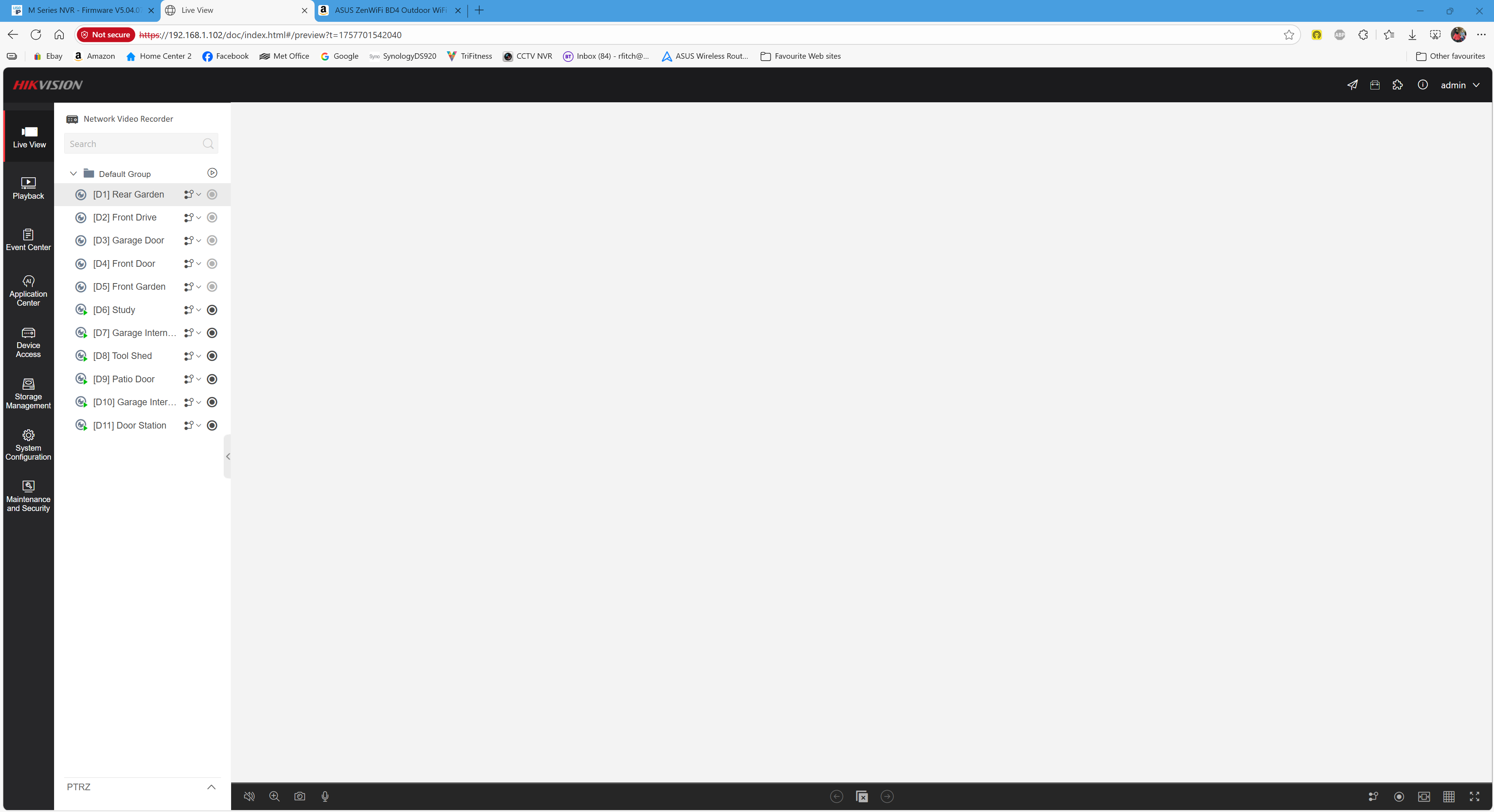

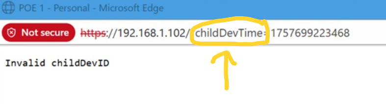

It's the camera GUI I was trying to access

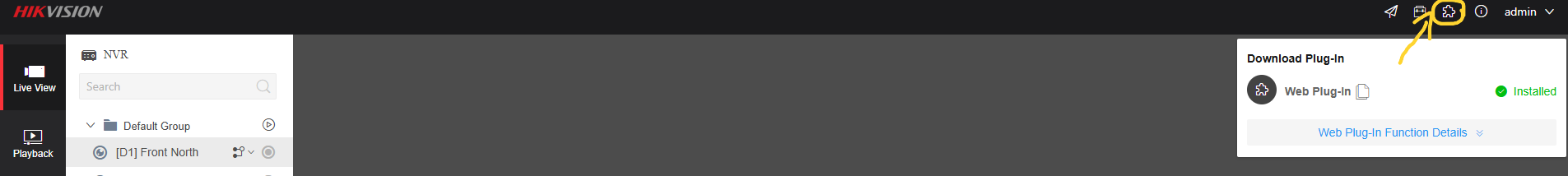

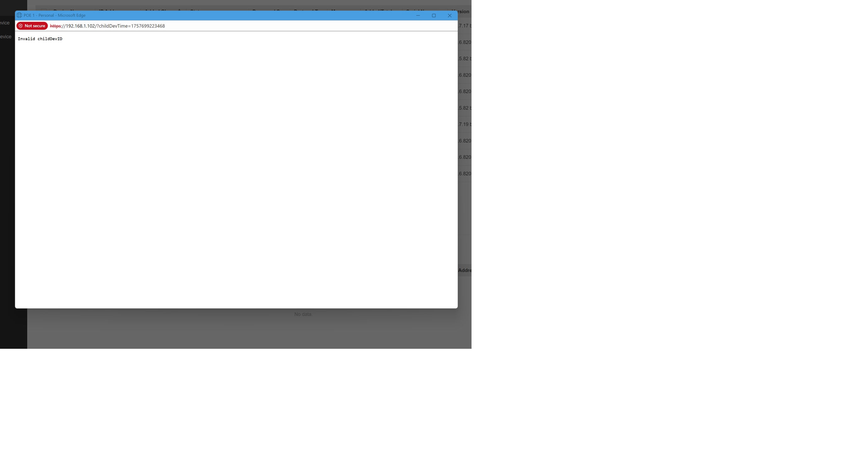

I have reinstalled the plug-in for the' N'th time and I have live view again although I am still getting the "Invalid childDevID" error when I try and access the camera GUI.

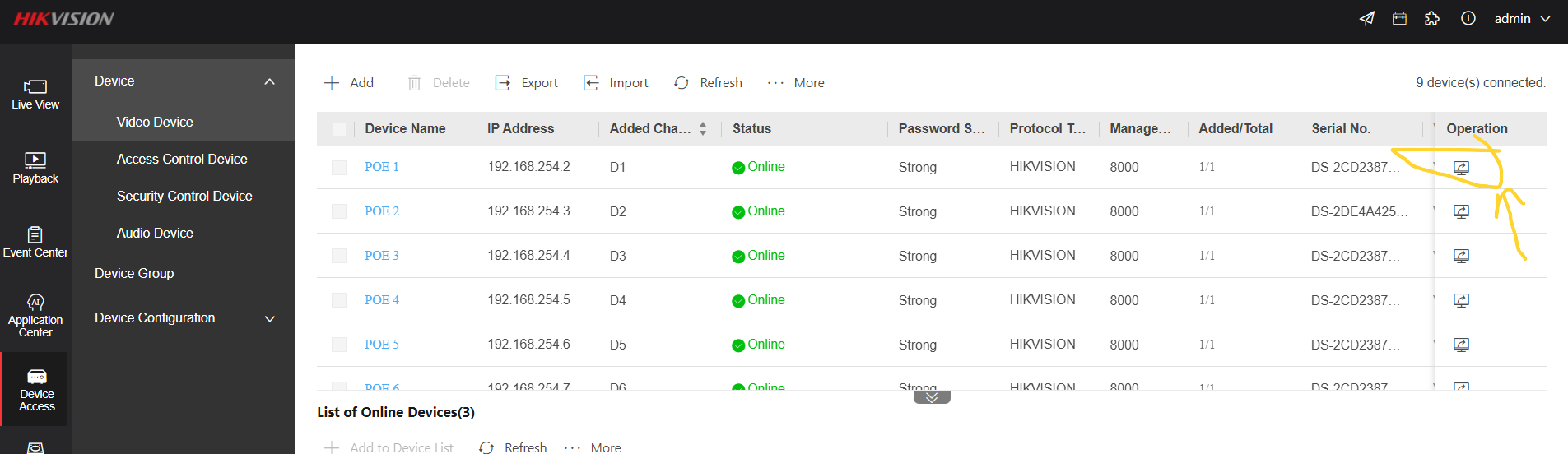

I am trying to reach the camera from the NVR GUI by clicking the right hand side icon on the Device access page. I get a message to activate remote access by clicking OK.
I will put up a screen shot of the relevant pages later today.
This button?

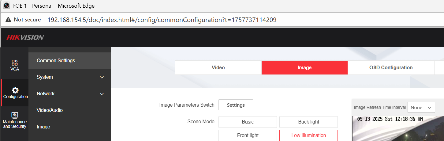

I haven't used that before, but when I do (after enabling device remote configuration under "... More"), I get a new window that only allows camera configuration changes... the live view and playback functions are not there:
What do you get it you use this button, (should be the login page for the camera, and is live view working there when you login)? (You may need to use the scroll bar to move to the right of the list):

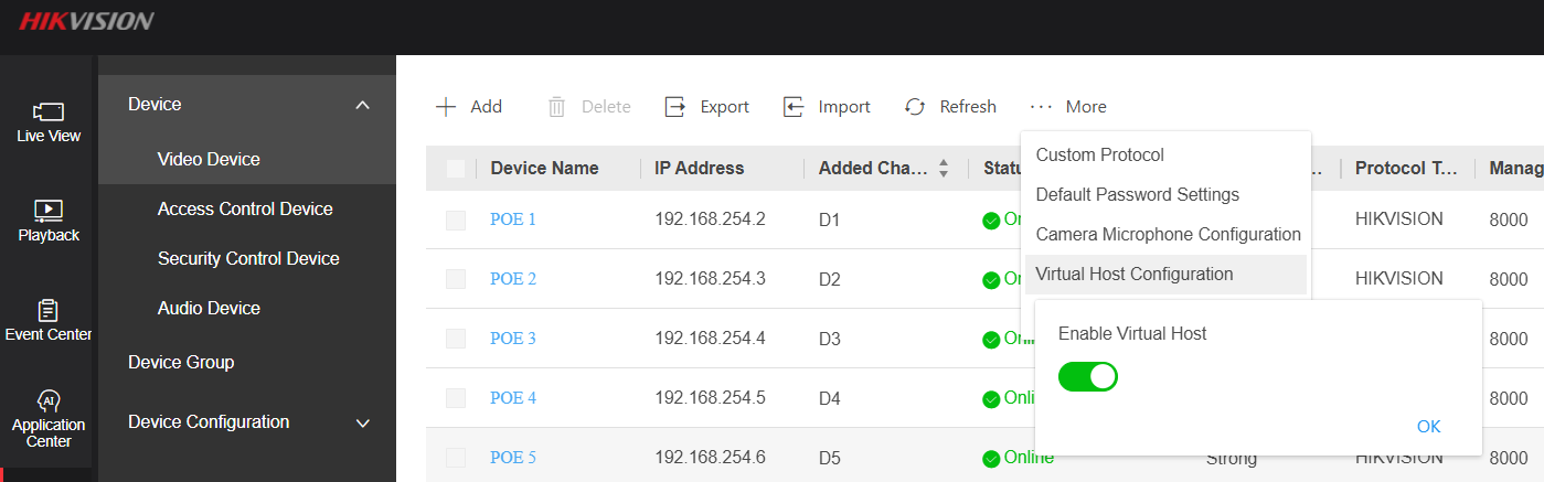

Do you have virtual host enabled?

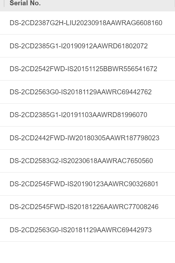

That's the Camera's GUI menu... we probably have different cameras... mine are mostly DS-2387G2-LU... what camera models do you have?

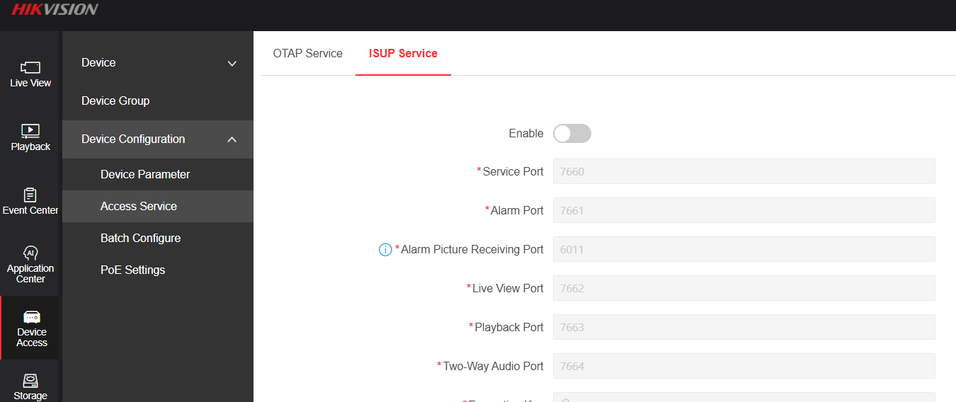

I have solved the problem, I had to enable ISUP service in Device Configuration /Access Service. This then populated all the IP addresses in 'Connect' heading.
I can reach all cameras except 1? it just times out!
Good! What's strange though is that I do not have that enabled:
Is live view on the camera GUIs working for you now?
I have disabled ISUP as you have and I still have the Camera IP addresses showing.

I still get the error message when clicking the icon in Device manager though!
