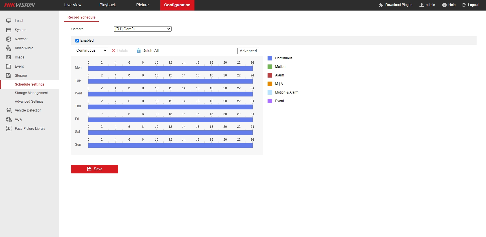

Hi All,
In the web version of the new K-series NVRs it is not possible to record continuously and get markers when a movement or smart event is detected. In case a movement is detected, the blue bar in the playback screen remains blue, no color change and thus no indication of a movement detection. Anybody an idea how to fix this?
Or do the K-series NVR not have this functionality ? (very very bad if this is true)
Hi @rgb
The event markers over the continuous recording timeline have been removed from the browser GUI for quite a long time now, as far as we are aware none of the Hikvision NVRs support this feature in the browser access.
When Hikvision first removed it they claimed it was because of browser stability issues that were impacting playback, if you search the forum for 'event markers' or similar terms you will see many threads discussing this.
