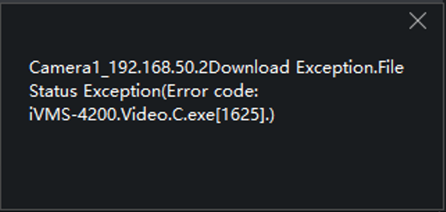

Can you download the footage in iVMS-4200?
Or, right-click on the shortcut IE and select "run as administrator", which should let you download it.
When downloaded, drag and drop the file into VSPlayer.

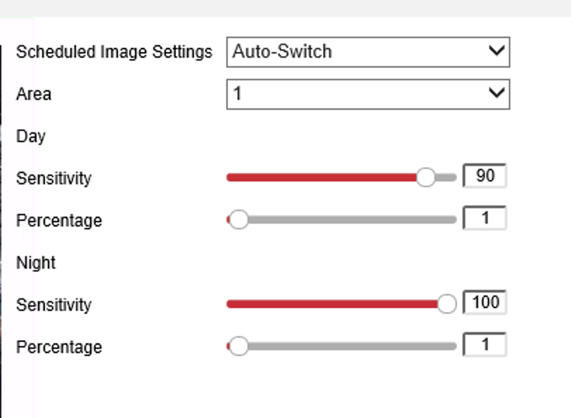

It's tricky to advise on the green squares issue without seeing screenshots of the scene the camera is looking at and all of your event settings I'm afraid.

Attached is a screenshot of the squares and my settings for the biggest zone. I will try the ivms download and let you know how it goes.

I cannot download via IVMS either.
