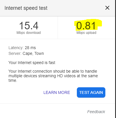

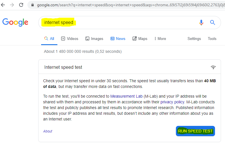

From your tablet or mobile, please check your internet speed. Open Chrome and enter 'internet speed' in the search field. Click 'Run Speed check'
The upload speed is key here. I'm fairly confident your going to be fine here, but it helps to know.

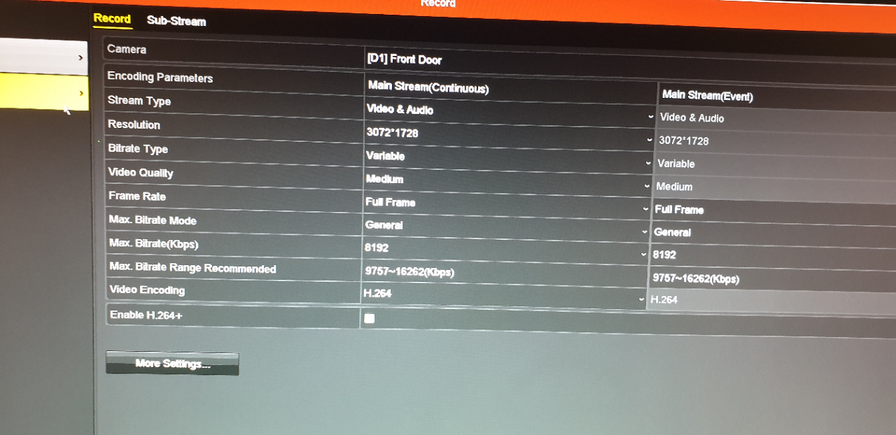

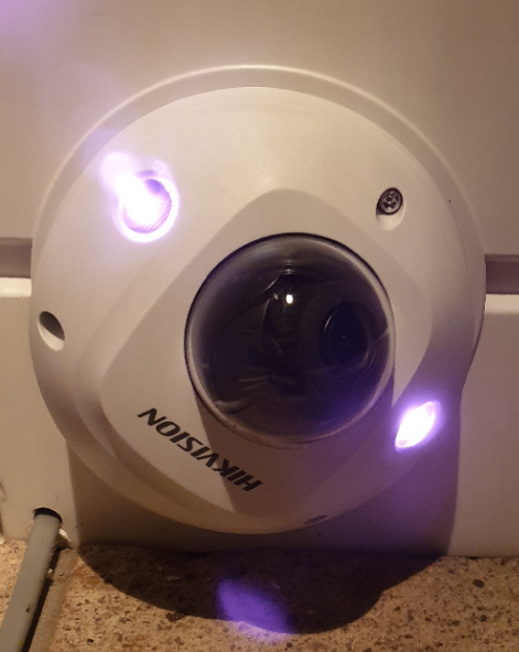

* Cameras: Hikvision 6MP Cameras .. Not sure how to ascertain the model but see pic below.
* Resolution etc.: See pic below

My guess would be bandwidth. At those settings, the cameras might be stressing the upload bandwidth. To test this, lower the frame rate to 12 and the max bitrate to 2048 and see what happens. You can always move up from there. Check the live stream first.

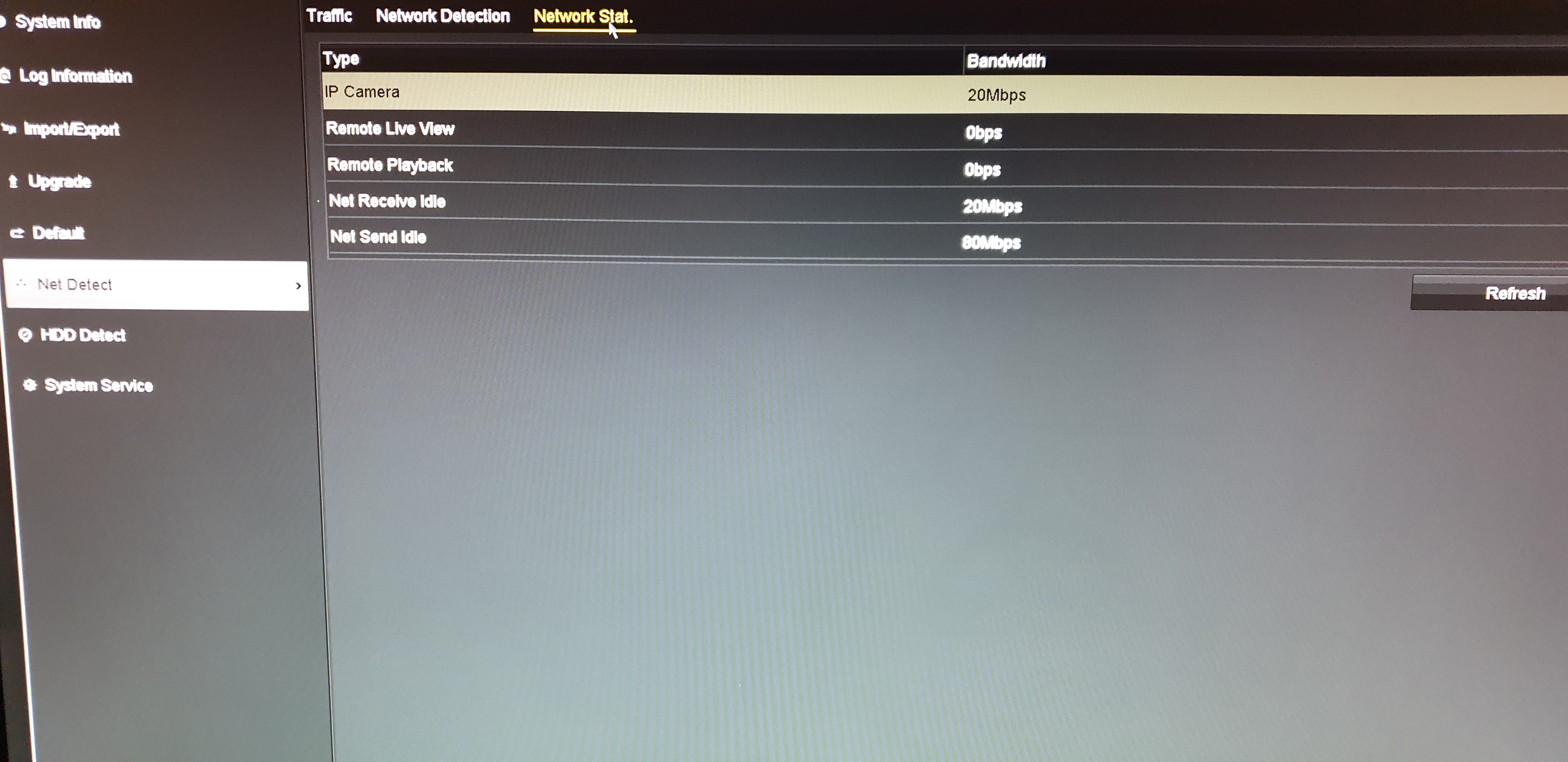

Might be worth checking:
On the NVR, select Menu >Maintenance > Net Detect > Network Stat
Check the usage of the access bandwidth and report back.

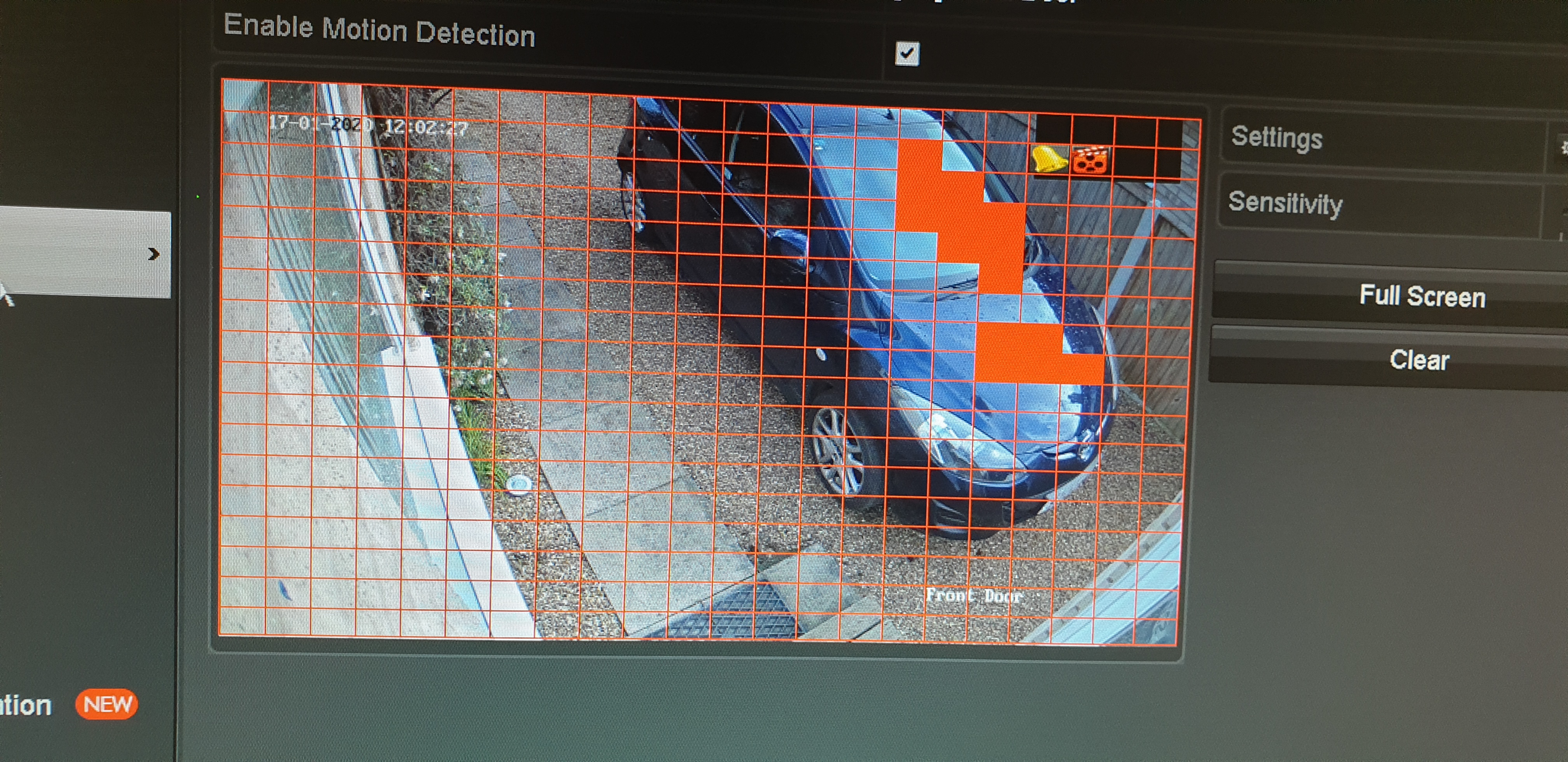

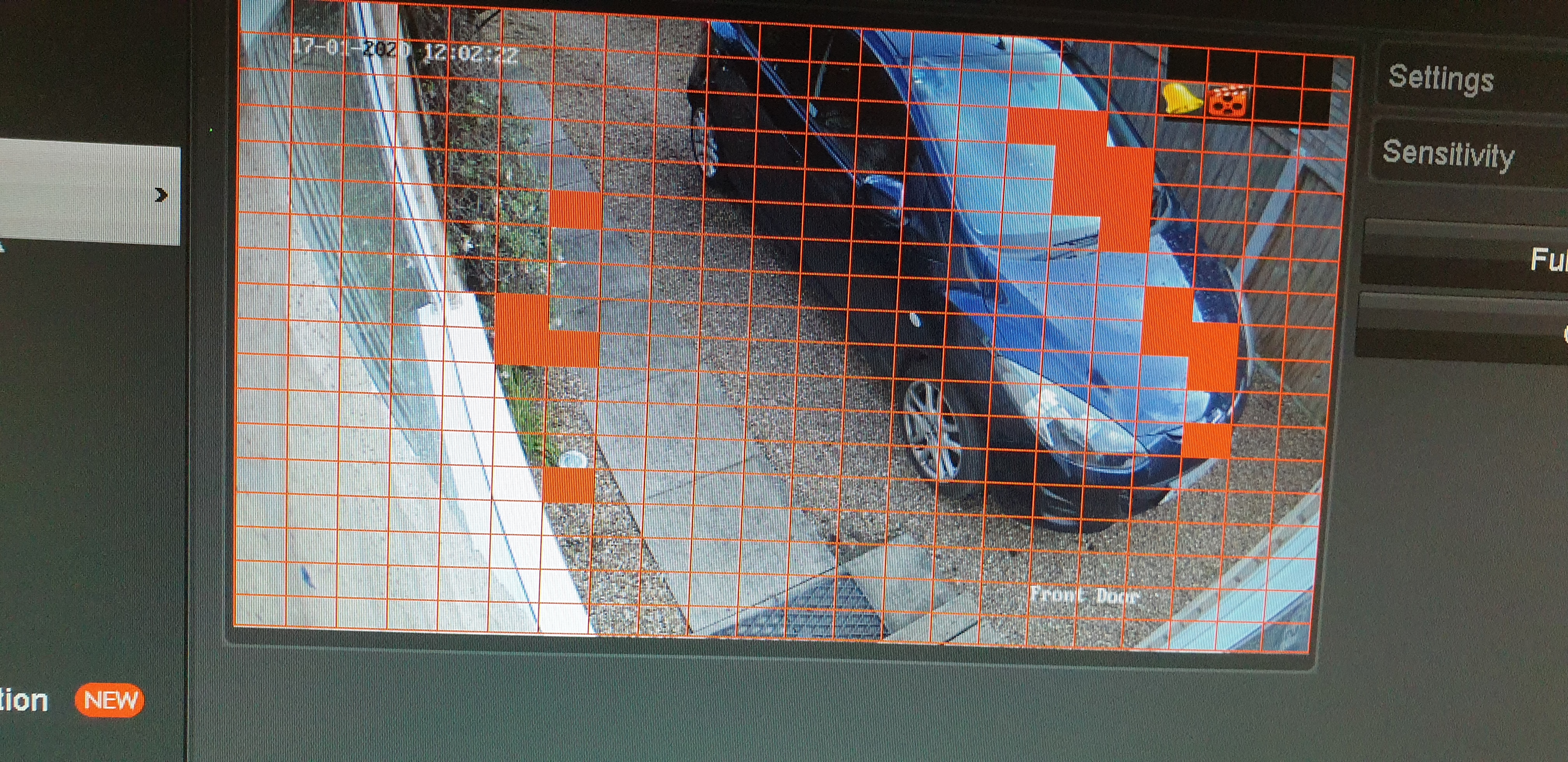

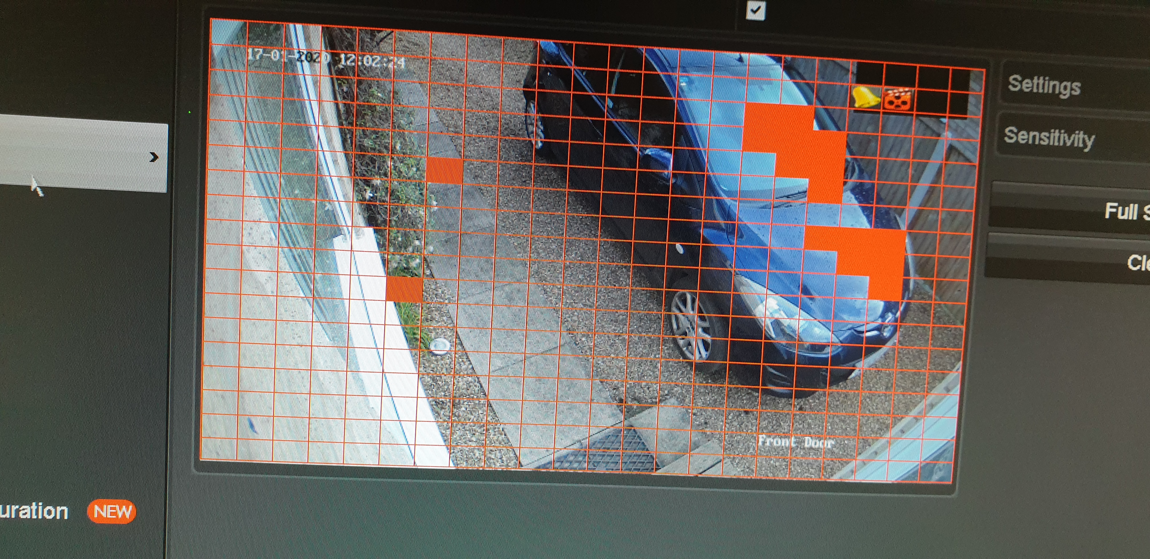

Is this normal? Or should those red blotches not be happening and puckering? This is going into my Camera Motion settings on my main unit.
