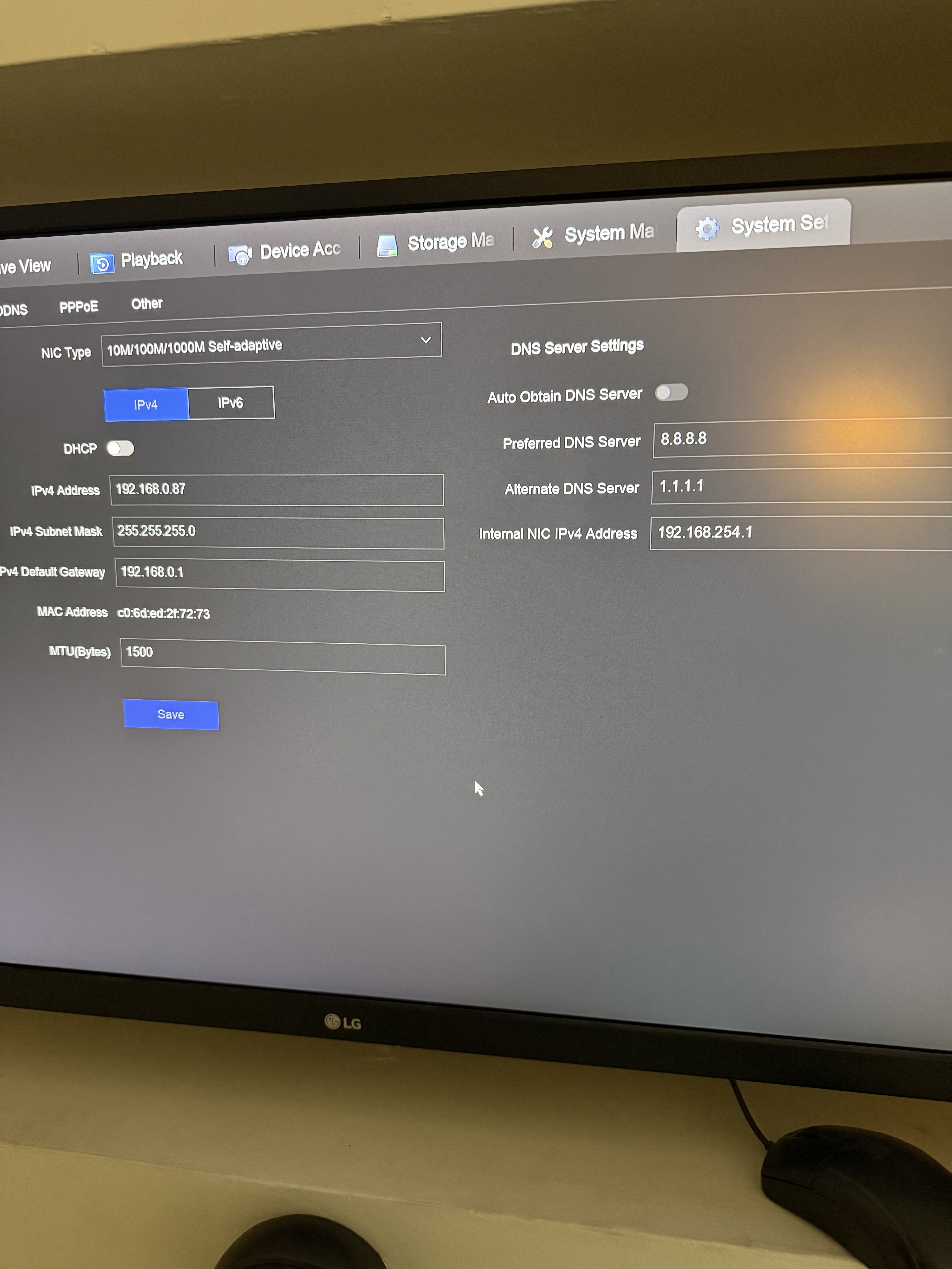

Did everything u said mate that 1 adaptive was on so turned it off. Reset everything even deleted app again still not sorted. Strange init, if helps what we notice if we watch live view on phone we can see postman at the door on live view but on the monitor he is out gate getting in his van lol.

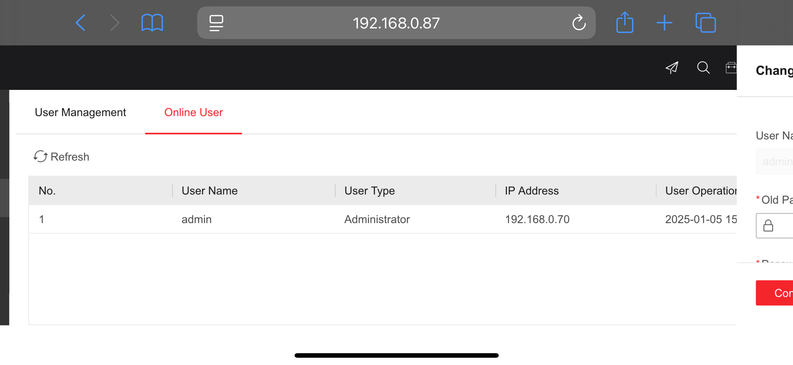

Just noticed on the web portal it shows a different ip address for online

The Ip address shown is simply a device you are or have recently been logged in from using a web browser (rather than the NVR IP address) so forget about that.
In your first photo...go back to that screen and turn ON 'platform time sync'. That will ensure that your NVR time is synchronised with Hik-Connect. Your phone and Hik-Connect app need to be at the same time as the NVR and cameras.

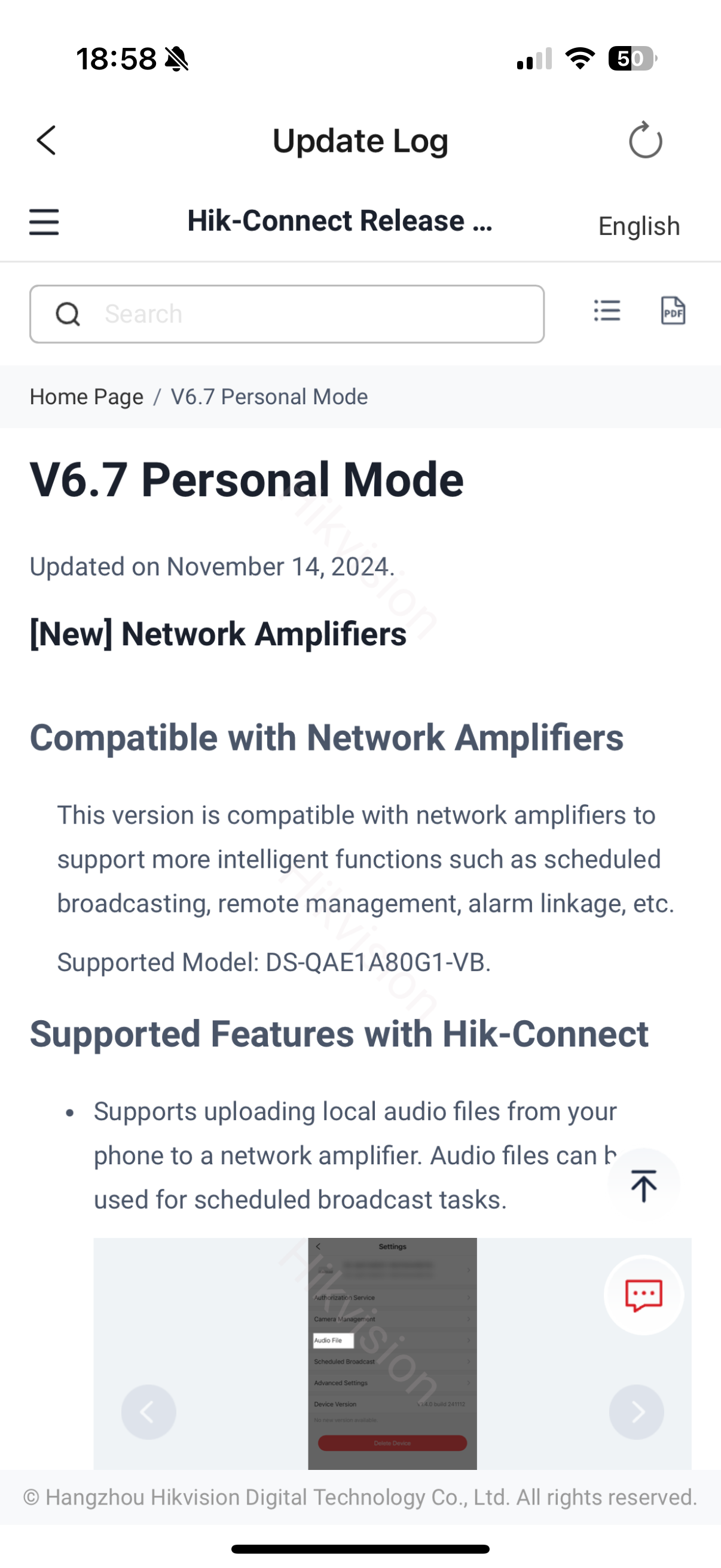

Noticed the hik app was updated around the time this started

The Hik-Connect app is sometimes updated 3 times in 1 week.

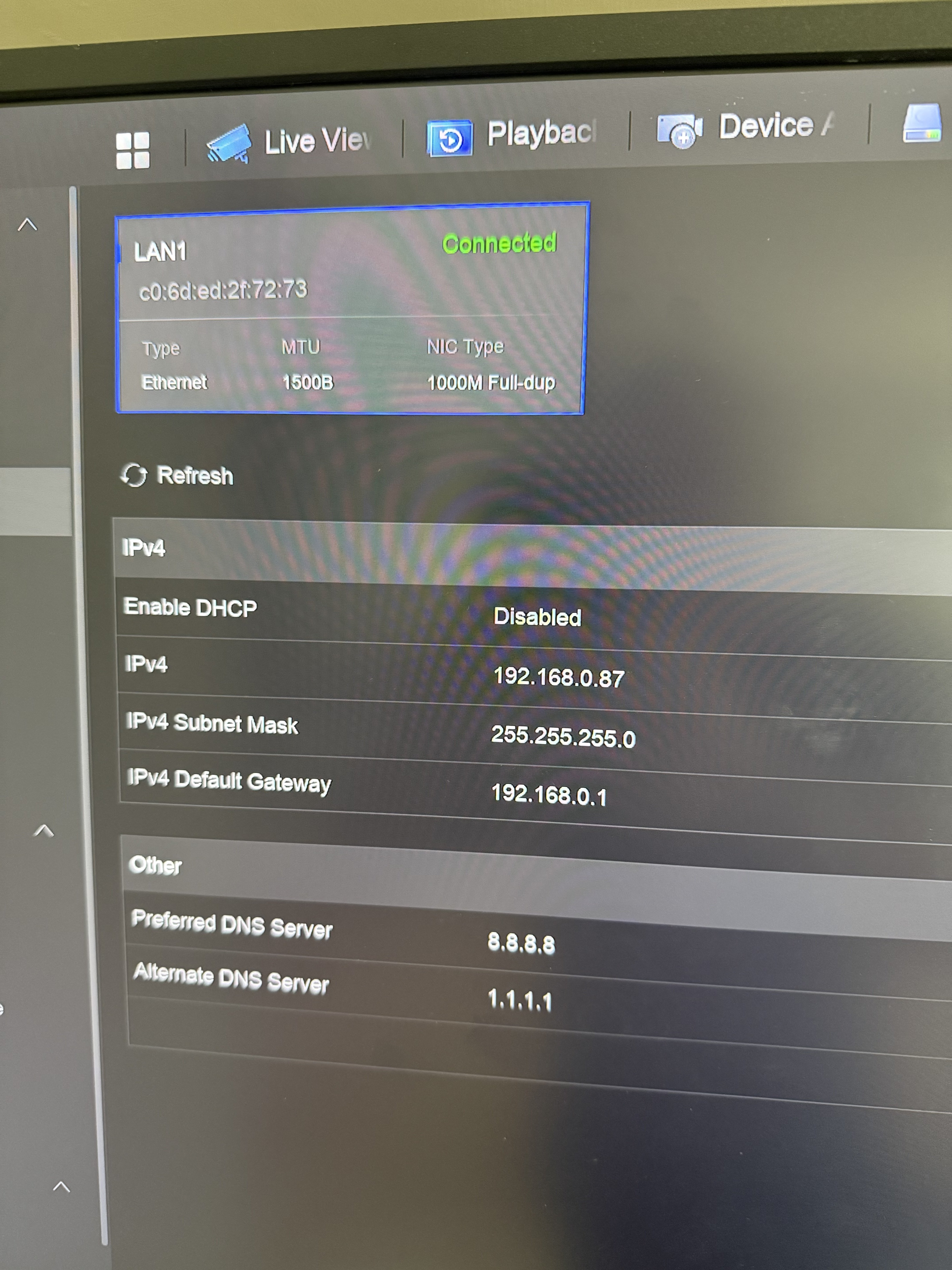

Noticed app ddns isn’t on?

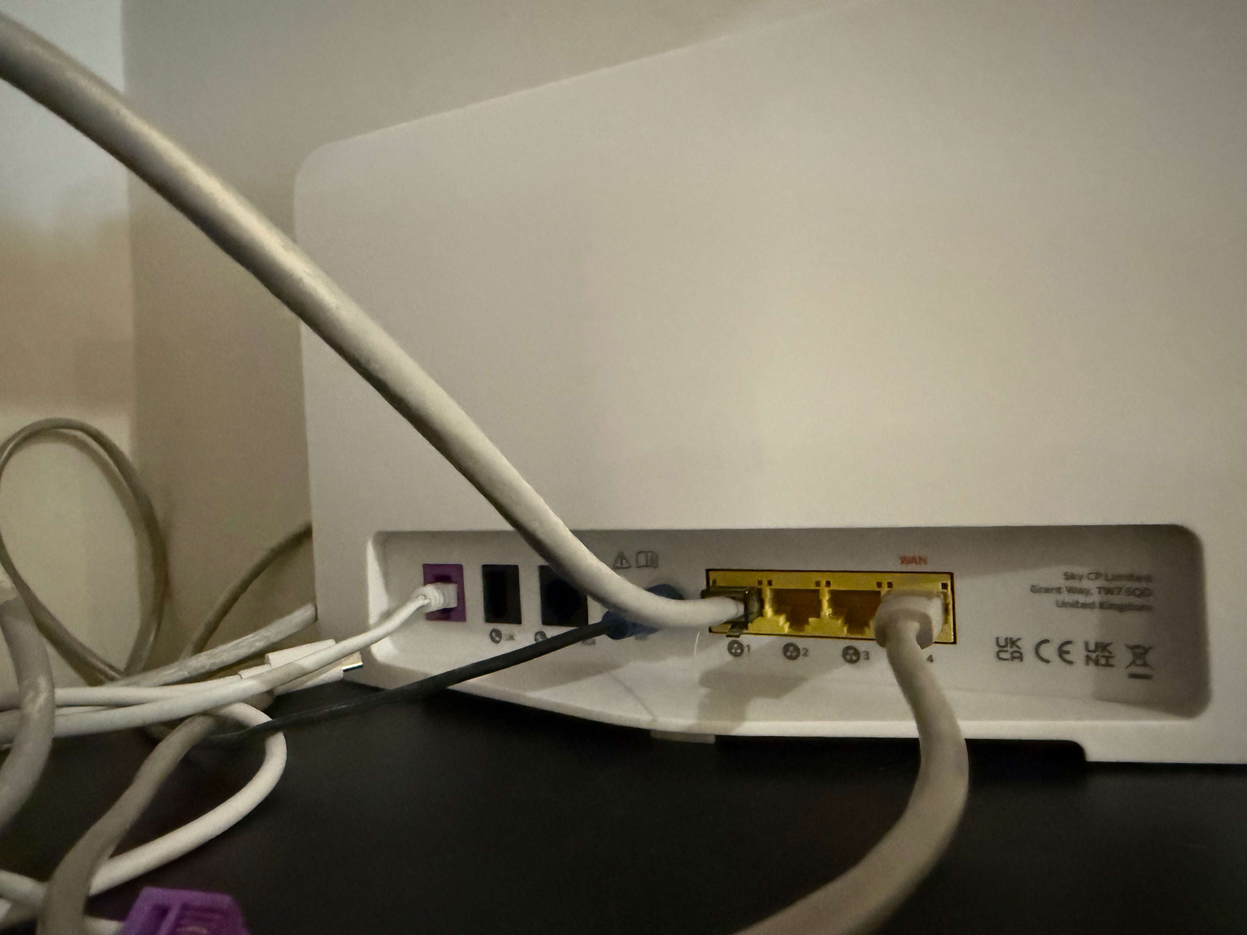

Sorry just 1 last thing. I have a feeling it’s something to do with the hub. As the only 2 things that’s connected via lan is the nvr and my sons ps5. And he said his running slow for ages now! Just looked at the back of the sky hub max and here is no data lights flashing at all. Iam sure there was always lights flashing. it shows is connected and signal and it does work but no data lights

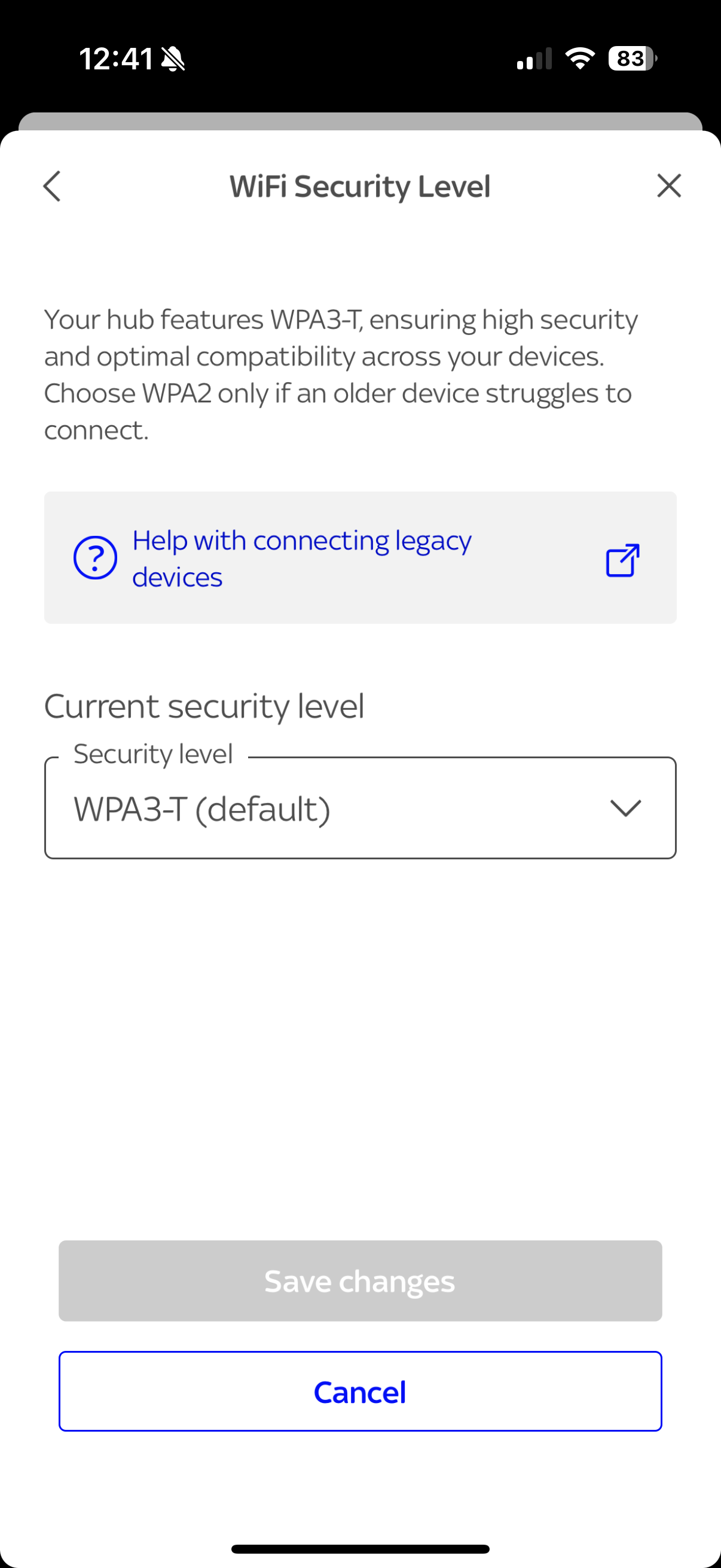

Only setting there is

Cannot understand why WPA3 is the default
