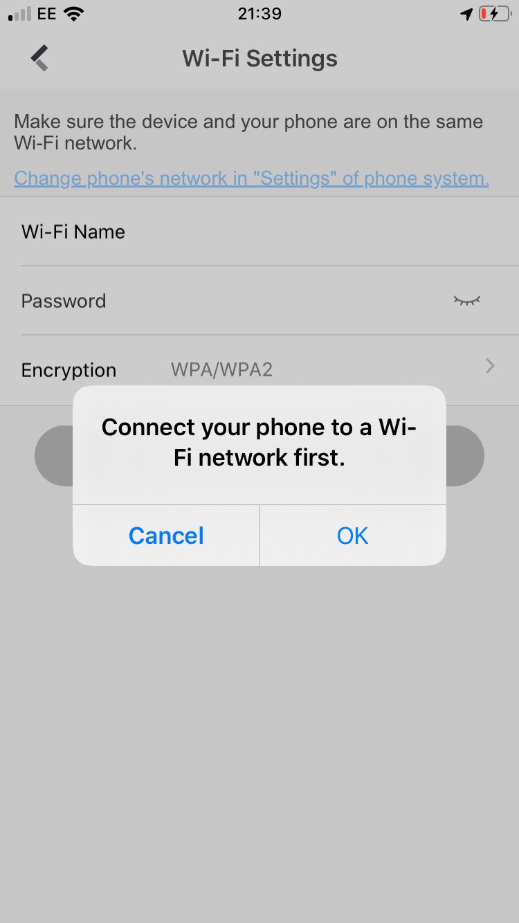

I have just noticed when I go to the app settings and to WiFi, it says you need to connect your phone to a WiFi network first, well I have, but it just sits there in iPhone settings doing nothing.
My WiFi is working fine here, so is my 4g. but only 1 cam shows on my hik connect app, keeps saying network is unstable, connecting again.
This is what I get when I try and go to wifi settings on the app. Even if I click ok, it does nothing. It just goes to my phones settings and sits there until I go back to the app and that question box remains.

Check/try the following:
  • Make sure the cams and NVR are on the latest firmware
  • Re-install the Hik-Connect app
  • Try on a different mobile device, Android if possible
  • Check you internet router allows ports 30K-60K to be opened
  • Some mobile networks restrict port forwarding and may throttle certain traffic, if possible try another provider
  • Disable hardware decoding in the app if you have it on (long shot)
thx, i have reinstalled app, no joy, can't try android but i have tried my iPad and partners iPhone, same result.
