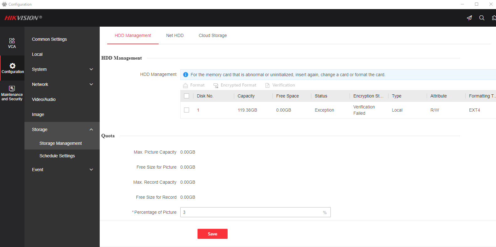

I cannot know if the reason is the below:

My SDcard was encrypted. But I cannot understand the relation to VCA upload on NVR HDDs

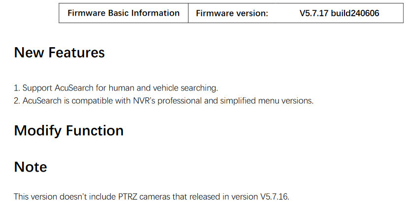

New release notes. A very detailed information from the new author!!!!

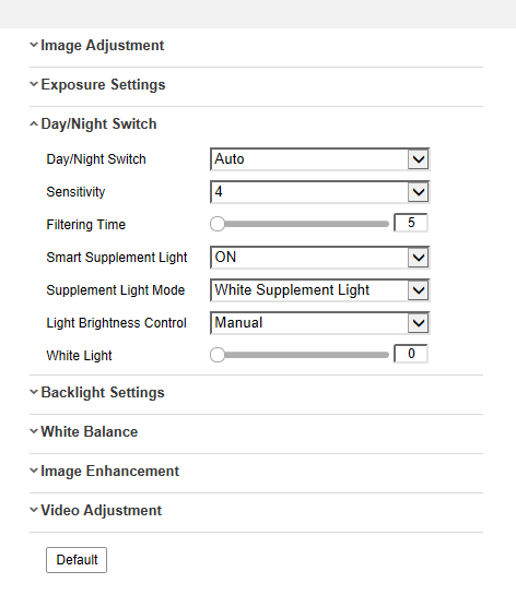

Below is my configuration, if that helps:

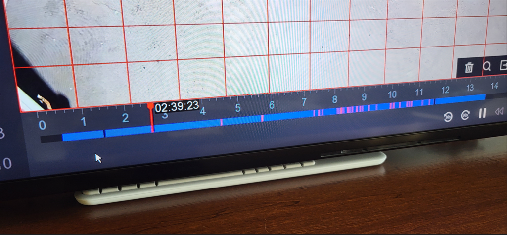

On NXI-K NVRs there is no selection(no icon buttons) for Human and Vehicle when on NVR GUI I select Playback-Event-select(double click camera)-click Space Rule-perform either Draw Motion, Draw Intrusion or Draw Line Crossing. So this is impossible to deselect(uncheck)!!! (see the mouse cursor area on picture and the timeline after the 11:30 gap).
Those two buttons(Human and Vehicle) exist only in Playback-Normal-check the camera you want to search, but only for two things. Intrusion and Line crossing(possibly Intrusion includes Region Entrance and Exiting).
So the Playback-Event for Normal(Motion) search by Rules is impossible.
I reinstalled 5.7.17 to check again. Same problem, but what I noticed is that by the time 5.7.17 is installed the Normal(Motion) Events are recorded but they cannot be found. This was possible to understand when reinstalled 5.7.15, performed the Rule Playback search and by surprise, all Motion Events that where recorded when on 5.7.17, could be found.
