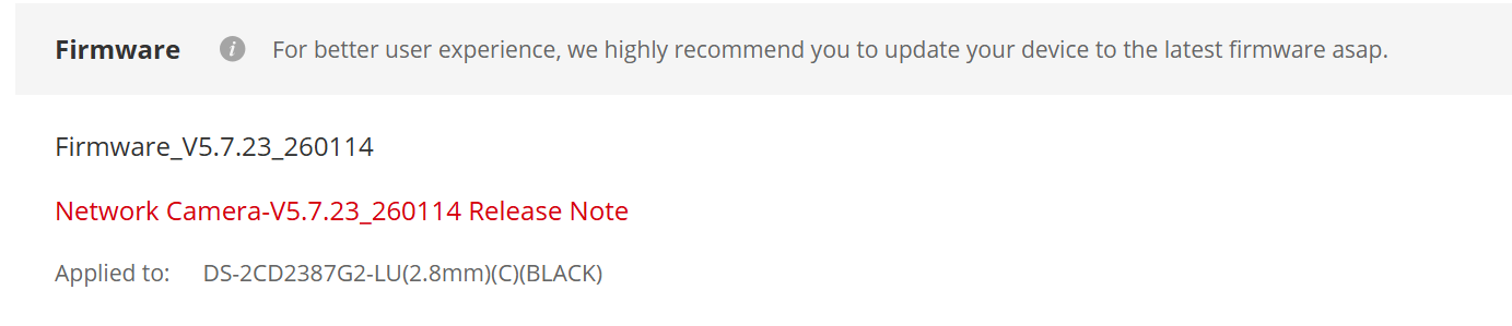

Hi @Tomasz
What model is this firmware for?
Can you share a link to where you've found this firmware?
Wow... didn't think we would see new firmware for these models...
Since @Tomasz pointed it out I see it here...
DS-2CD2387G2-L(U)
As mentioned, the release notes don't mention what they've changed or improved... just 55 pages of model numbers :)
