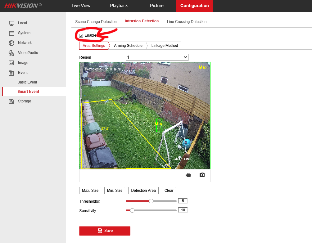

Sorry, I am outside home and I cannot take a screen capture.
I have a DS-2CD2T86G2-4I connected over the network. And I am using Synology Surveillance Station as the NVR for the recordings. But I also have a Samsung Pro Endurance SD Card 128GB in the camera.
For Hick-Connect I am using iOS with te latest 17.1.1 OS and app version 6.0.156 (the latest app version). And another iPhone with iOS 16 and also the latest Hick-Connect app version.
When I say it is disabled ... I mean the check to "enable" intrusion detection at the Camera UI. As I am outside ... I am going to use a capture I found at the forum. I can upload a new picture this afternoon when I arrive home.
Unusual. I'd start by toggling the setting - Enable it, click Save, Disable it, click Save.
You're right. It seems checking and saving. Unchecking and saving. And then ... restarting the camera using the restarting button. And now seems that when it is not enabled the Intrusion detection ... the Hick-Connect app is not sending push notifications due to intrussion detection. So now it looks it is working ok. Let's see during the following days.
