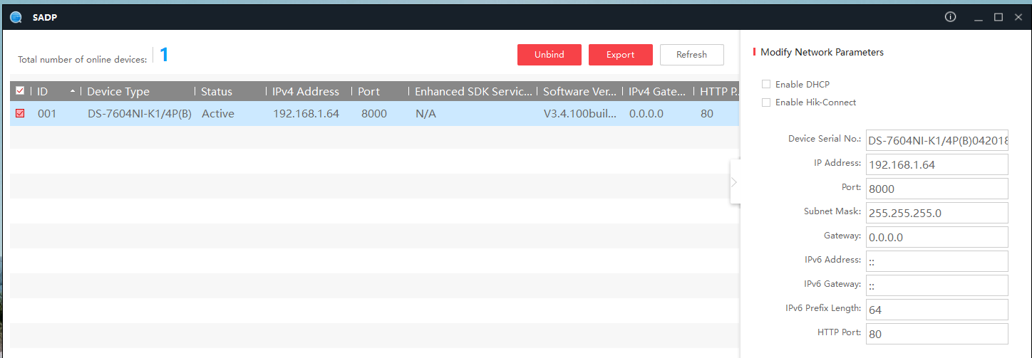

Thank you for your reply. Regarding “the IP cameras connected will initially retain whatever their existing admin password is”. When I use SADP tool I only see the NVR listed (see attachment). Would this indicate that both NVR and IP cameras are presently using the same password
And should I use the Restore to inactive is it difficult to set the IP cameras with the same admin password.
The NVR hosts a separate network for the cameras connected to the PoE ports on the back of the NVR and they will have addresses starting 192.168.254.??? They're not visible using SADP behind the NVR. They will almost certainly be using the same password currently.
Best case scenario - the NVR will overwrite the existing camera admin passwords with the new one OR the NVR will continue to connect to the cameras with the old admin password.
Worst case scenario - the NVR will fail to connect to the cameras as the cameras consider the new admin password to be incorrect. Without knowing the password they may also need to be reset.
