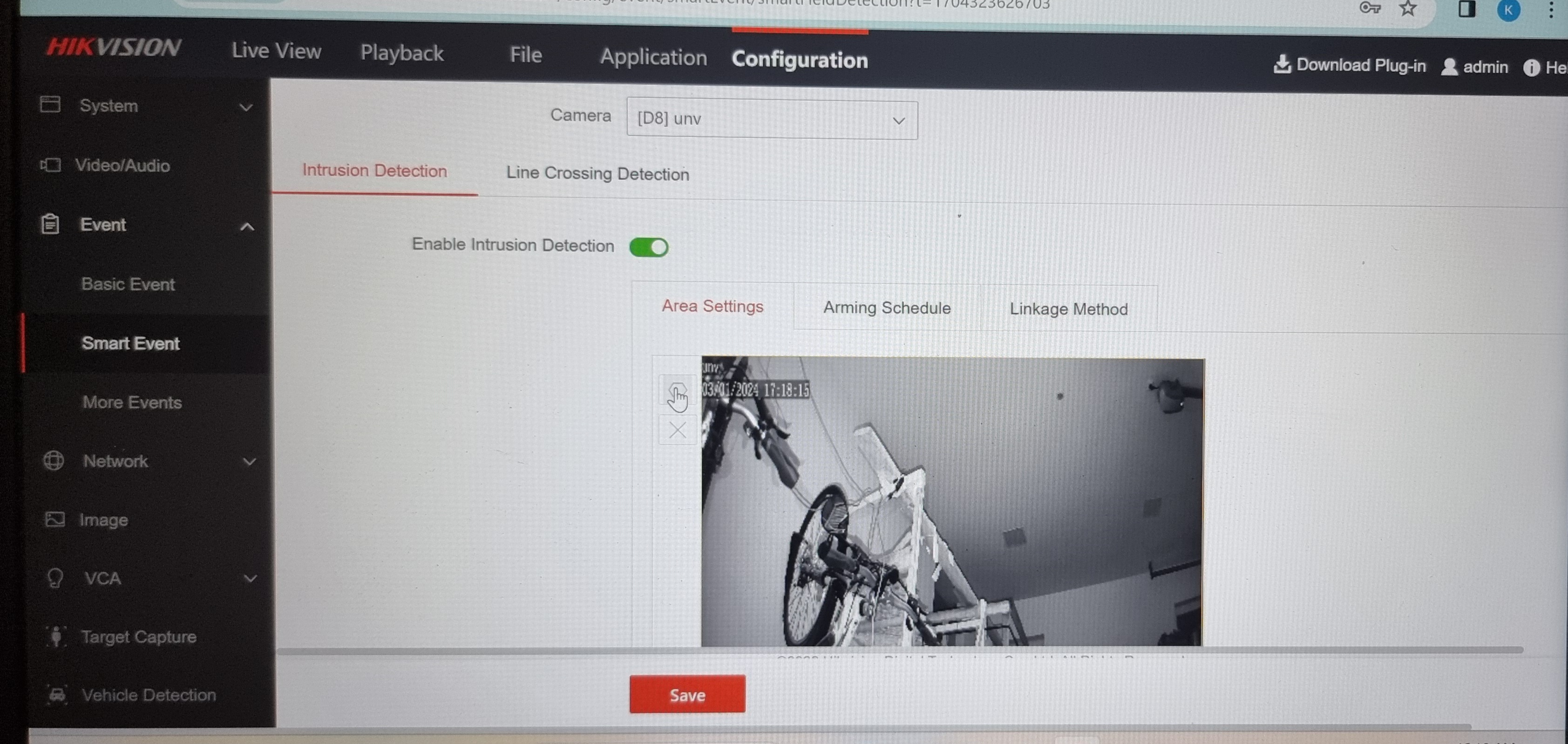

Hello,
I kindly ask for your help.
-NVR: DS-7616NI-I2
Firmware Version: V4.61.010 build 220527
-Camera:UNIVIEW IPC3615LE-ADF28K-G
Compatible Integration ONVIF (Profile S, Profile G, Profile T), API, SDK
In the Hikvision NVR the Uniview camera is added via ONVIF protocol.
In the Hikvision menu in the Basic Events the camera is working, but in the Smart Events it does not work.
The camera supports the intrusion detection and the line crossing detection, the menu opens up, but it is not active - please see the attached printscreen. Can you advice why is it like that?
Thank you very much in advance.
I suspect that the NVR needs metadata from the camera (that it is not getting via ONVIF) for smart events to work.
