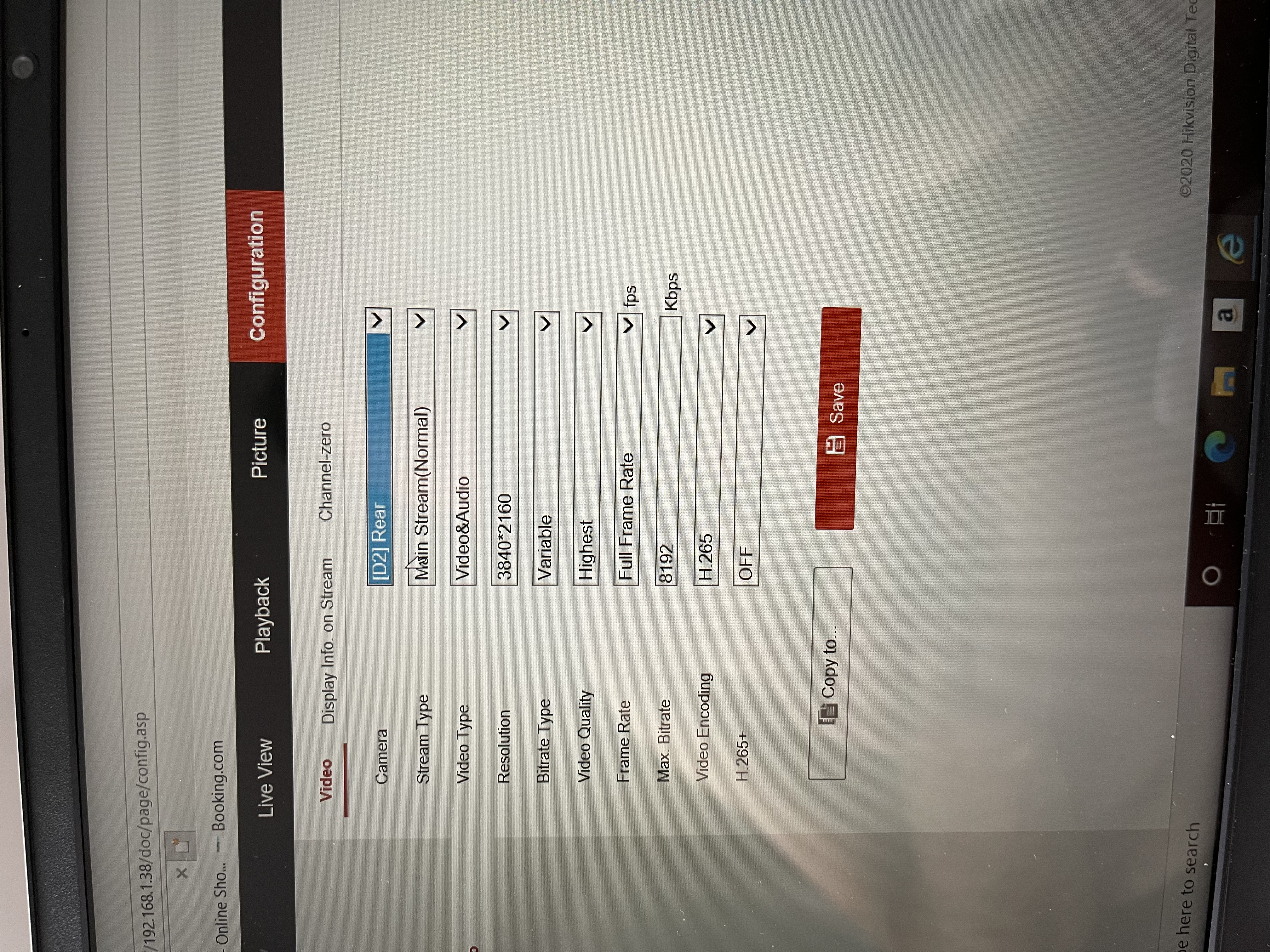

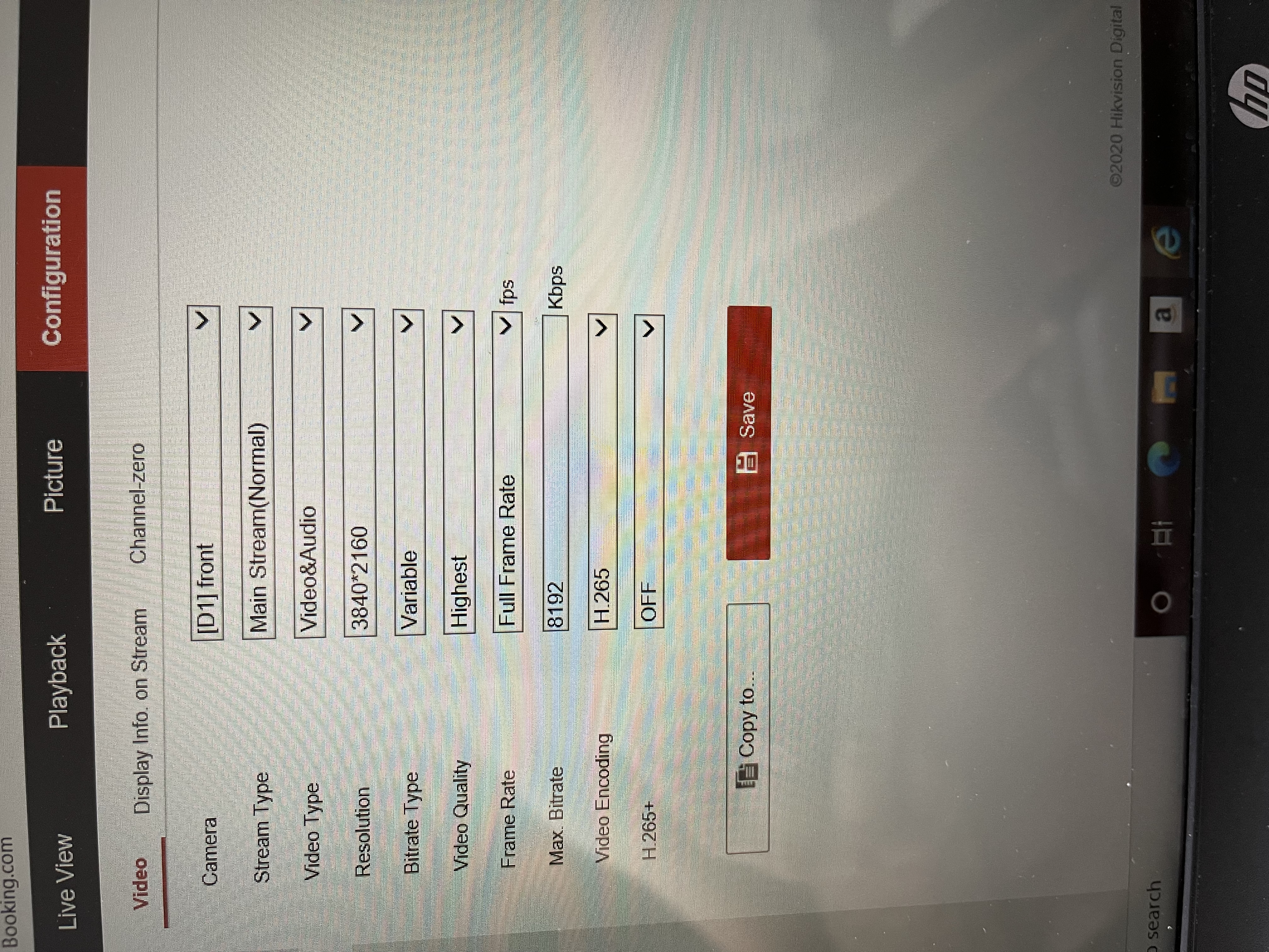

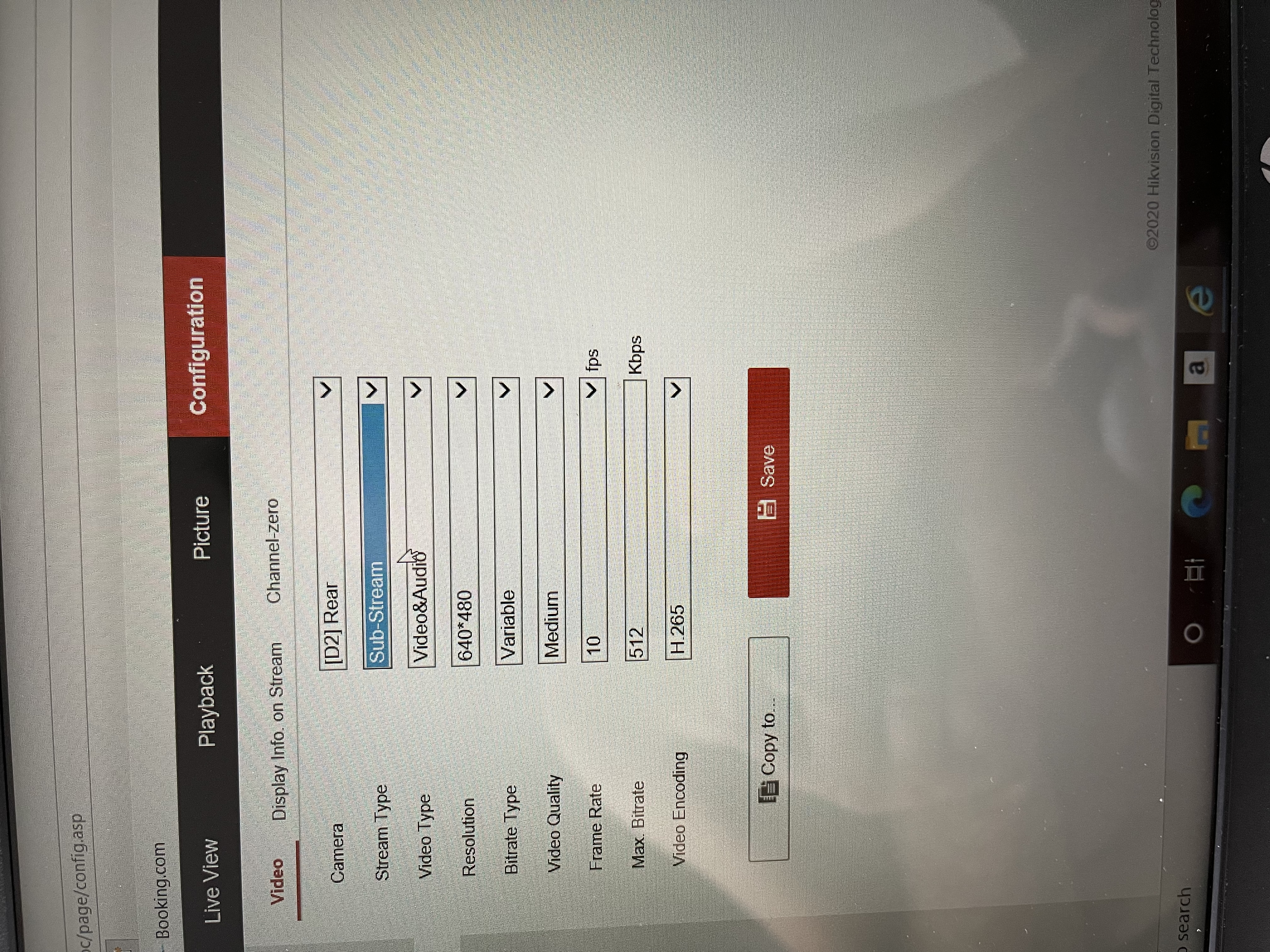

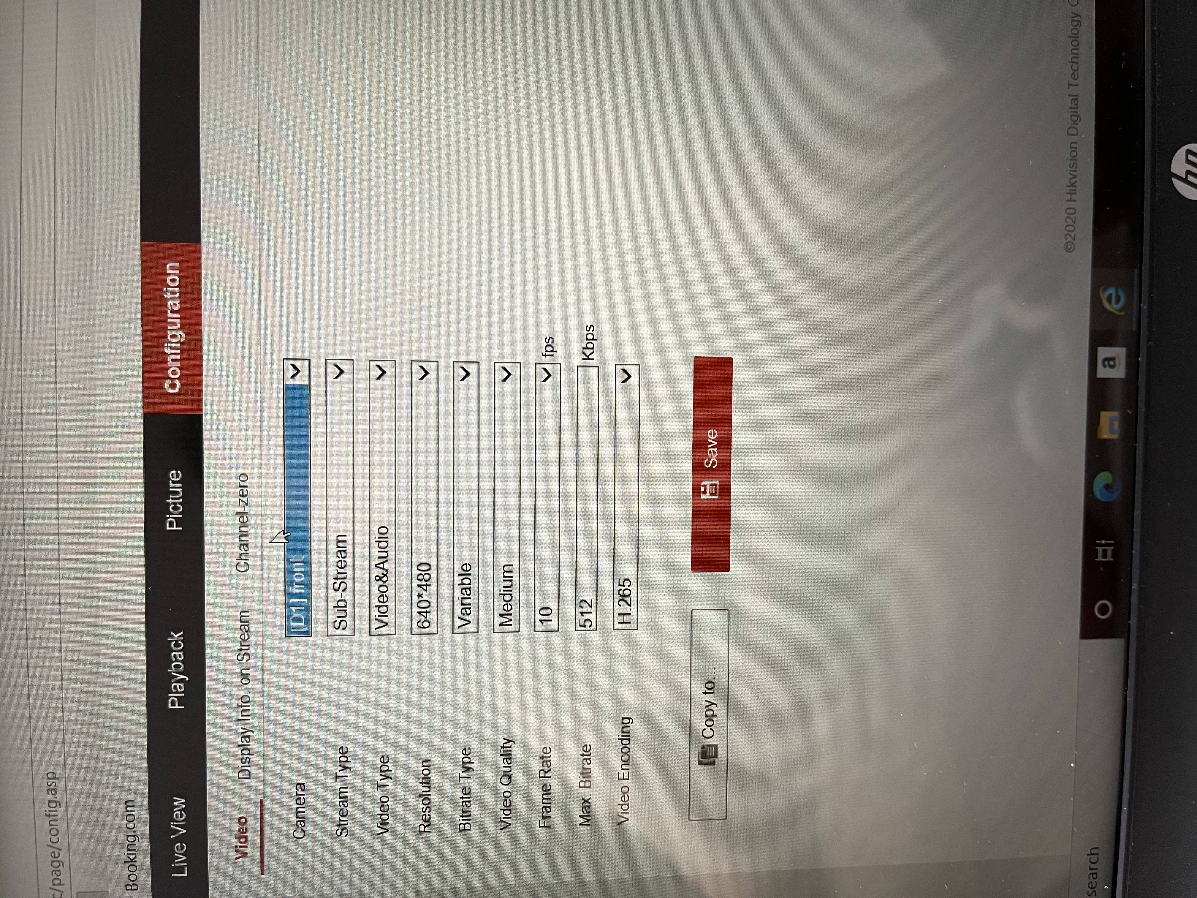

Hi, many thanks for the reply.
I have now changed the settings to the below pictures, and seems ok . I want to add two more 8mp cameras on the system, will it cope ok?

The 7604 NVR definitely will not be able to manage 4 x 8MP AcuSense cameras without you reducing the resolution, frame rate, and setting them all to H.265+
I'm surprised you are getting stable performance from 2 x 8MP cameras that are on H.265, max. resolution, and max. frame rate. We would definitely recommend reducing the frame rate to 15fps because unless you are dealing with very fast-moving vehicles you are not going to notice a massive difference in performance between 25fps and 15fps, but it will save quite a chunk of bandwidth.
Ok cool, so will drop to 15fps, shall I turn on H265+ and alter the resolution? Any help welcome
Hi @L Bishop
Yes, you would need to reduce all of the above settings to get 4 x 8MP cameras to work, but reducing the resolution would make buy 8MP cameras pointless as you would be reducing the resolution to 6MP or lower.
If you want to record 4 x 8MP AcuSense cameras at full settings you would need to use a DS-7608NI-I2/8P 8-channel NVR which supports more incoming bandwidth.
