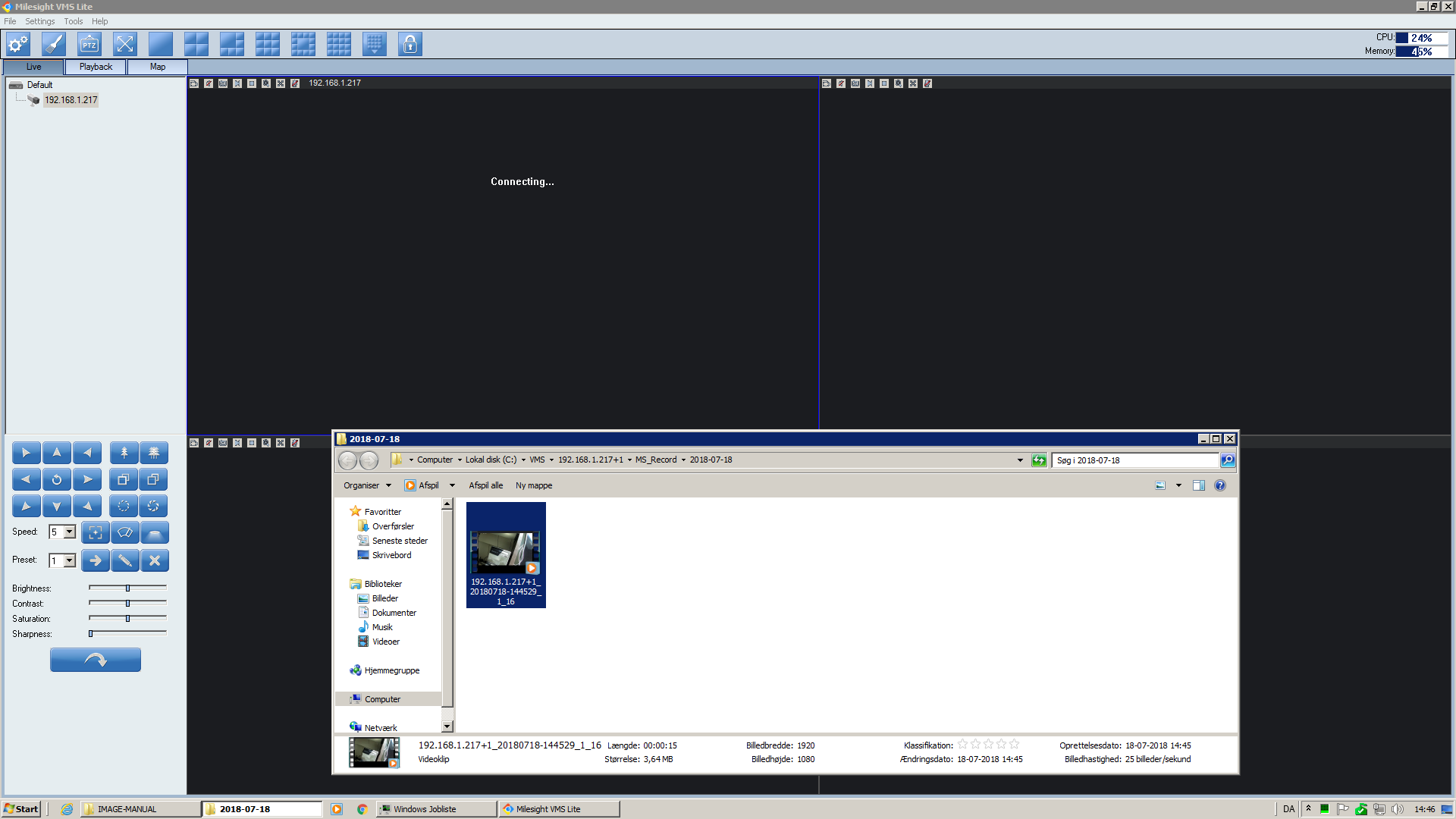

Hey all.
I'm brand new and hope this is the right place to post my question..
I try to connect my "onvif" ip cam to VMS Lite, but on the screen picture it's say " connecting ... " / no images, but recording working..
i hope you understand.. screenshot is attach

Some cameras may need a separate user role for ONVIF use:
ONVIF Issues & Solution with new firmware
Hello.
I got the very same issue. I fixed it downloading an upgraded driver for video card. Computer was using some kind of generic Microsoft driver.
