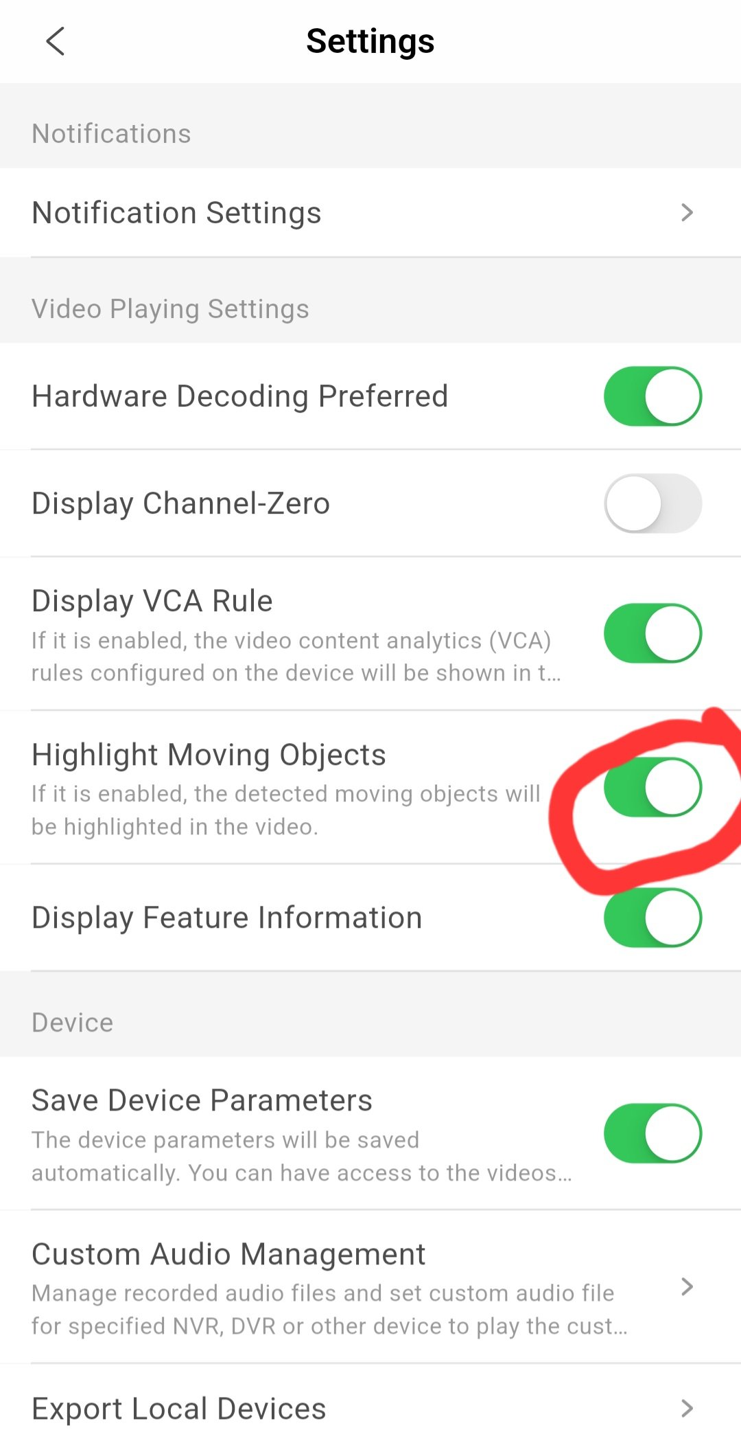

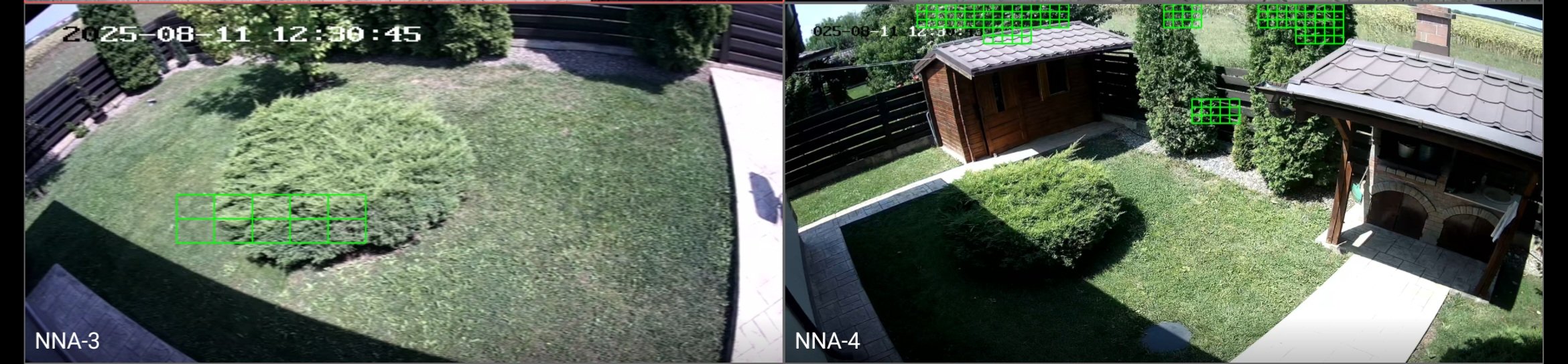

I have a question:
After I activated HIGHLIGHT MOVING OBJECTS in Hik-Connect application, I was surprised to see a difference in live view of my 4MP identical cameras. The left camera is showing bigger green squares, and the right camera is showing smaller squares.
Is this normal or abnormal? Is the the effect of some camera configuration I did different?

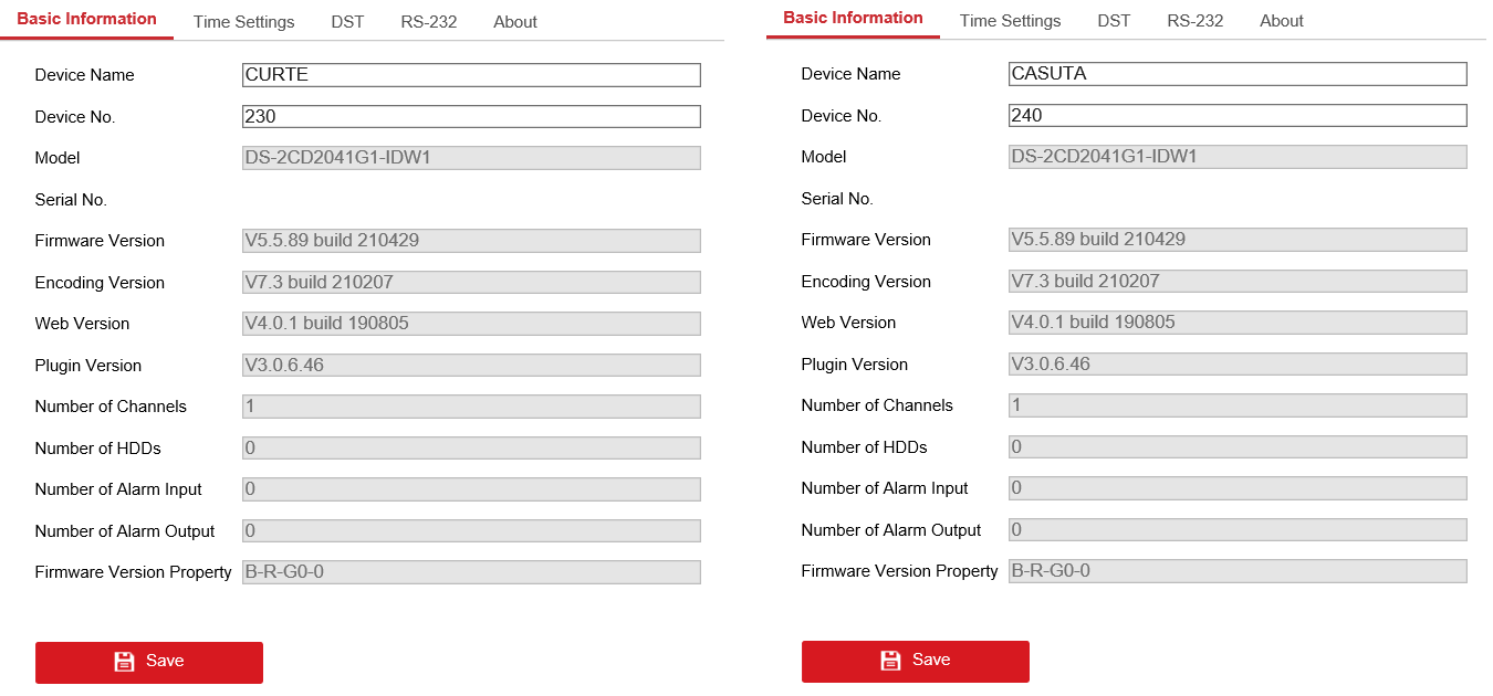

Hi @apashi
If both cameras are the same model, I would not expect the images they capture of the same scene to look so different.
Can you please confirm the model number of both of these cameras?
Can you share screenshots of the video/stream settings for both cameras?
Attached requested info.
So the cameras are identical and Video Config is very similar.
Only difference I see is the Max Bitrate. I have to add that both cameras are connected via WIFI only.
Can this be the cause of different square sizes?
I did configured them identical (as the one with small squares), but there was no change. :(

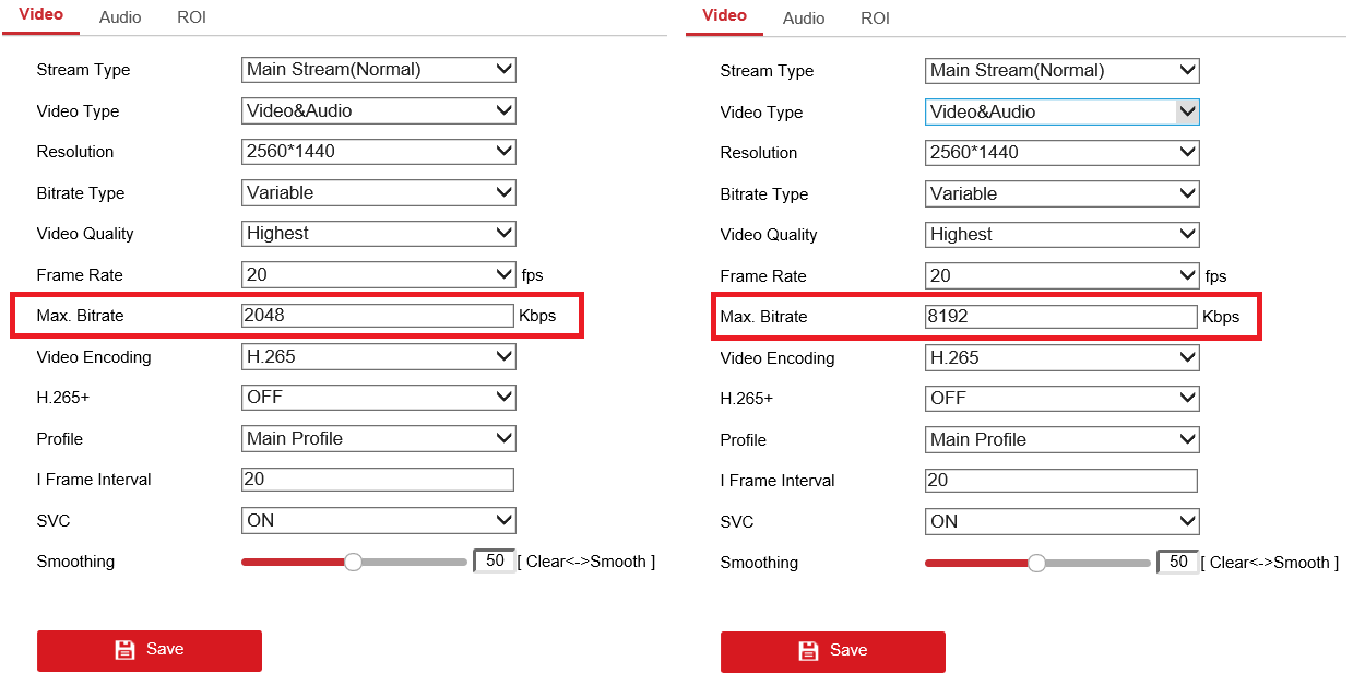

Hi @apashi
Have you increased the max. bitrate from 2048 to 8192 so that both cameras are configured the same?
After doing this, are the images still significantly different?
Hi @apashi
I did exactly that and no difference in Hik-Connect.
I also checked the Motion Config and Image Config, all of them are the same for both cameras.
SOLVED: if you change the Camera Web Interface -> Video/Audio -> Sub-Stream -> Max Bit Rate to highest allowed value, after restart, the square size in Hik-Connect, will become smaller. I tried it even on 2MP camera and work perfect.
