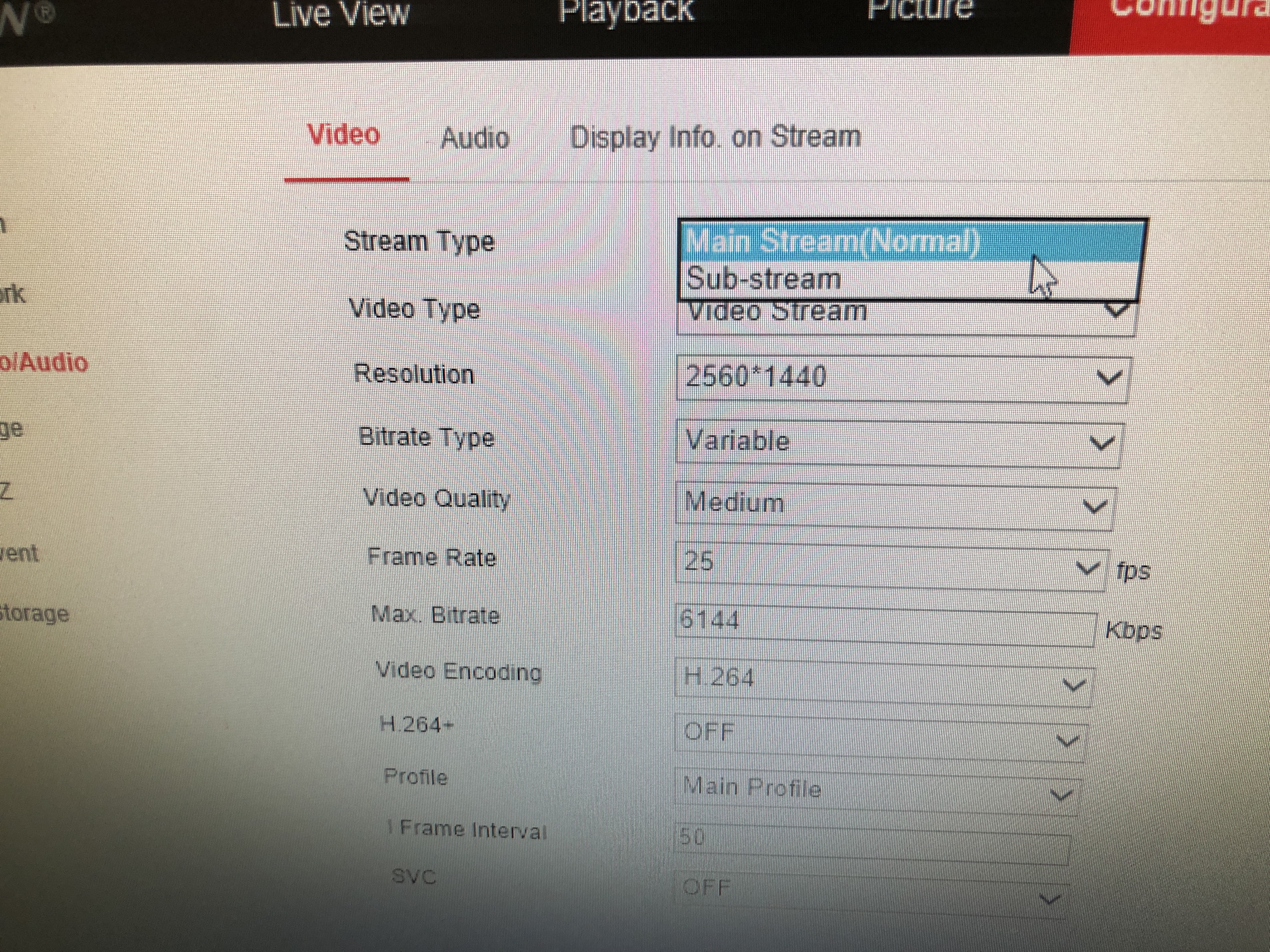

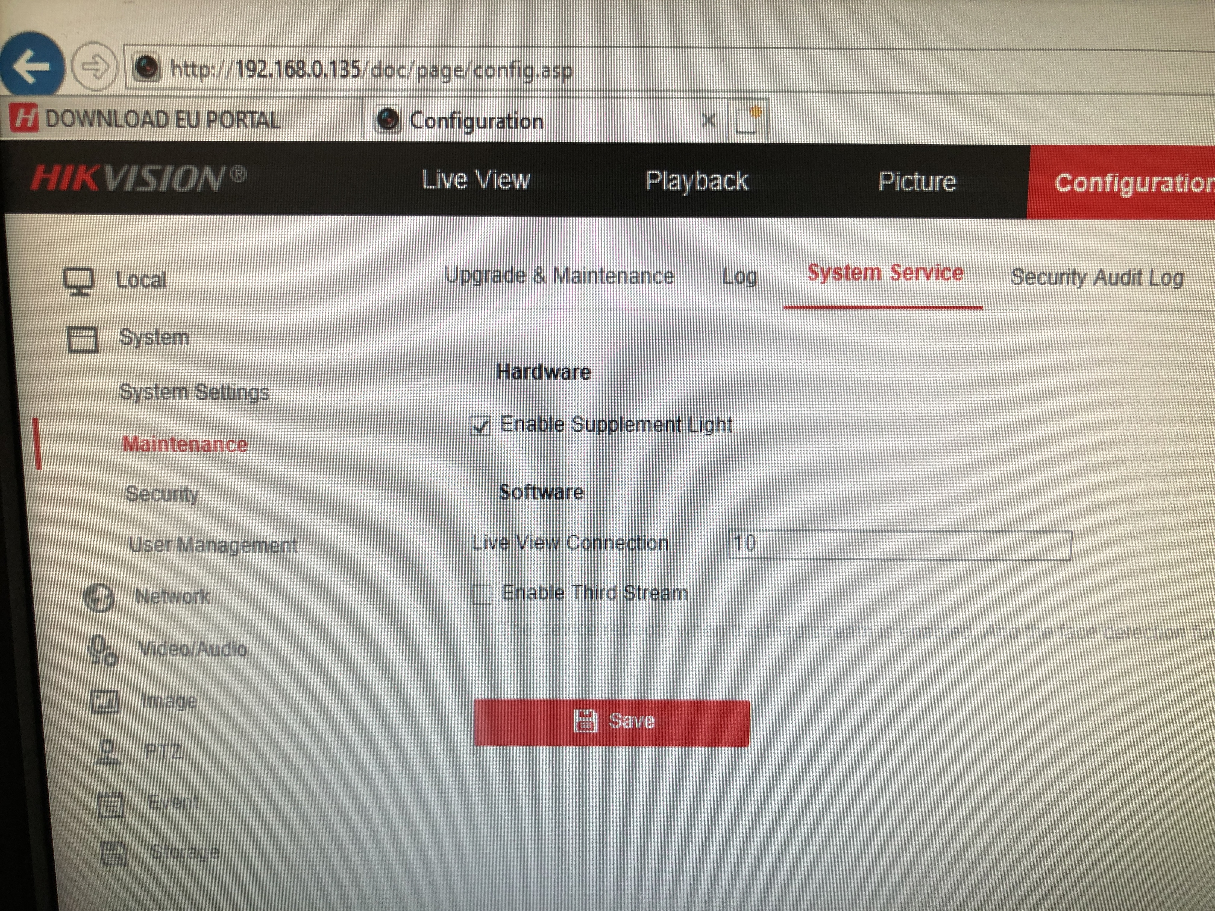

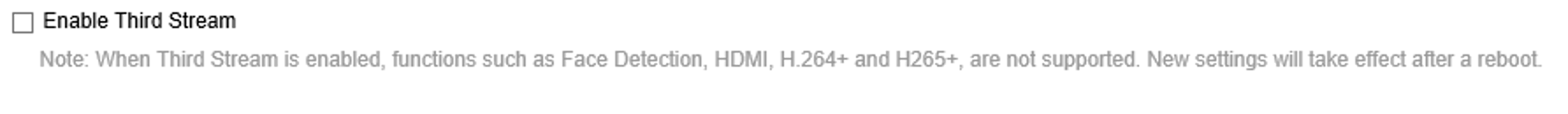

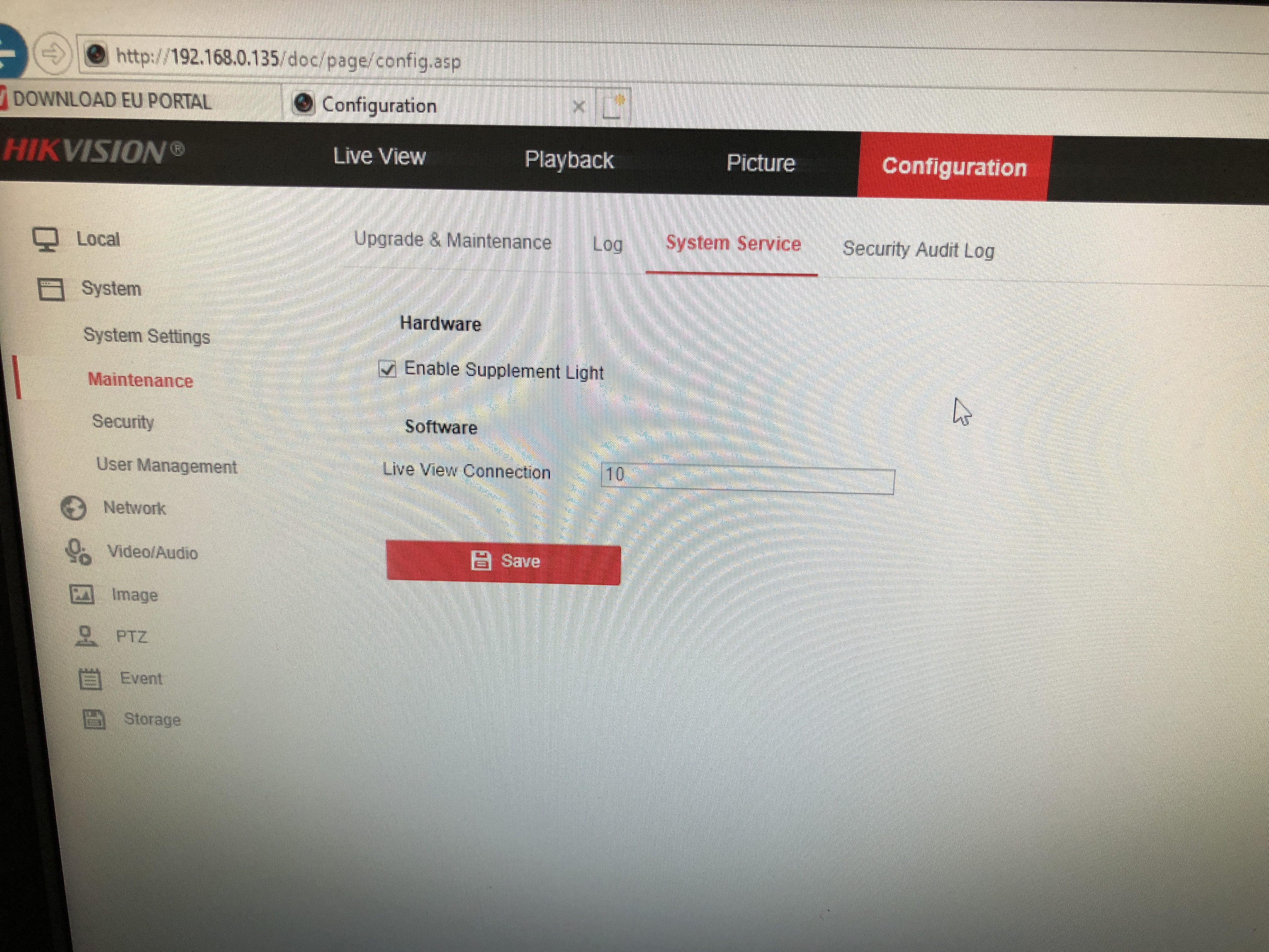

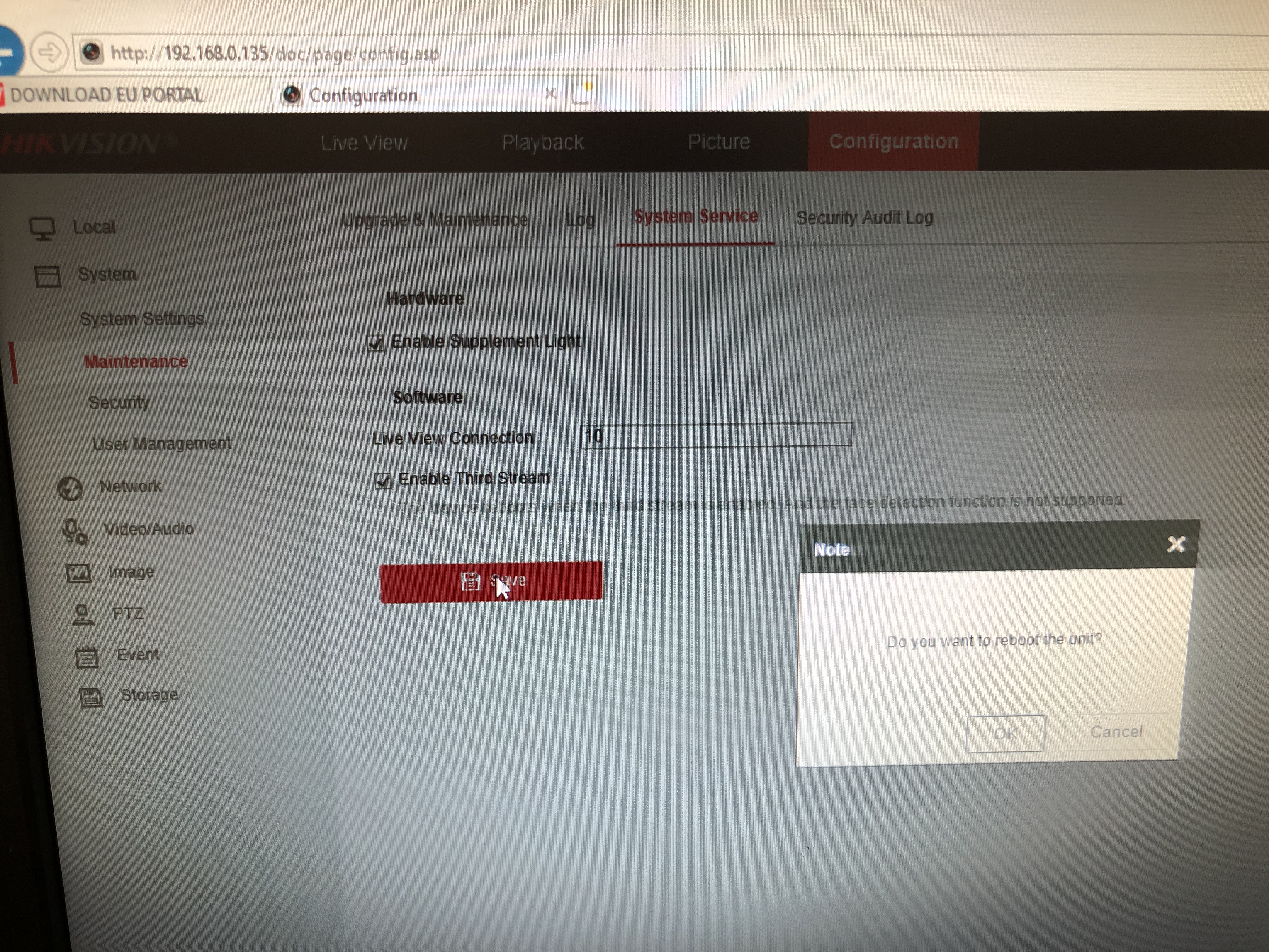

I've recently purchased a Hikvision DS-2De2A4040IW-DE3 PTZ for use in my 'Owls in the tower' project - as I liked the idea of being able to zoom in when the owls are in residence. I also liked it because it had the option of a third stream - which I could use at H264 for the RTSP feed - but still use the primary stream for recording to the NVR at H265. From factory fresh when I log in to the IP based portal through Internet explorer - the option to 'tick' for a third stream is there, and on doing so, it tells me that it needs to reboot. On rebooting however, the third stream doesn't appear in the drop-down of video parameters, only main and sub are there, and the option to tick for the third stream has mysteriously disappeared. When I set the camera back to default, the third stream tick box appears again, and then when it's rebooted, disappears again.
I've checked the firmware and it appears to be on a version more recent than the most recent listed on the European Hikvision download portal. Has anyone experienced the disappearance of the third stream option and how to fix it?

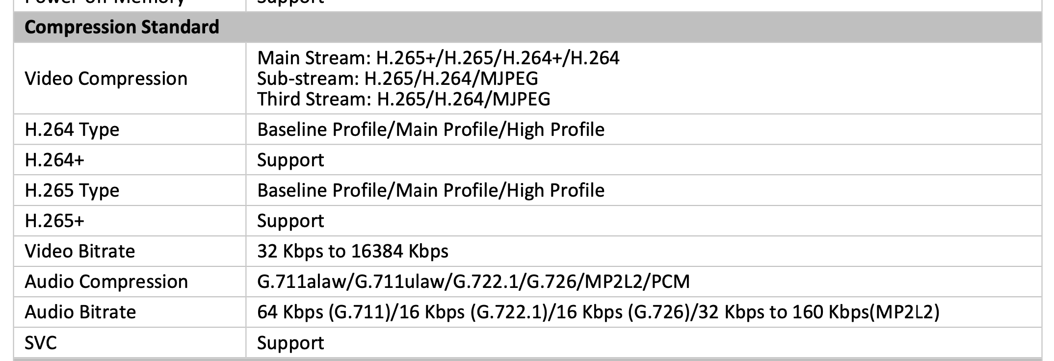

This is from the camera data sheet:
