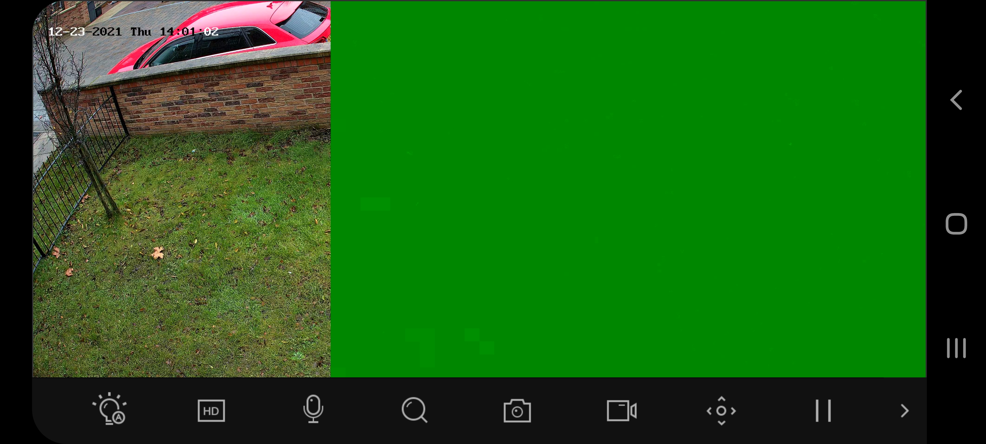

I changed the substream video quality from medium to low to lowest and it made no difference to the HD view via hikconnect. Screen had green screen as before and slow playback loading.
I did the same in main stream and I could change to HD at low setting. No green screen. playback was improved speed loading wise. Problem is.why would my hikconnect be using mainstream to view on and not substreem like its supposed too?

Scratch that. Back to green screen this morning and notifications not loading on the 8mp

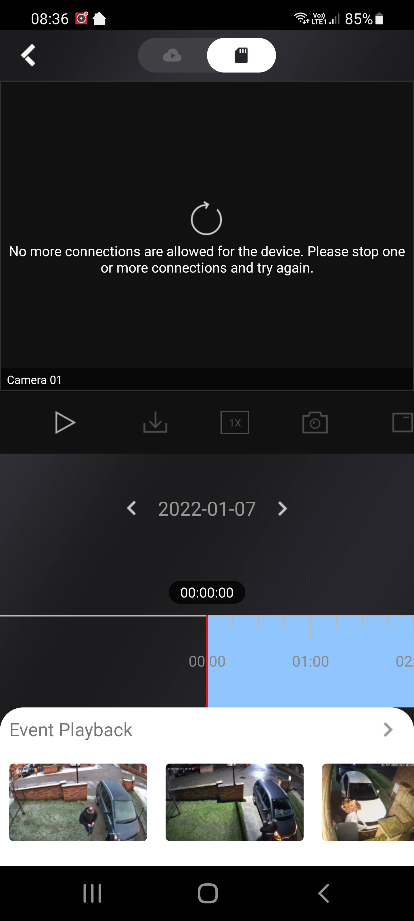

After an nvr reboot it's done it again via playback in hikconnect. With in a week its done it again!!
That means the playback via the nvr will also not play.
Why is this happening?
What connections am I supposed to be stopping?
