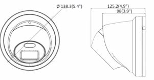

How is it? And can you tell me if you can wall mount it like this?

The camera will wall mount just fine like that. I have all of mine mounted that way. One thing to be aware of is that unlike the previous Easy IP 3 cameras - these turrets are slightly larger in diameter and don't have a big enough recess behind them to conceal the connector so it's got to push in the wall or you use an intake box. With the ISU/SL I'd recommend the latter as you've four leads to conceal - LAN, 12V DC, Audio, Alarm.
Don’t they all run off the Ethernet lead?
Hi @GLO,
They do, the LAN connection will carry both power and data, which is all you need.
The other connections are optional, i.e. you can connect a siren to the alarm lead, a microphone to the audio lead, or supply power separately via 12V DC if you aren't able to connect the camera to a PoE switch or NVR to do so.
