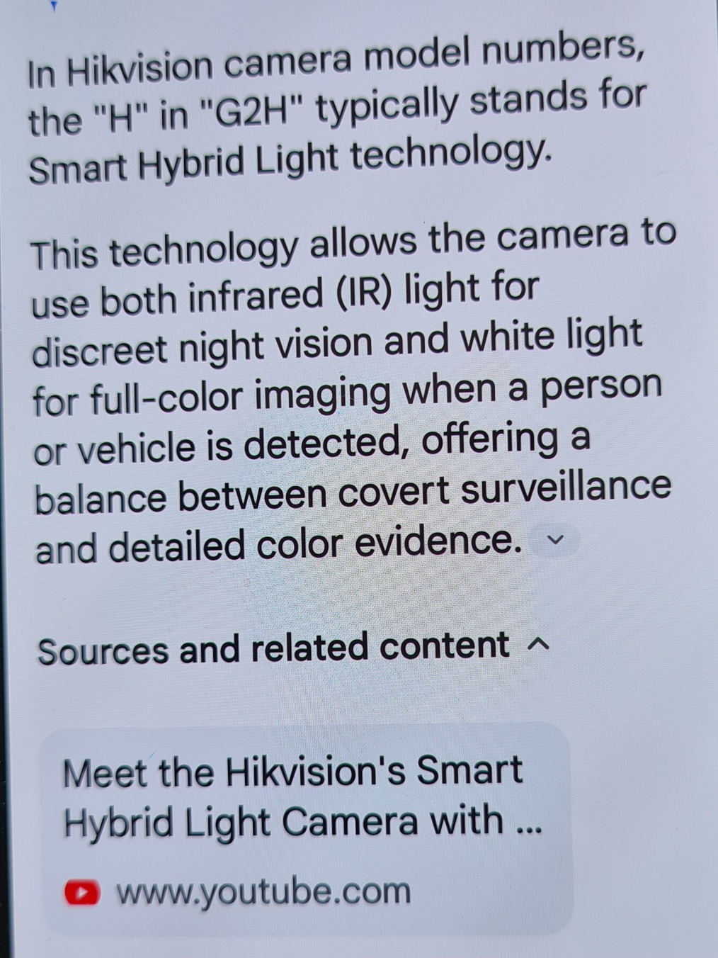

The h does stand for hybrid.

Hello mate, and I know but what was confusing me was the G3 model is a smart hybrid but there is no H within the code, but I have since seen that they just dropped the H from the lettering so that answers that one lol.
