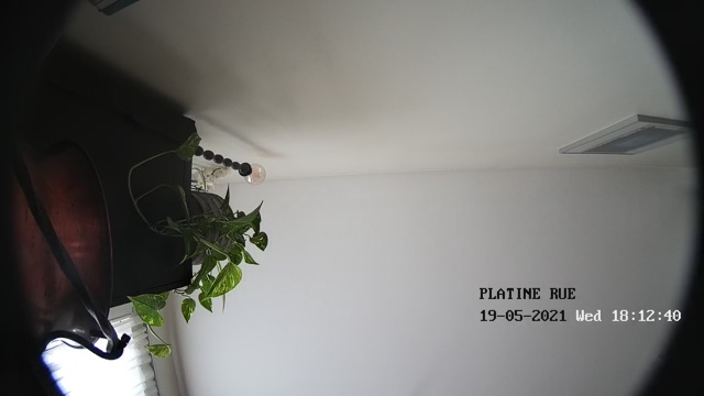

I recently purchased a HIKVISION Villa system with 1 DS-KV8413-WME1(B) Door Station + 1 DS-KH6320-WTE1 Indoor Station.
I'm getting some issues with the 8413 unit. I'm wondering why the camera is vignetting so much (see attached file).
Are you guys experiencing the same problem?
On many youtube videos of reviewing the KV8X13 serie, I don't see any vignetting at all...

Hi @fredbor
That looks like a faulty camera, it would appear that the lens is mounted too far back in the housing and you are actually catching the lens surround in the cameras FoV. I would take this image to whoever you bought from and discuss a return/warranty replacement.

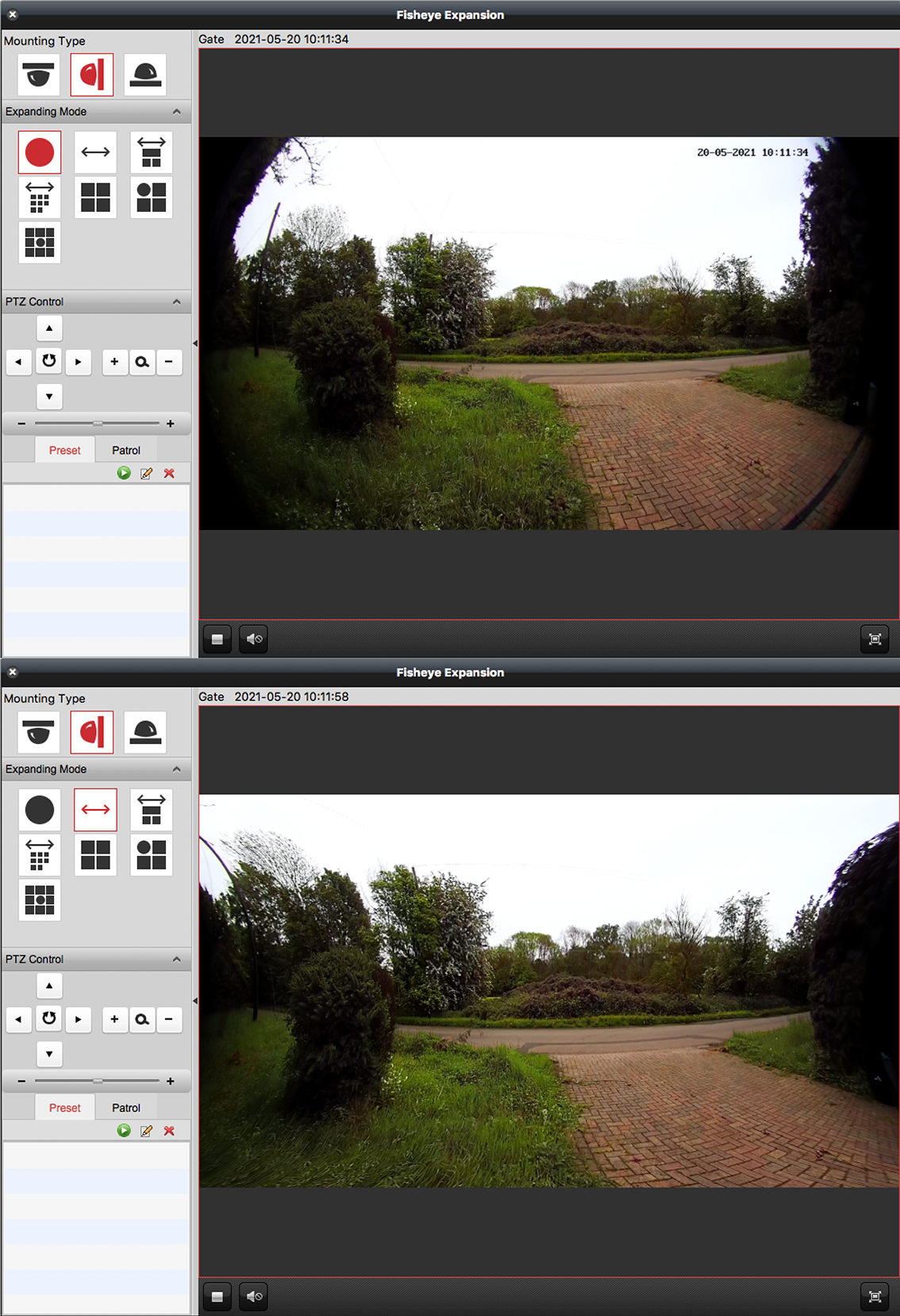

My DS-KD8003-IME1 video intercom has an undocumented (and not very good) Fisheye Expansion adjustment which shows up in the drop-down menu when you click and hold on the live view video window in iVMS-4200. I don't know if the KV8413 is the same.

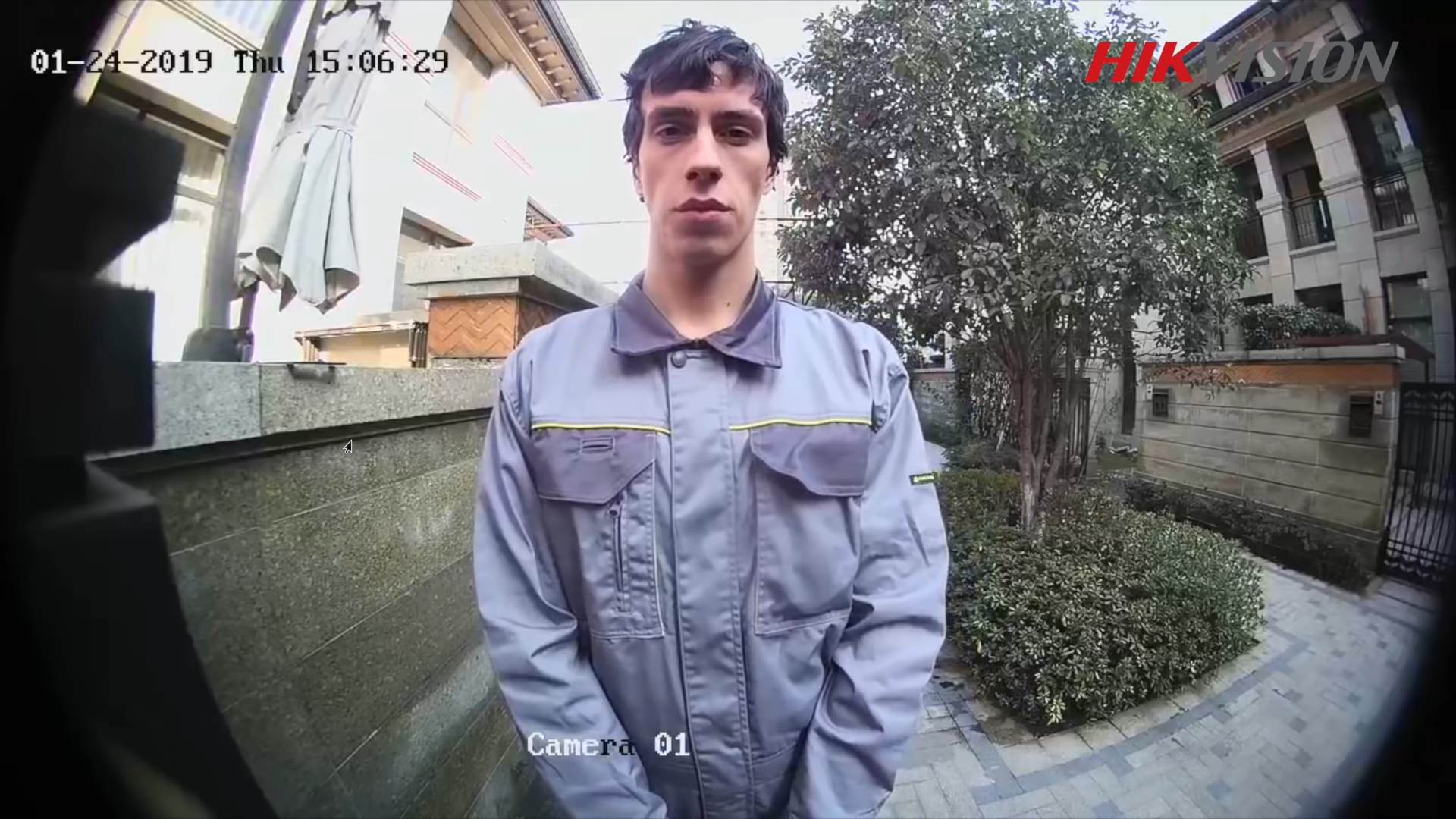

Thank you for the time take to respond to me. Well, I checked the Hikvision official video of this model. Lens vignetting presents there, please look at the screen shot. Can you please share any link of some other video, to compare.
ATM I have a strong feeling that the brand new replacement unit will have the same picture.
Also I suppose that some firmware builds may have lens correction future, like many of their cameras. Unfortunately, 2.2.43 build 210407 doesn't have it.

Thanks for the pic you attached. Interesting
Thereafter the links I used to argue my point to my supplier :
→ 9mn31s
→ 0mn3s
→ 19mn34s
Yes, what I named "image vignetting" might be due to the fisheye lense used in the camera. But Hikvision can correct the distortion in their firmware to corectly fill a 1920x1080 grid (as GoPro does btw).
If they don't, it's a nonsense as they don't really follow their specifications... and the KV8X13 serie goes back in the DIY store quality range!

Thank you for the video links. Yes, on all those videos the image circle is circumscribed, without circular border. (I understand what you mean with "image vignetting").
I can guess that all this videos demonstrate the version A outdoor unit. Unfortunately, only the third one shows outdoor unit setup interface. And it looks different from what I can see on my unit, for example it doesn't have Crop tab in the Image settings. Between, image cropping is the necessary part of every fish eye lens correction algorithm.

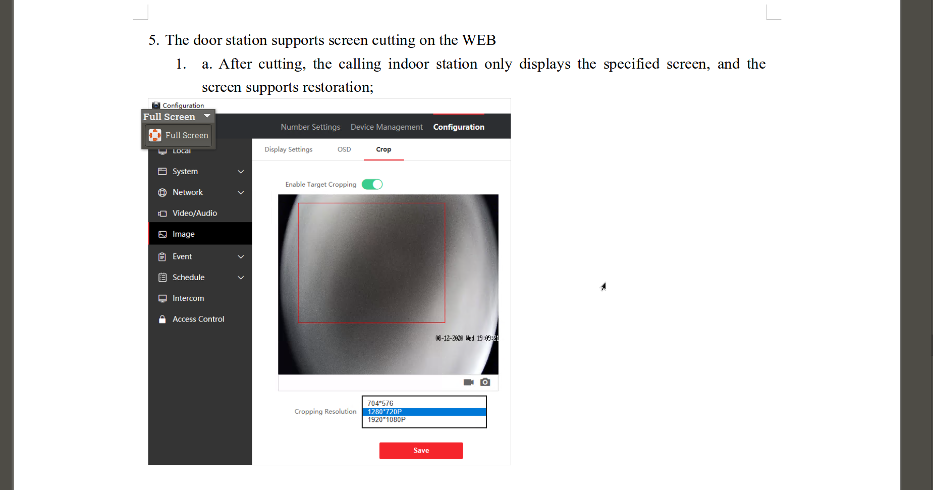

Hi Fred,
Villa Door Station Firmware V2.2.3_200805 Release Note contains some information which can be useful also.
The fish eye lens effect presents there also, please have a look on the screenshot attached.
Regards

I finally received the Villa Door Station unit replacement with Firmware V2.2.43_210407 loaded.
Vignetting is still there à 1920x1080p but yes it has cropping options : 704x776 / 1280x720P / 1920x1080P
705x776 and 1280x720P allow to fulfill the indoor station display whereas 1920x1080P does not (vignetting).

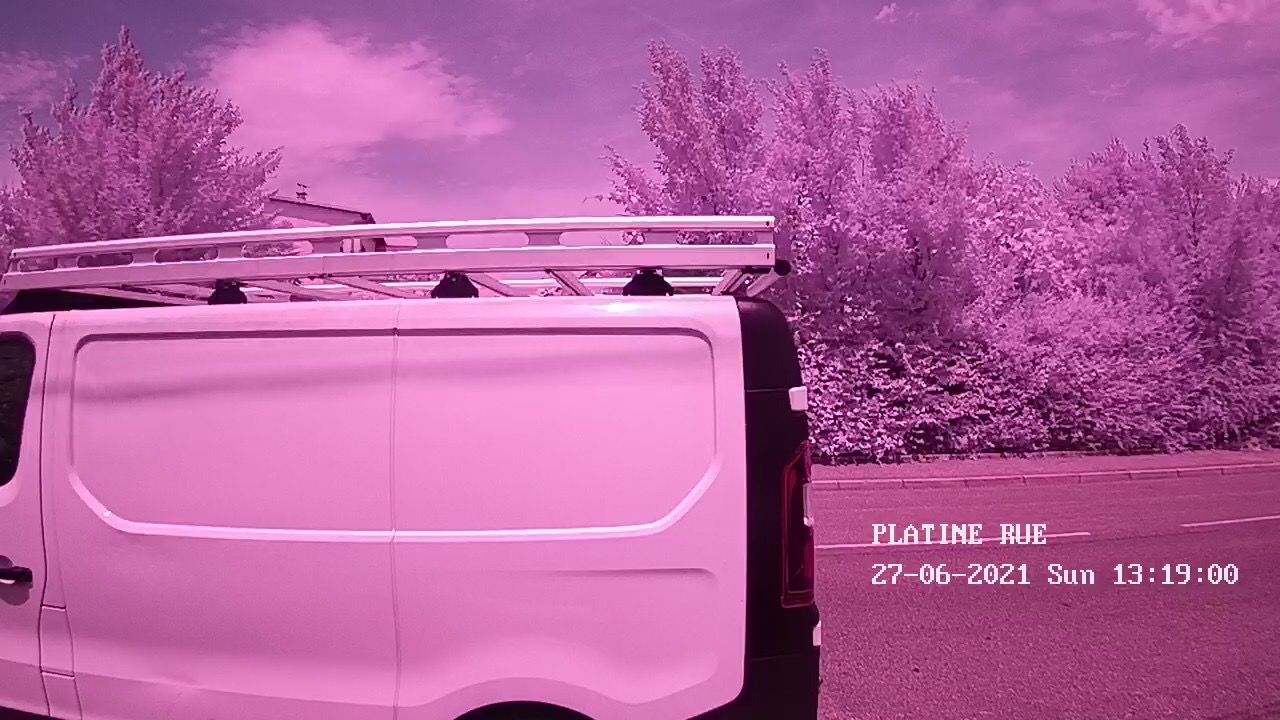

New problem for mine (see attached pic.) : image became very "pinky" these last days...!
But as long as we don't have any comparative correct picture from a decent device, how to prove that the problem does really exist?
HIKVISION could claim that it is as it has to be...
KV8X13 serie has 2 years warranty. At the moment, time seems to be one of our best friend...
So lets keep in touch and as soon as a community member will have a correct device, lets send back our devices in warranty!
With my "pink" issue, I will send mine back few months before my warranty ending to be sure to have the last hardware update.

@fredbor
that is the ir cut filter... try restart the device .. it will help sometimes ... stay near the station and try to hear for a "click" on boot. the filter is mechanic,.. if you dont here a click then the camera is broken.

Thanks for the lens tip. UN fortunately for me, several reboots didn't solve the problem.
I ordered my device from a french certified reseller.
