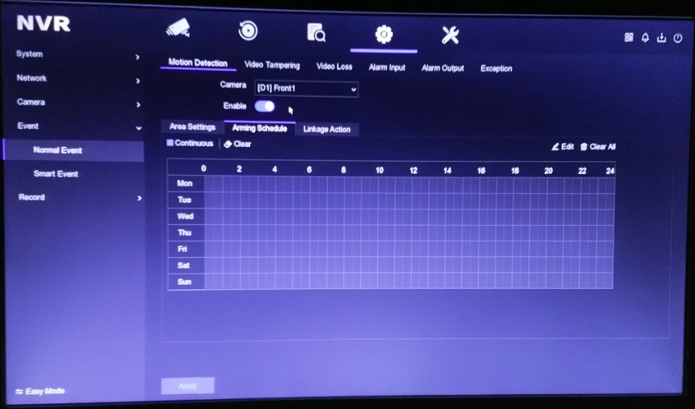

Hi Ben, I've got around that issue at the moment on the 3 NVR's I've upgraded to V4.30.005 build 200628 firmware. I'm only using the "Smart Events" for motion detection and I've cleared the time schedule for every camera on the "Events" so although it still switches on the "Notify Surveillance Centre" for all 8 cameras, it doesn't sent any alerts to our phones and tablets as the schedule tells it not to. I don't have this issue with the "Smart Events" as on my NVR at home I have it set to send events on 3 cameras only and that's working fine. Hopefully this bug will be address in the next release of the firmware and using this "Get Around" saves me having to roll the firmware back on the ones I have already upgraded and I still have another 5 NVR's to do yet. Lee...

Hi, (apologies if I'm explaining something you already know about and how to set up) my NVR running with V4.30.005 build 200628 firmware has 2 sets of event triggers Normal and Smart. The normal events is the bit with the issue and its the same on all 4 NVR's that I've upgraded so far. The setting for the Smart and Normal events are basically the same and for each camera and you can set an area that when something enters, it triggers and event. This event can be any combination of a buzzer inside the nvr, a screen popup, an email and an alert sent to a Hikvision app running on a phone or tablet (called on the NVR "Notify Surveillance Centre"). Also I can set the time frame for each camera to run the options that have been set. This is a 24hour 7 day schedule and its this alert that has the problem. In my case I have 8 cameras and what the firmware does on its own is turn on the alert to my phone on all 8 cameras for the Normal events. So my phone goes crazy with alerts every few seconds. If you uncheck the option on all 8 cameras, 24 hours later its re-enabled itself again and again my phone and tablet goes mad with alerts. So to get around this I set the schedule time period that I want to send the alerts to zero for every day on every camera and so even though the alerts are set to send to my phone, they don't because the schedule says not to. Basically is a work around and as long as I don't use the Normal events, this is now not a problem for me. The Smart Events is the same setup but the alerts to my phone are only ticked on the 3 cameras I want and the firmware leaves the rest alone. I have tried upgrading from different versions of the firmware, doing factory resets between each upgrade and nothing has made any different on all 4 NVR's and all 4 are suffering from the same issue and so I've used this workaround on them all for now until we get the next version of the firmware when hopefully this issue will be addressed. Hope my waffling has made it a bit clearer for you. Lee...

Hi, yes it would, just make sure you delete the Normal Events schedule for each camera and then you will be fine using the Smart Events line crossing, I've attached a pic of mine showing camera 1 and you would need to clear the schedule for as many cameras as you have. Lee...
