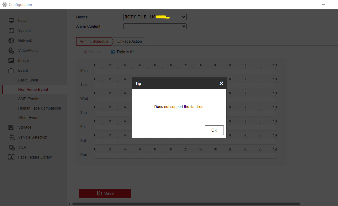

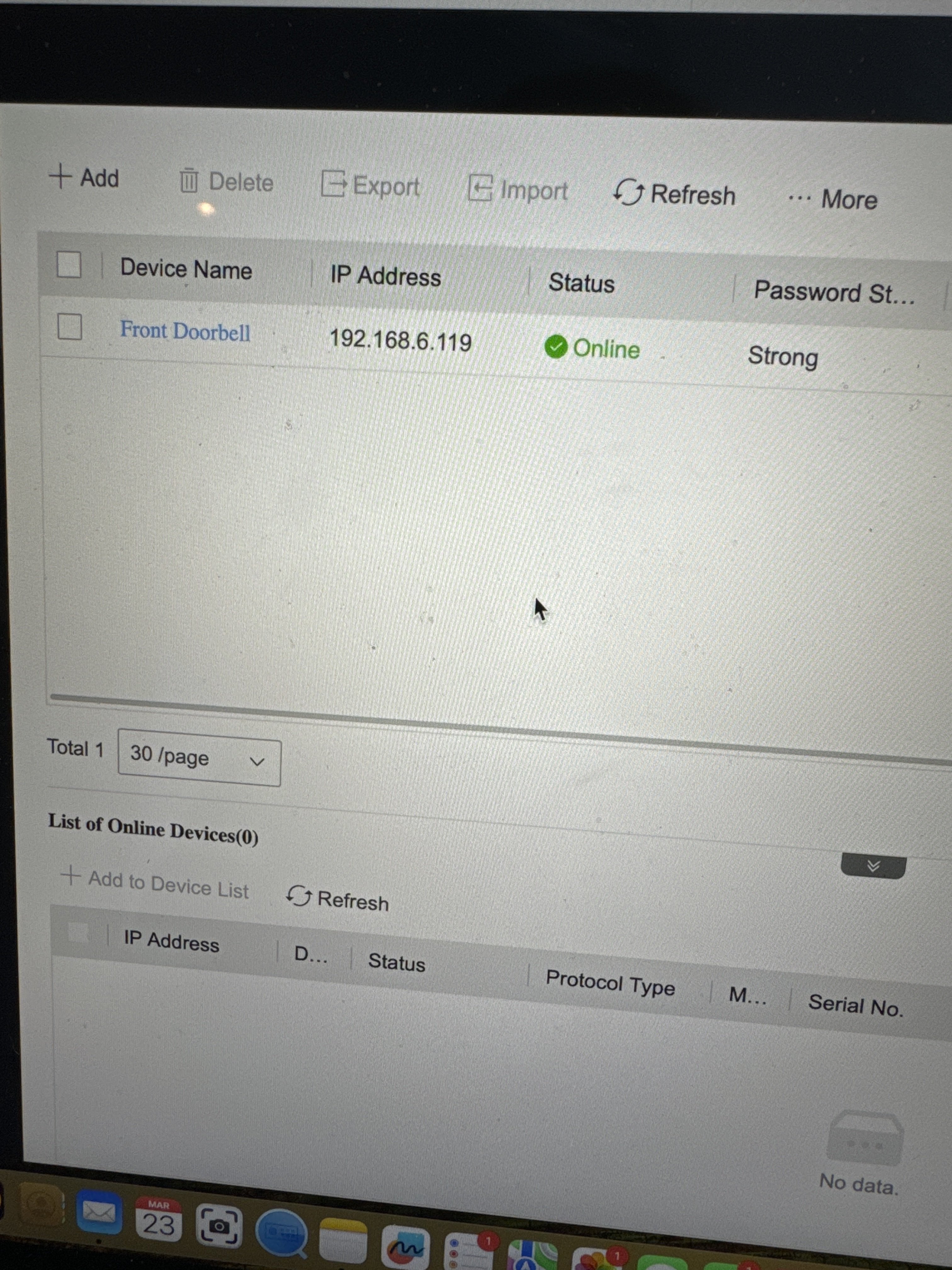

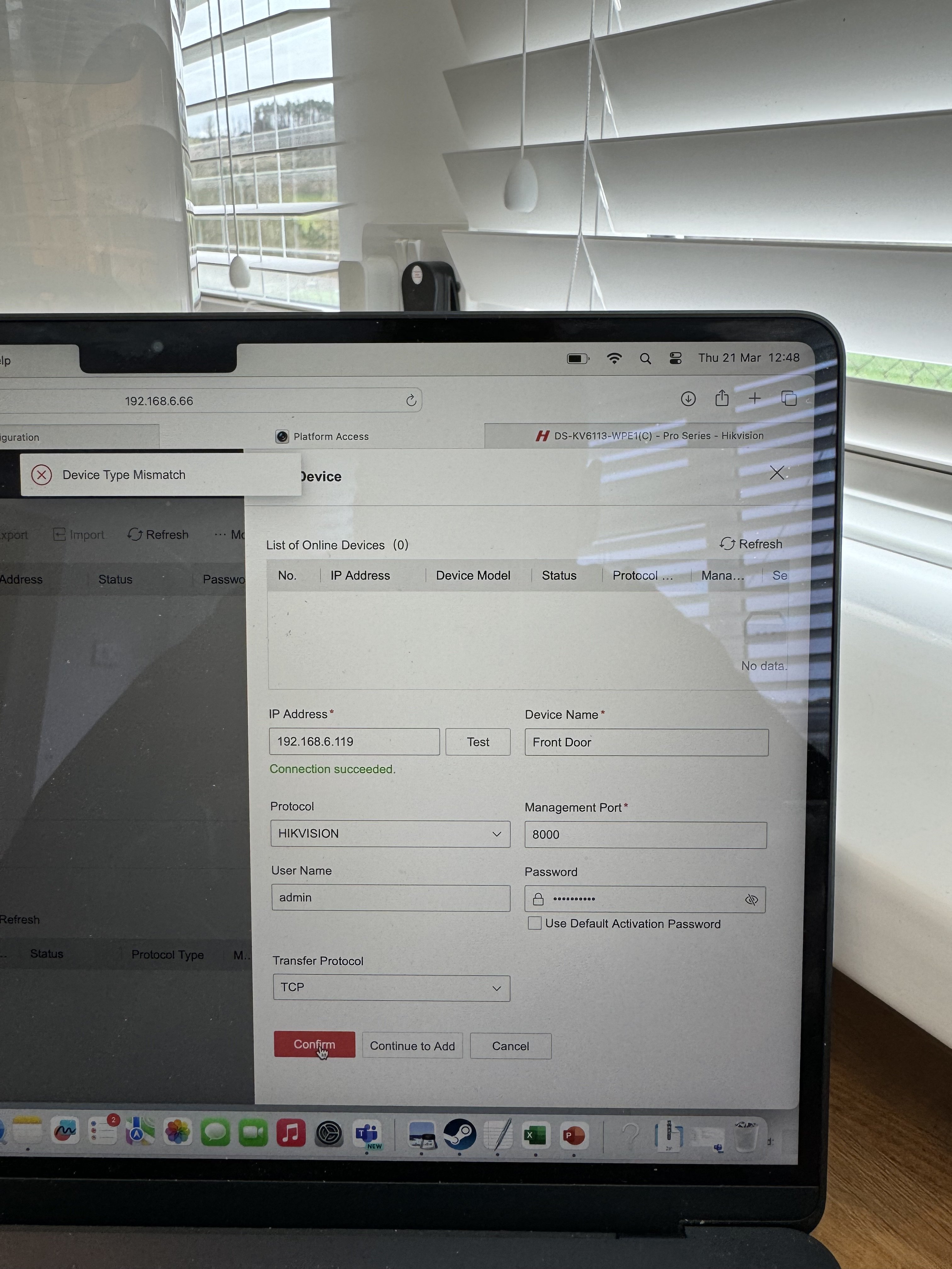

Hi Guys,
Wondering if anyone has a fix for trying to add my KV6113Wpe1(C) doorbell to my 7608NI-M2 NVR.
All working fine on my hik connect app however when trying to add it to my nvr to playback i keep getting “Device Type Mismatch”

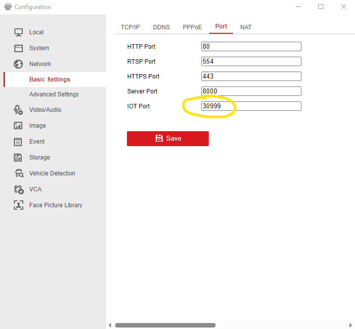

Could this be the IOT port 30999?

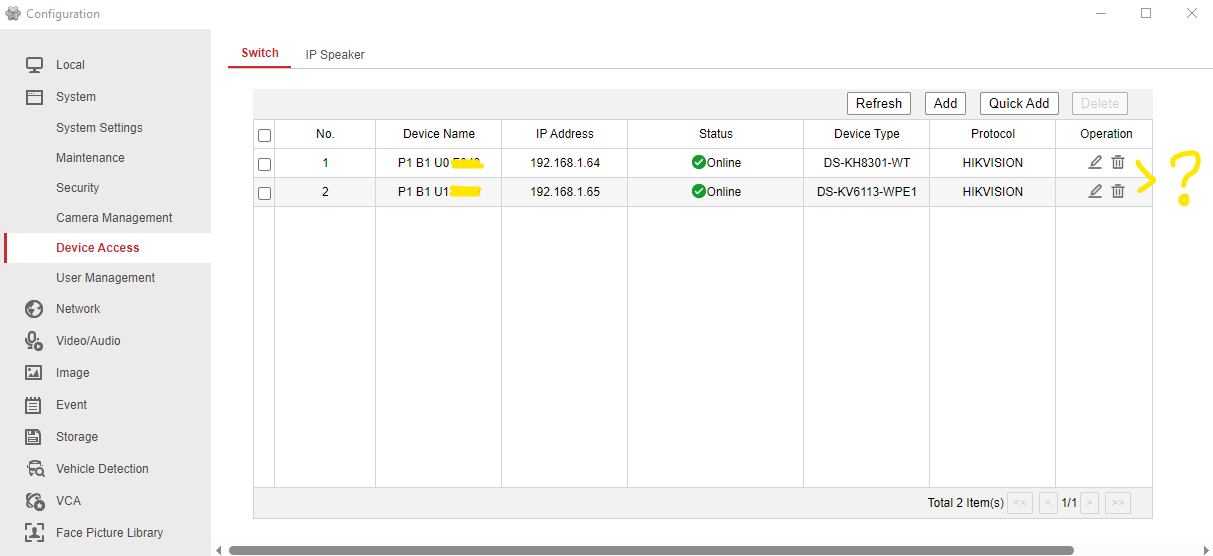

Is this necessary when adding Door or Indoor stations on NVR and How could someone set this?
Door and indoor are added as IOT devices, but there are no options for playback and settings
Mine looks like this:
