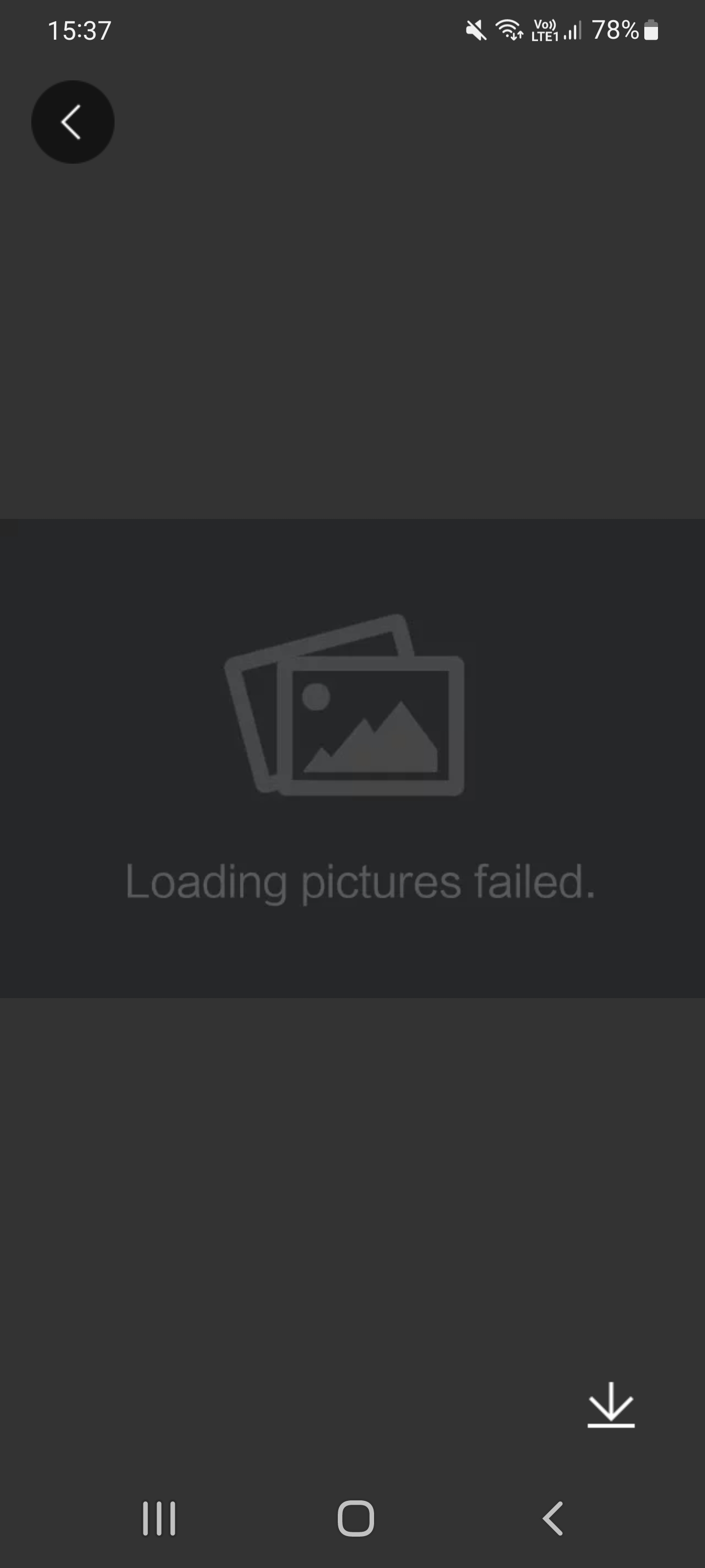

Since the update my Hikconnect has also failed to show thumbnails, it did before

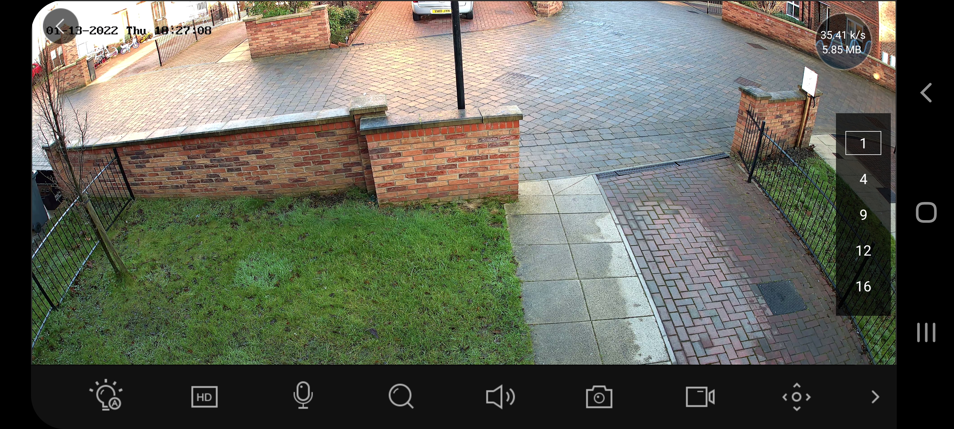

My hd on my 8mp now. No green screens.
I just need to get my notifications working again. I get live view but not notifications lol. Seems like a bit of investigation is needed.
