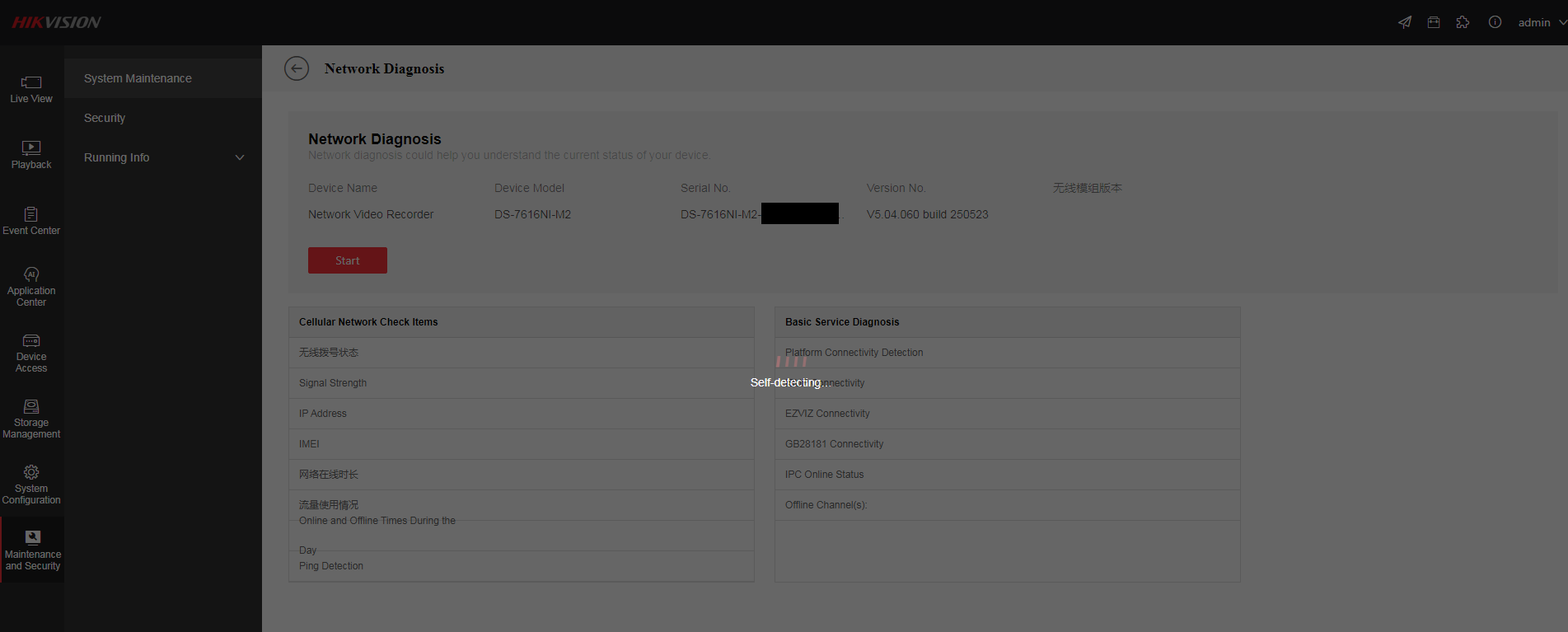

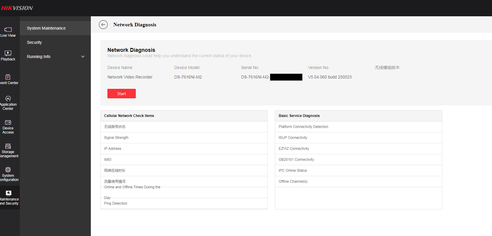

Network Diagnosis (new panel with web GUI) - (new)
  • to access...... Maintenance and Security --> Device Debugging --> Network Diagnosis
  • 10% of the panel is in Chinese language (see attached pics)
  • click on the START button ----- and it goes into "Self-Detecting...." indefinitely
  • one needs to bust out & re-login to the NVR to continue browsing around
  • the NVR's log contains no information on this event
  • not a good look for a new function (whatever this function "really" does)
