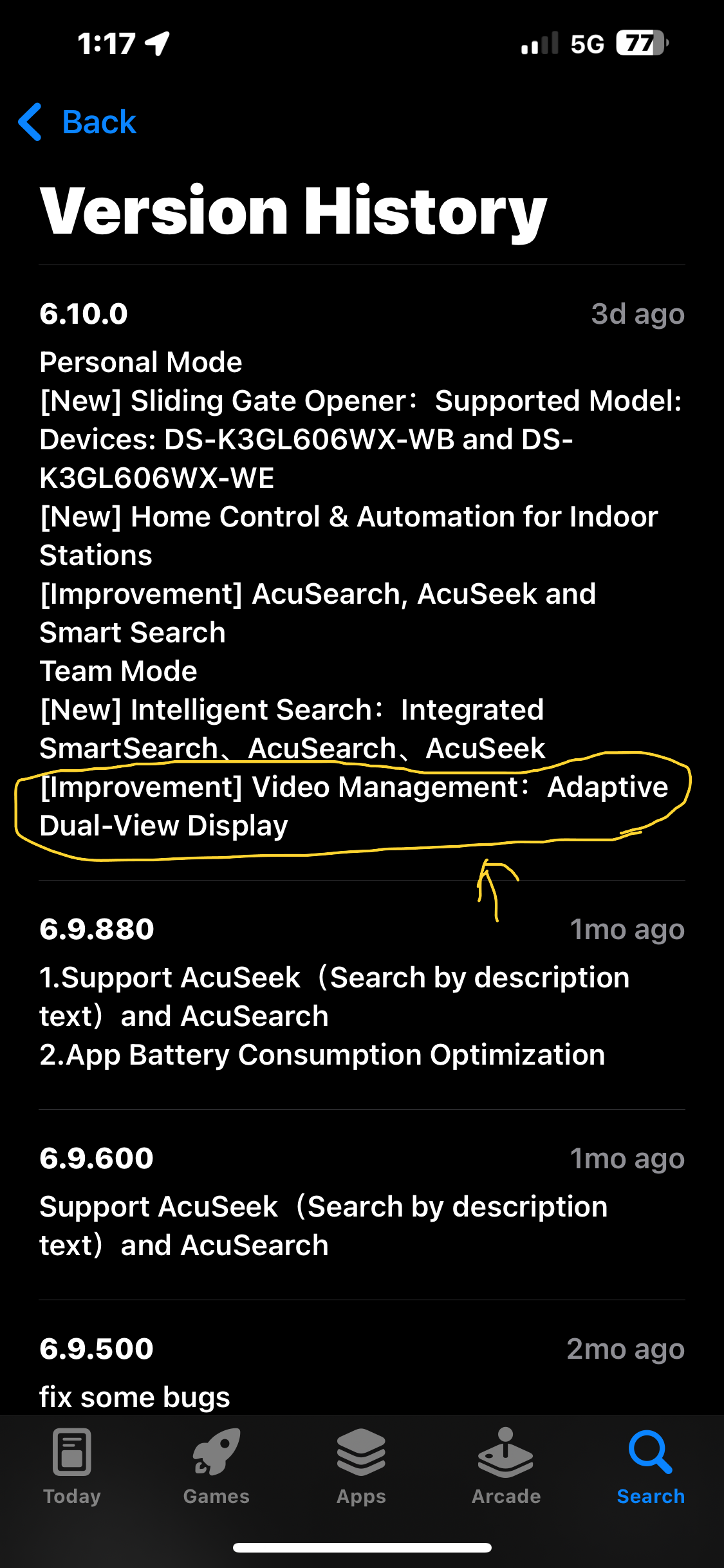

I just took a walk outside to test this... push notification came thought instantly... I think you may just be experiencing a temporary delay due to cell service... my guess is yours starts working instantly again soon.
I was wondering what the "[Improvement] Video Management: Adaptive Dual-View Display" is?

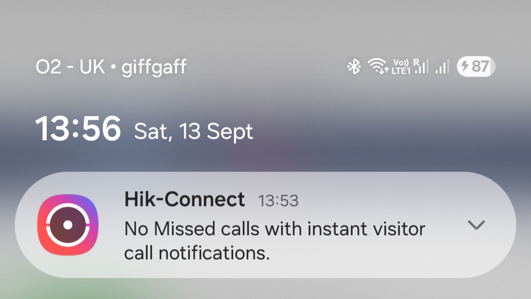

There also an annoying notification on every app start "No missed calls with instant visitor call notifications"
Don't know how to stop that
That must only apply to those with intercoms connected - I did away with mine some time ago. Have you checked that Me > Settings > Display Feature Information is turned off?
Thanks JB
This is disabled but notification appears just when opening app
That’s a strange one. Are there any new options for your intercom in the notifications settings?
I don’t have an intercom anymore but I’ll check on a family members tomorrow after updating the app to see whether they get the same message on app start.
@alfaclvi - I updated the family members app to the new version (they have a KV6113 intercom installed). I didn't get that message showing up on app start, everything is normal on theirs. They're on iOS; I wonder if it is something specific to Android?
Thanks JB
I am on Android. Not at home now but unlinked from hikpro with no success. There are no new options in notifications and that's strange. Also cannot find any information about this "instant visitor calls".
I 'll remove KV6113 from account and check again. Or wait for newer hikstore version
An update
Removed(deleted) KV6113 from account and message did not appear again. Added device again and message appears again every time the app is opened. This is like an advertisement.

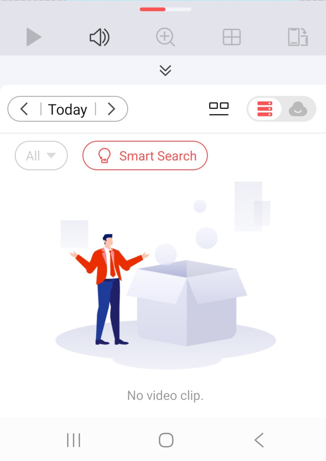

Does Smart Search work for you? Option is enabled in Intelligent Search NVR setting of the app, but drawing gives no results for me... (no video clip)
No not properly. If I select Smart Search and draw the grid, I get results marked as red markers on the timeline. However:
  • I have to manually drag the timeline to the markers (it doesn't skip unrelated video)
  • It struggles to play after scrubbing along that timeline
  • The grid remains on screen during playback
  • If I rotate the screen to landscape while playing back from smart search, the search is lost and the playback time jumps to 23:59
I'm not sure whether the search is Human only. I seem to only get Smart Search results for Human on most of my cameras. On some cameras out the back of the house it picked up foxes in the results, but I guess that's just the AcuSense interpreting the foxes as Human. G5 cameras are on 5.7.19 so I guess the situation is the same for dual VCA search as it has been since 5.7.15.
