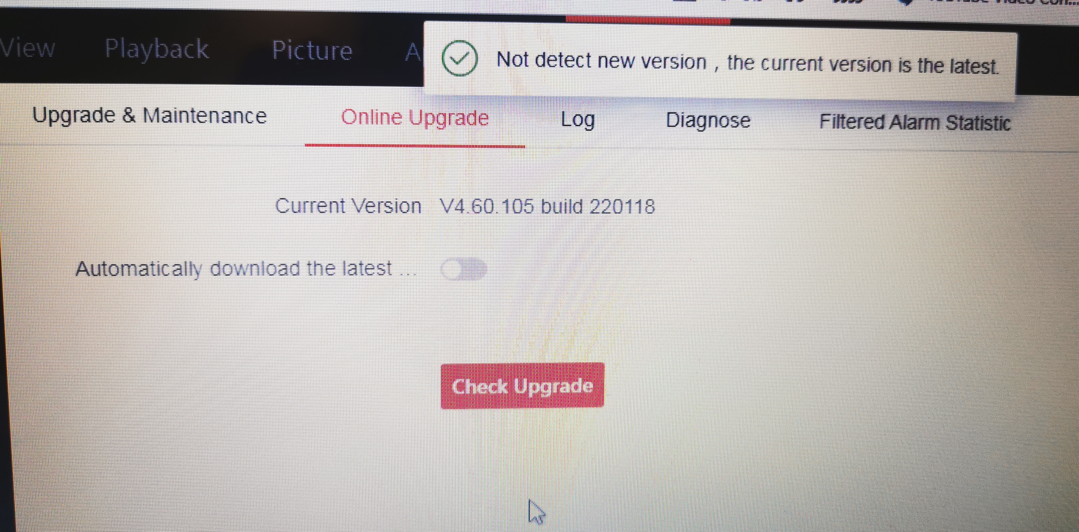

DS-7608NXI-I2/8P/S
V4.60.105 build 220118
(Factory update) I have never updated, and if check upgrade tell "not detect new version , this current version is the latest".

Hi @Basim
The Update button in the NVR menus has not worked properly for a long time and will often tell you it is up-to-date when it is not (we've pointed this out to Hik multiple times but they still have not fixed/removed this feature).
You can find the latest firmware either at the Hikvision website or the Hikvision Download Portal, the latest version for the NXI AcuSense NVRs is v4.61.066 which you can update straight to from your current firmware.
