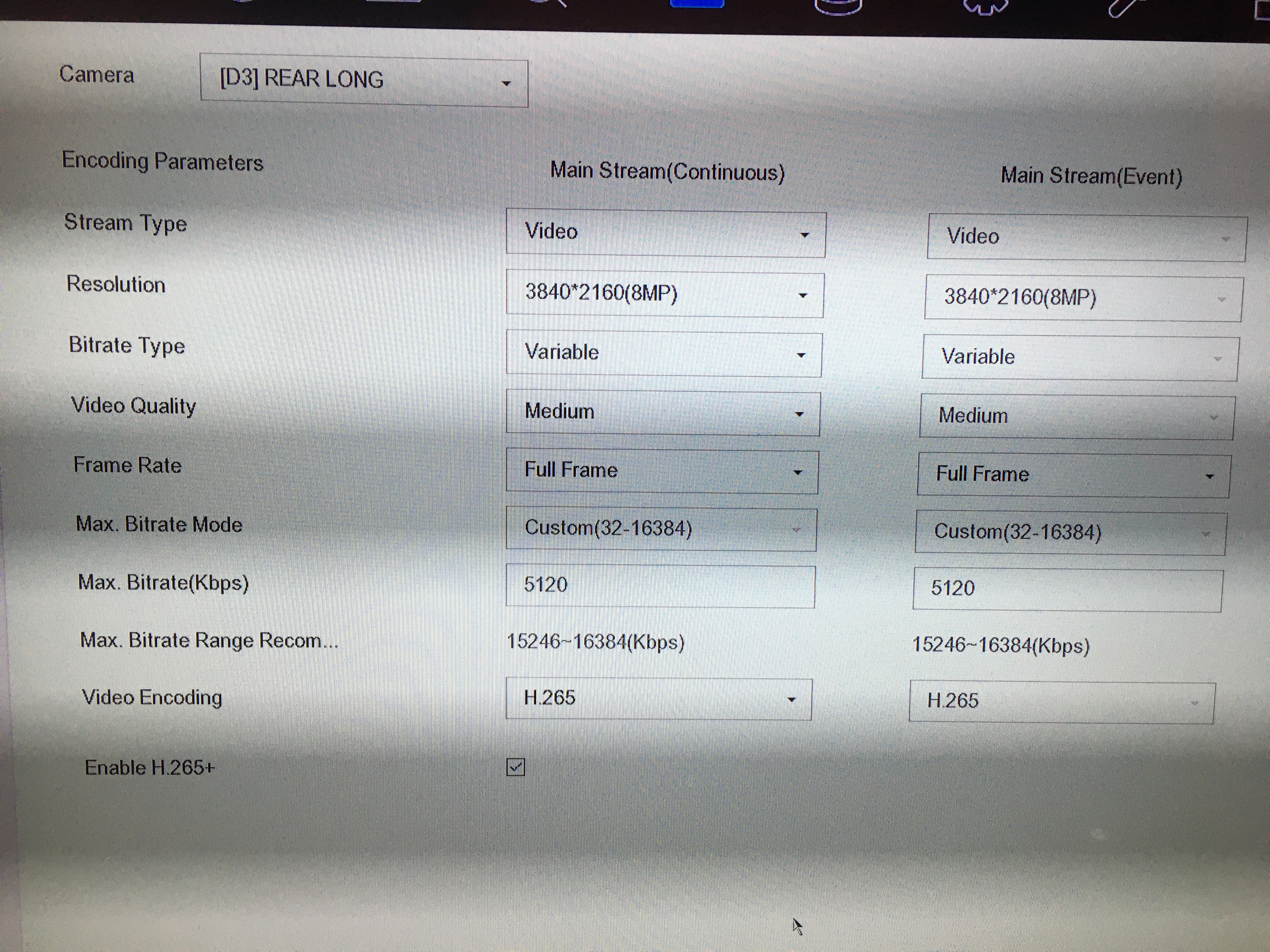

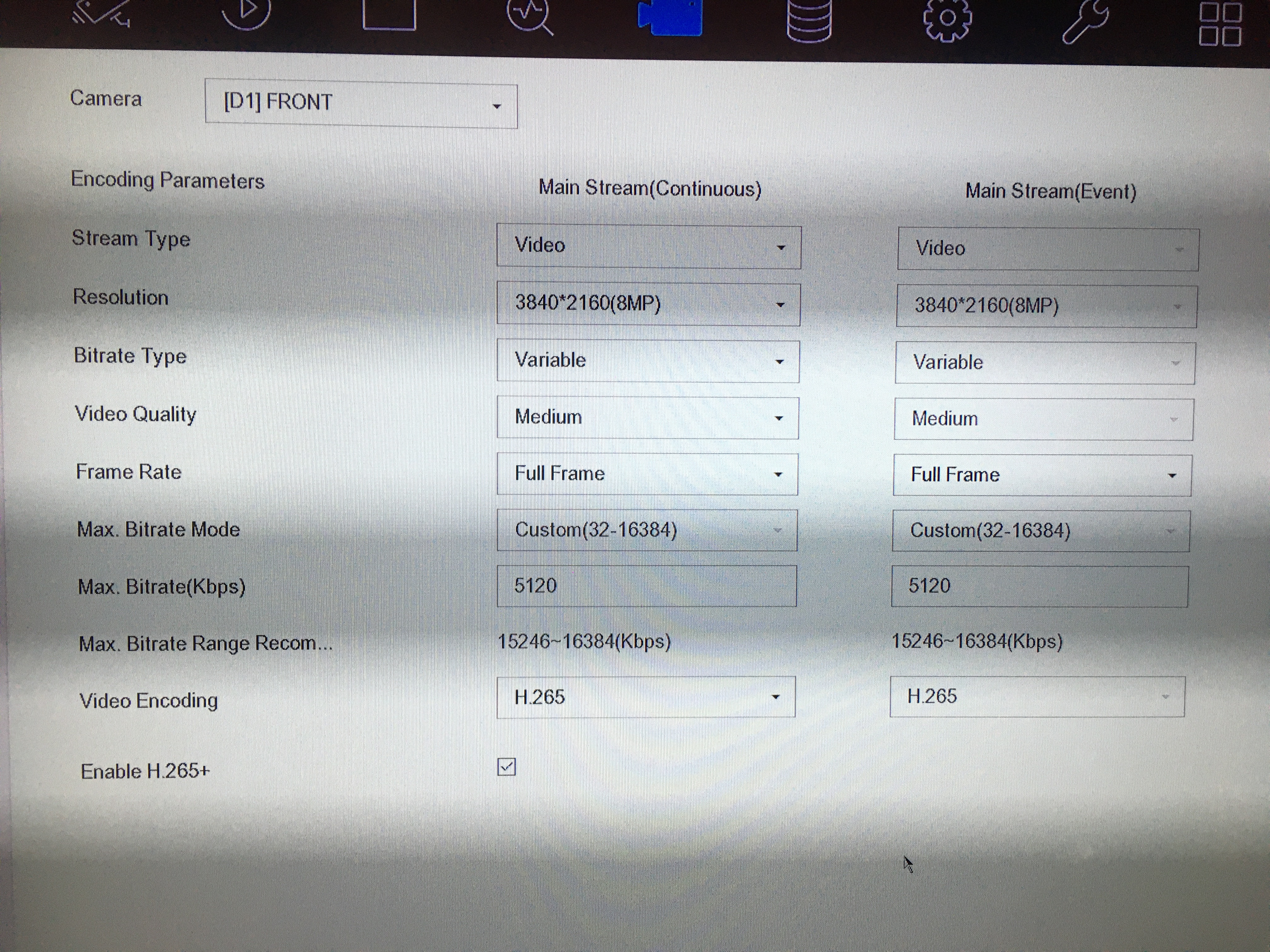

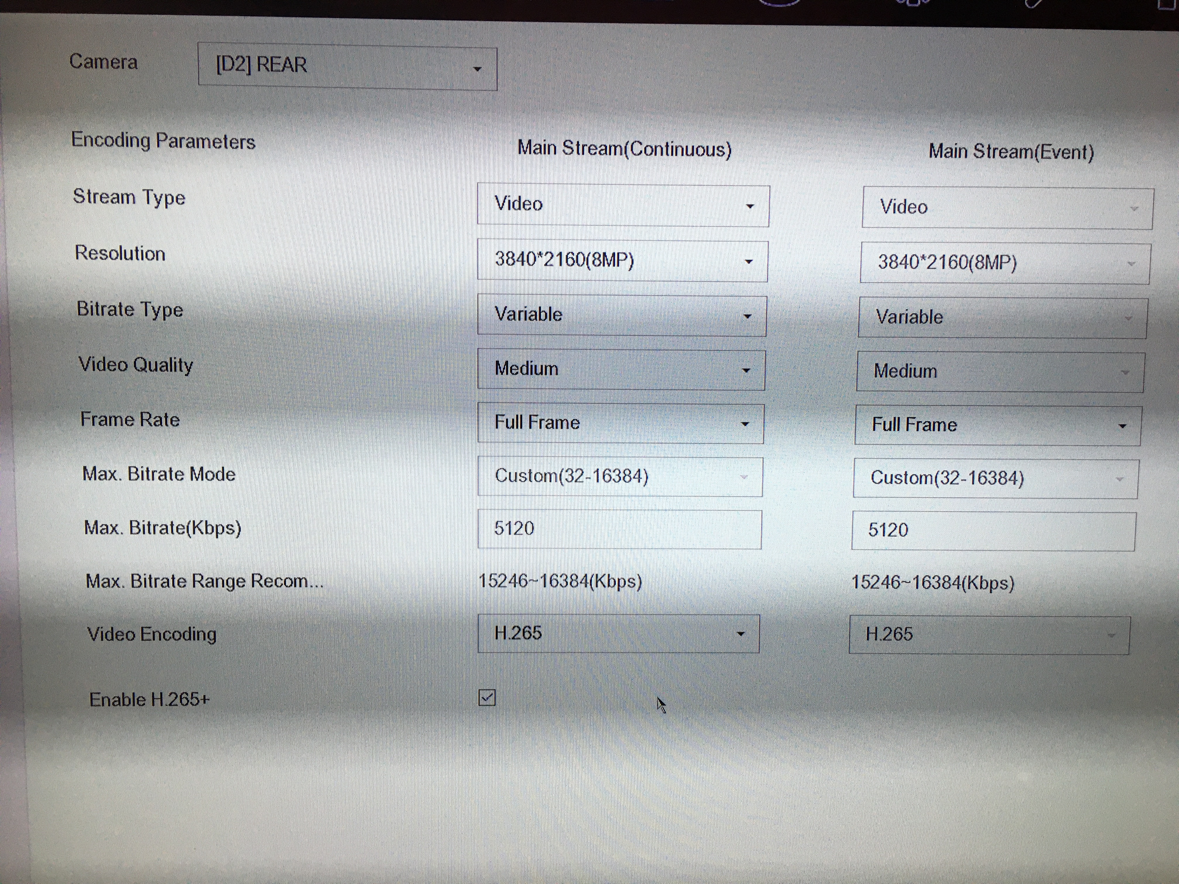

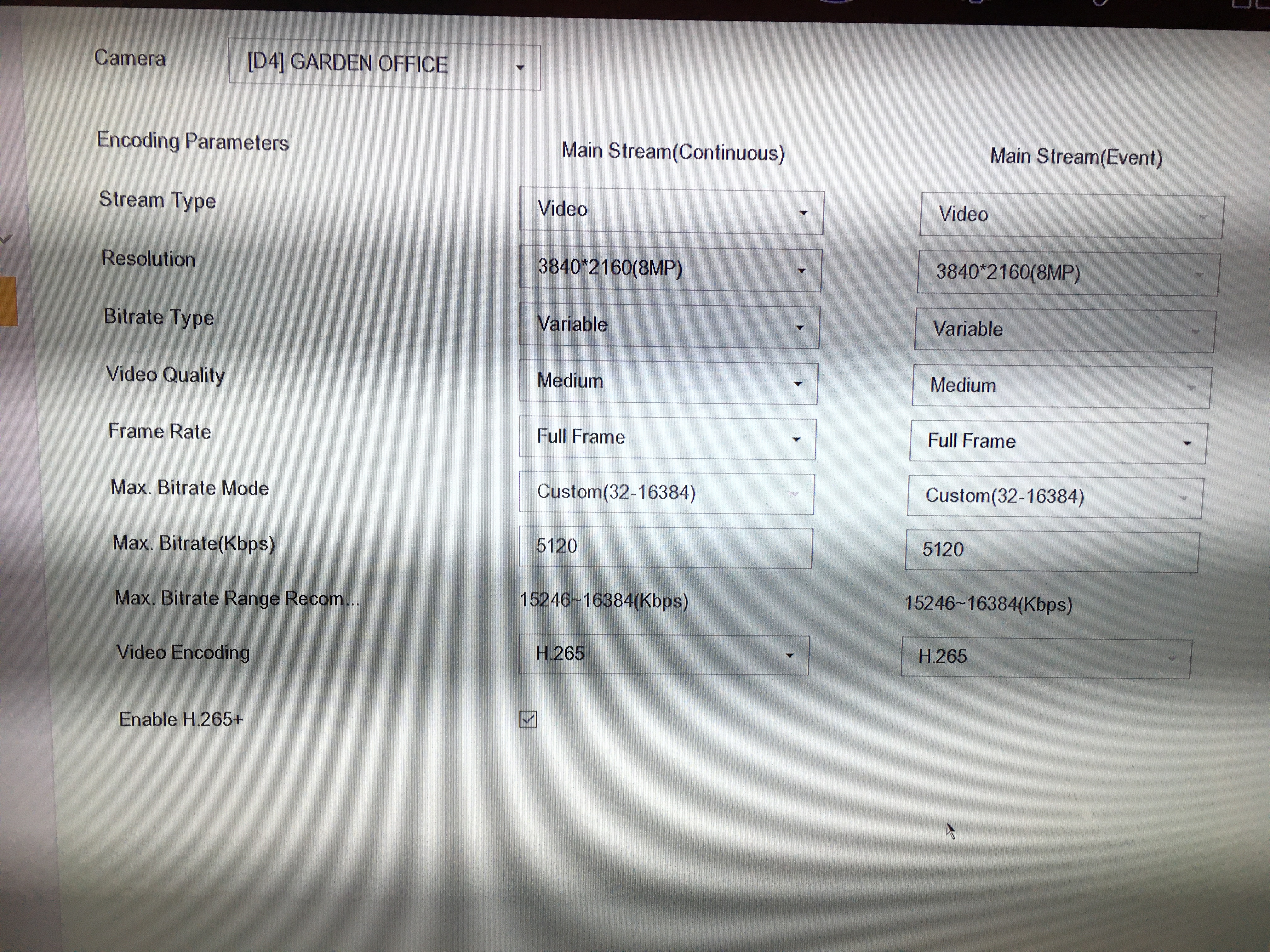

I have had 3 cameras connected to an 8 port NVR over POE. All of these have been displaying a LiveView fro HDMI connection to a Samsung screen. All 3 camera are set to 8MP under Main stream. I recently added a new turret as the 4th camera (IP connected not via a POE port on the NVR) and this causes one of the other main stream live view to show as No Resource when in a 2*2 live view configuration.
Reducing one or two of the cameras to 4MP Main Stream fixes the issue as does using the low res sub stream in the live view.
I am wondering why the live view in a 2*2 split screen cannot handle all 4 cameras set as 8MP?
I updated all cameras and NVR to latest firmware yesterday.

Ok,
Can you share screenshots of the video stream settings for each camera? (including the one showing no resource)

Thanks,
I think the issue is likely related to the frame rate and/or bit rate, the 2x85FWD/2x85G1 cameras support a max. 20fps when set to 8MP resolution and the I-series NVR can decode a maximum 4 x 8MP 25fps camera streams at the same time, you have the cameras set to 'full frame' which sometimes can make the cameras frame rate fluctuate which may be confusing the NVRs ability to decode all 4 cameras, we would recommend setting to 20fps instead. Also, what is strange with your stream settings is that you have H.265+ enabled and still have access to the max. bitrate settings, on our demo I-series NVR the 8MP cameras running H.265+ have these options greyed out because at the higher compression level the bitrate is controlled automatically. On our demo system, the 8MP cameras have a max. bitrate of 8192Kbps and so if you have control of those max. bitrate settings I would set them to 8192 or higher to make sure you are not strangling the camera's bitrate/bandwidth requirements.

With H.265+ enabled the Max Bitrate mode and Max Bit Rate options are greyed out.
The values in those fields are those from when I removed the + setting.
I have dropped video quality to medium for all and frame rate down to 10fps for all.
Issue persists.
The cameras can function and record fine an Highest for video quality and Full frame rate at 8MP resolution.
I can view all 4 in live view within the Hik-Connect app
I think the issue may be to do with the HDMI output resolution which is set to 1920*1080 (60hz) 1080P

maybe not though
As I see same No Resource issue when outputing to Aux monitor via D-Sub connection
Yeah, I think it is just a limitation of the NVR decoding capabilities and as long as it is still recording all the cameras at max. settings the live stream is less important because when you are viewing 4 x 8MP live streams in 2*2 layout you are not actually viewing the full 8MP image of any of those cameras because even on a 4K screen that 8MP image is being compressed into 1/4 of that 8MP screen. We usually recommend that you just live view as many cameras as you can in main-stream resolution and then leave the rest on sub-stream and then if you need to look at any of those sub-stream images in more detail you can just double-click the live view to blow that camera up to full screen and main-stream resolution.
