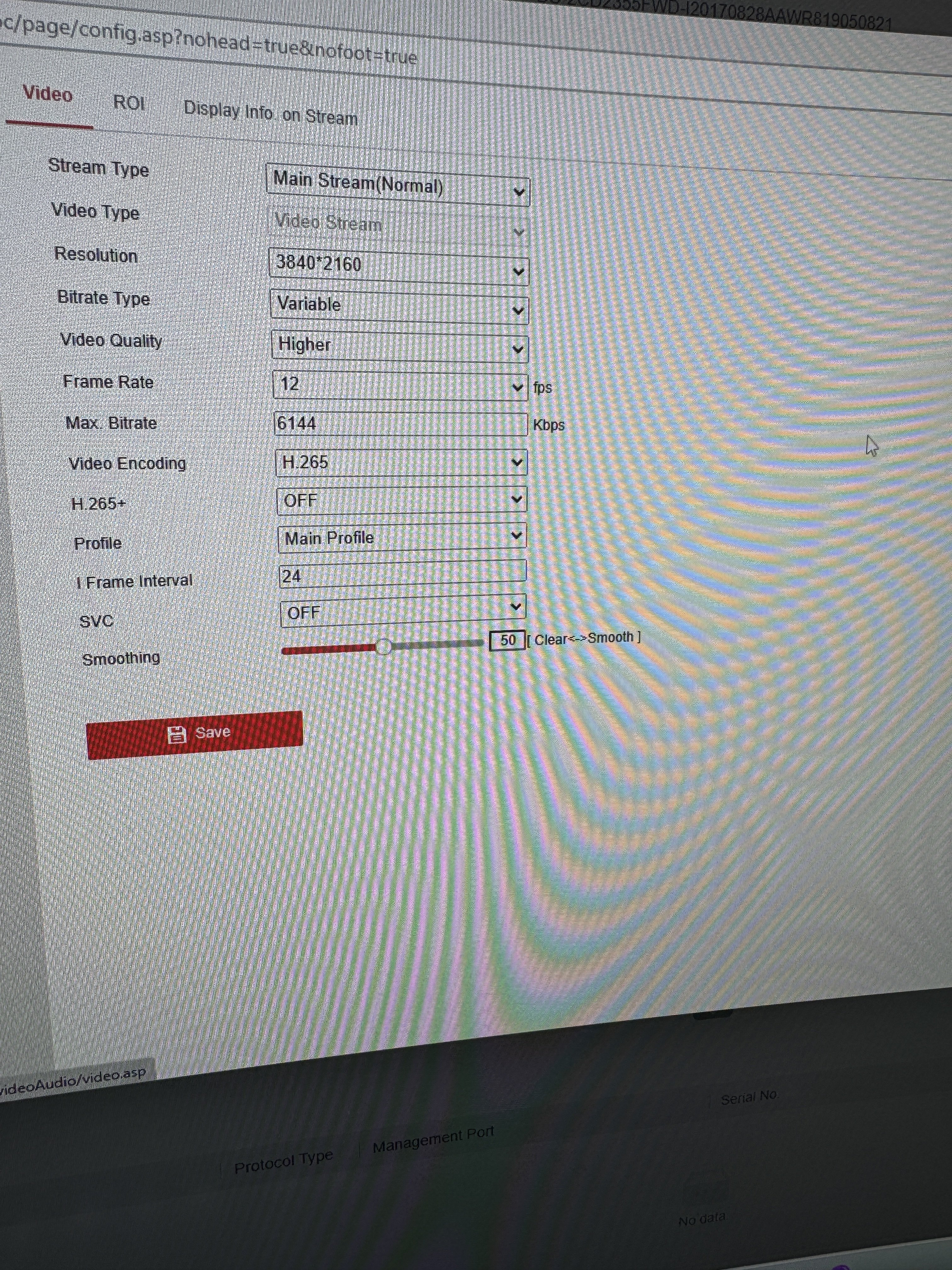

When I try to log in to the camera using http:/ with my details it says unable to connect. So when I log in through the NVR’s IP address I have system config , then network config then under that I have network parameter, hik connect , platform access and network service. I don’t have anything else. However if I got to device access I have an operation column if I click that it then says about connecting remotely to the camera. So I connect through that then I get this
That all looks to be fine. I just can’t understand why the stream info for your main stream was topping out at 2Mbps. With variable bit rate, the value you set (6144 in your case) is a cap, but the cameras have a tendency to burst a bit above the setting usually.
