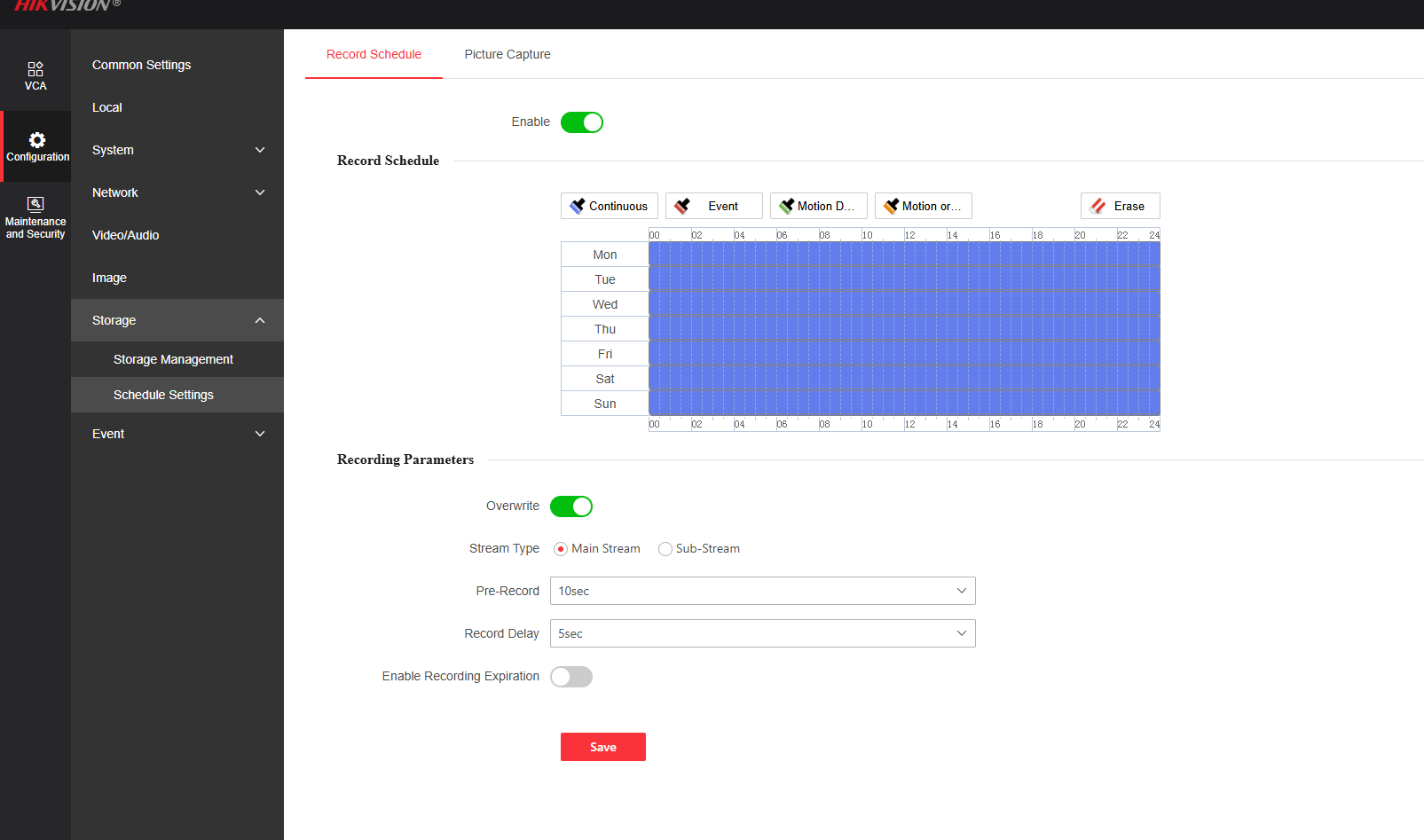

I bought brand new Hikvision DS-2CD2086G2H -UI camera and got it equipped with WD Purple Line SD Card.
Got it installed, updated to newest firmware (V5.7.23 build 260114), got newest IVMS and HikConnect on phone.
I want the camera to record continuously and get VCA events notifications.

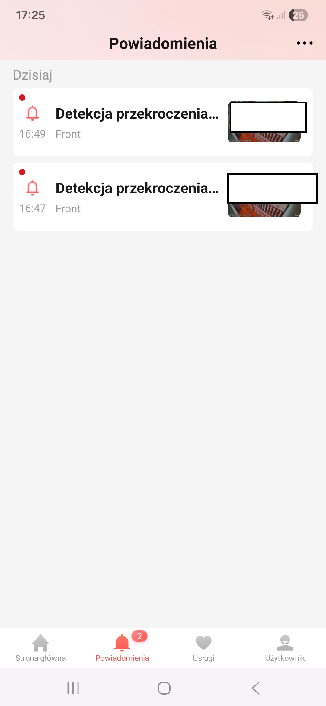

I've marked the Storage > Schedule to blue (Continuous) and have set up VCA alarms, which work great they do send notifications to phone along with like 2 min video replay of the event.

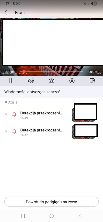

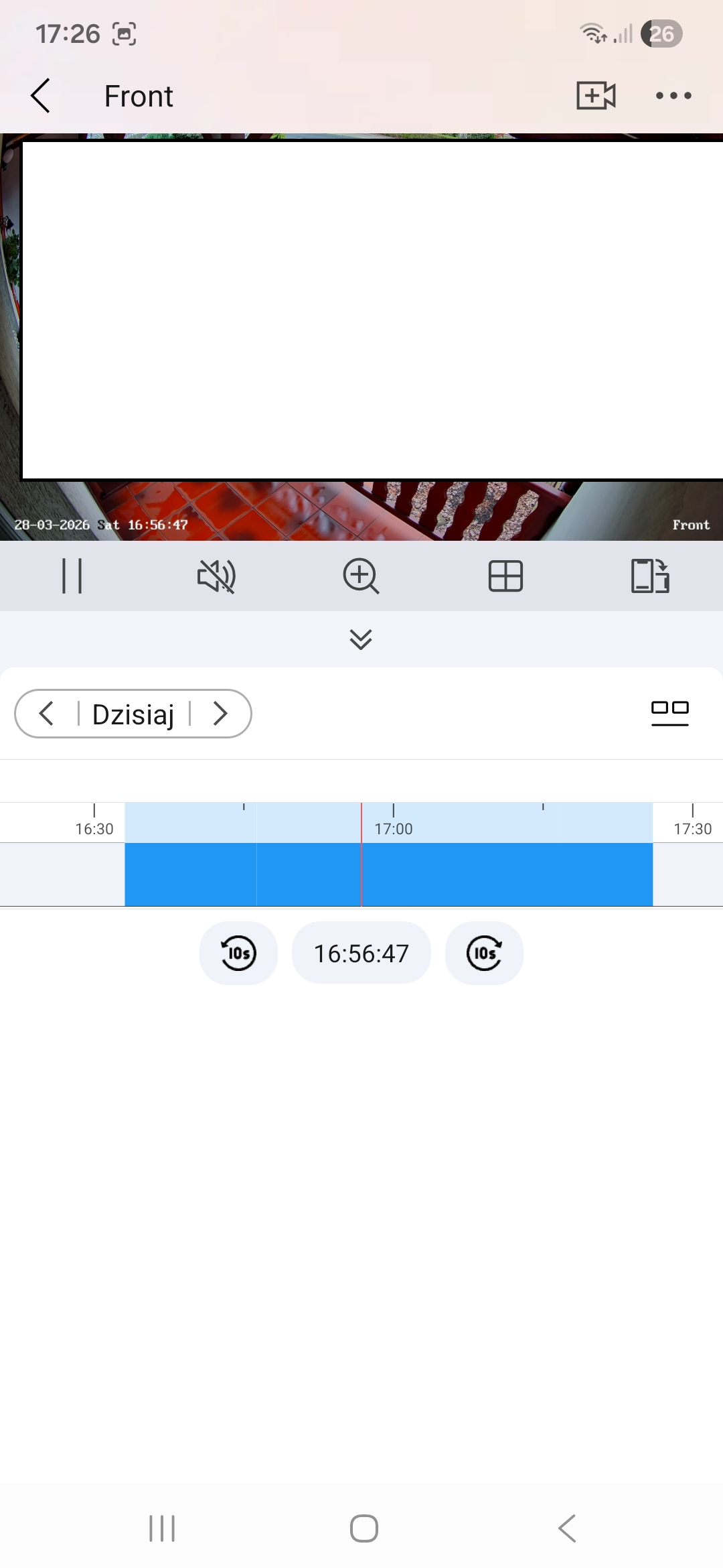

But I don't have VCA events marked on Timeline in Hik-Connect app while browsing recordings, and I have seen other people's timelines screens with blue timeline and VCA events.

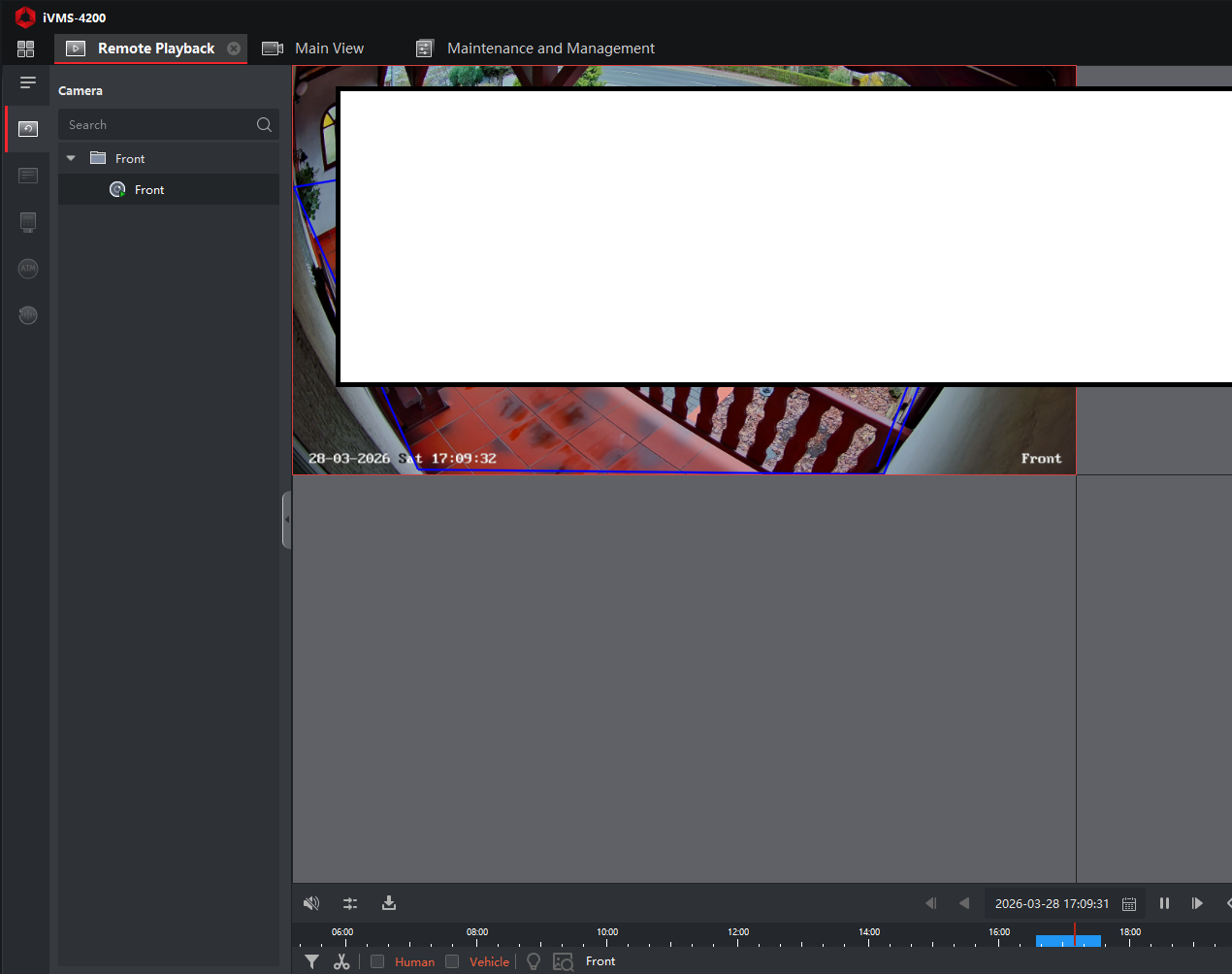

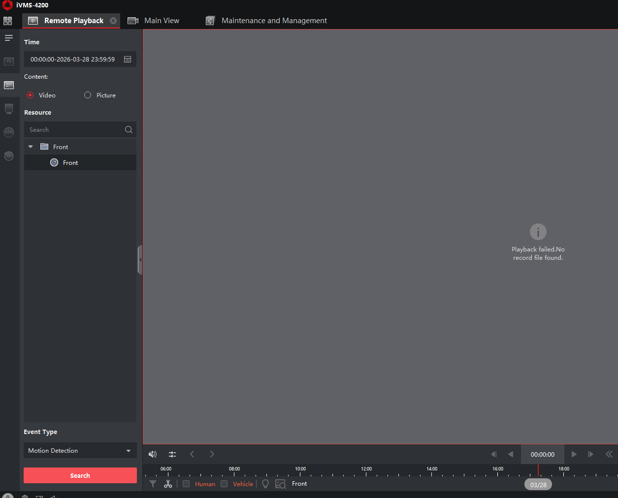

Also I don't see those events in IVMS, they are not in "Event Playback" tab. I also don't see them marked in Playback menu while browsing camera via web client.
I could see events in IVMS and on Hik-Connect timeline if I mark Schedule tab with "Event" instead of "Continuous", but then of course I don't have continuous records.

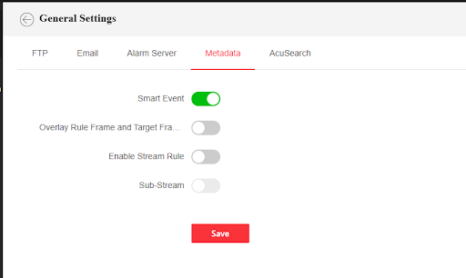

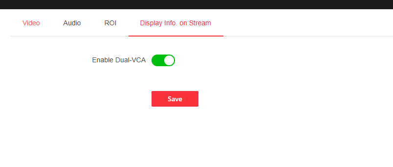

Configuration > Video/Audio > Display Info. on Stream > Enable Dual-VCA - ON
VCA > Metadata > Smart Event - ON

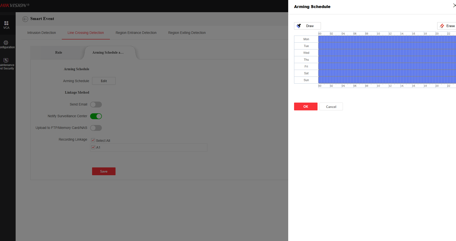

VCA > Line crossing (or other options) > Arming Schedule > Notify Surveillance Center - ON + Recording Linkage - A1 which is my SD card.
What am I missing? Shouldn't it work with those setting?
