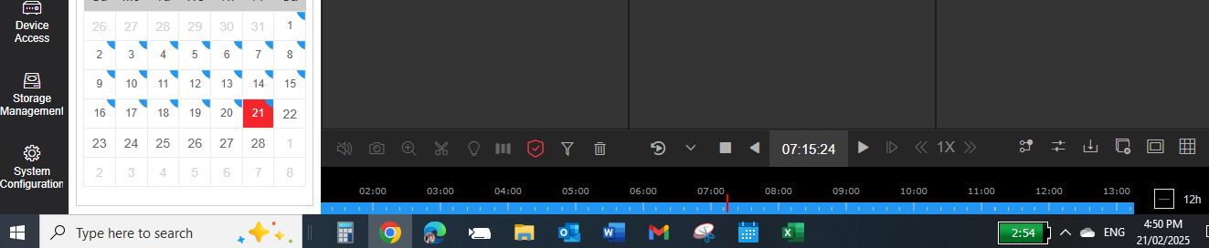

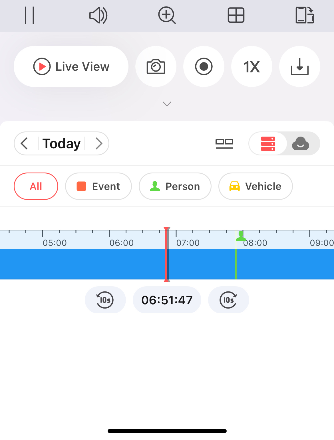

Question - when using Web UI and using the Playback function, the playback timeline doesn't show any human event markers (I just have a solid light blue shading on the timeline). Is there something I haven't set correctly or is this feature missing from the Web UI?
Note when using HikConnect on my iPhone, the Playback timeline shows the human event markers.
Thanks for any of your thoughts here.
The Human markers are showing on the timeline during web payback on mine. I'm using Safari on MacOS so not sure about other browsers but will check later. There's nothing special needed for them to show apart from obviously the Human box being ticked for the camera in the motion detection setup.
Very strange then for me.
I tried both Edge and Chrome browsers on a PC and no event markers on Playback timeline, and yet on my iPhone I have them. See attached screenshots - first one is on iPhone and there is an event just before 08:00, and yet on the 2nd image from a Chrome browser, nothing for the same camera and date/time playback.
Appreciate if you or anyone else has any thoughts on how to fix this.

The first obvious thing I notice is that your browser has no Human or Vehicle icons above the timeline whereas mine does.
You didn’t detail what cameras you have? If they’re not AcuSense the browser won’t show Human Vehicle markers or icons

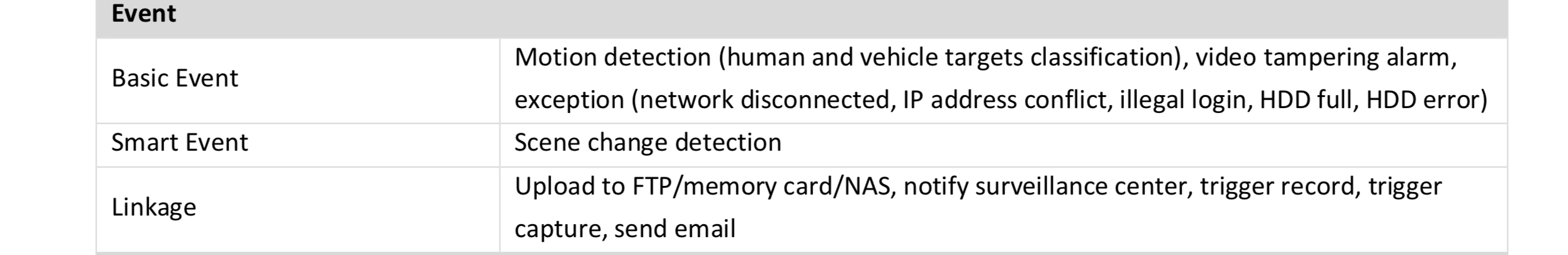

Hi - the 2 types of cameras I have are:
- DS-2CD2T87G2-L
- DS-2CD2387G2-LU
And camera data sheet states:
What’s interesting is the iPhone playback on Hik Connect has the markers, indicating cameras must support?
- DS-2CD2T87G2-L
- DS-2CD2387G2-LU

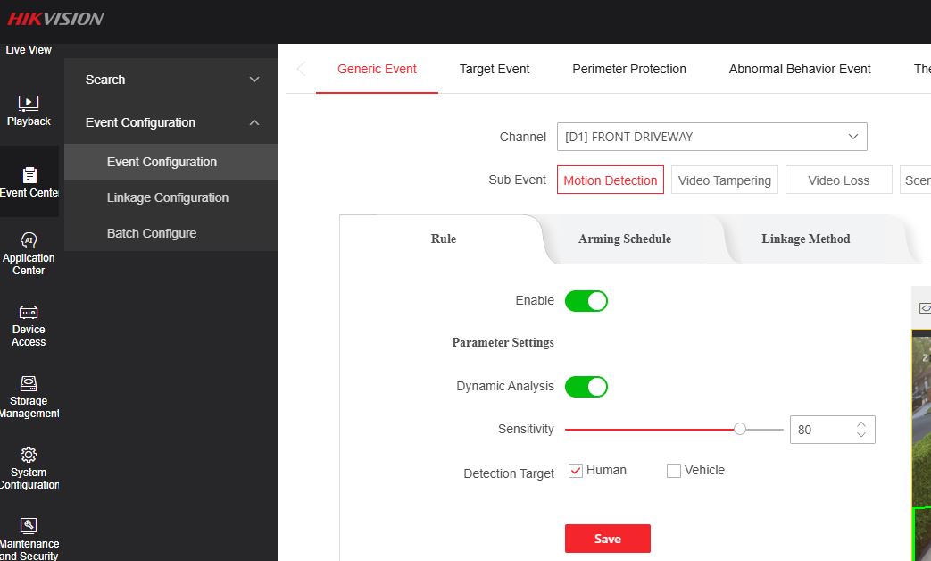

Ok so they’re both AcuSense but In your event setup for motion detection is motion detection enabled and is the Human box ticked? That’s what’s needed - the NVR is not just going to analyse all footage and put Human markers in the timeline; you need to create that event and filter it to Human and/or vehicle.
Yes I have Human Detection enabled (which is the only one I want) per below.

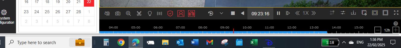

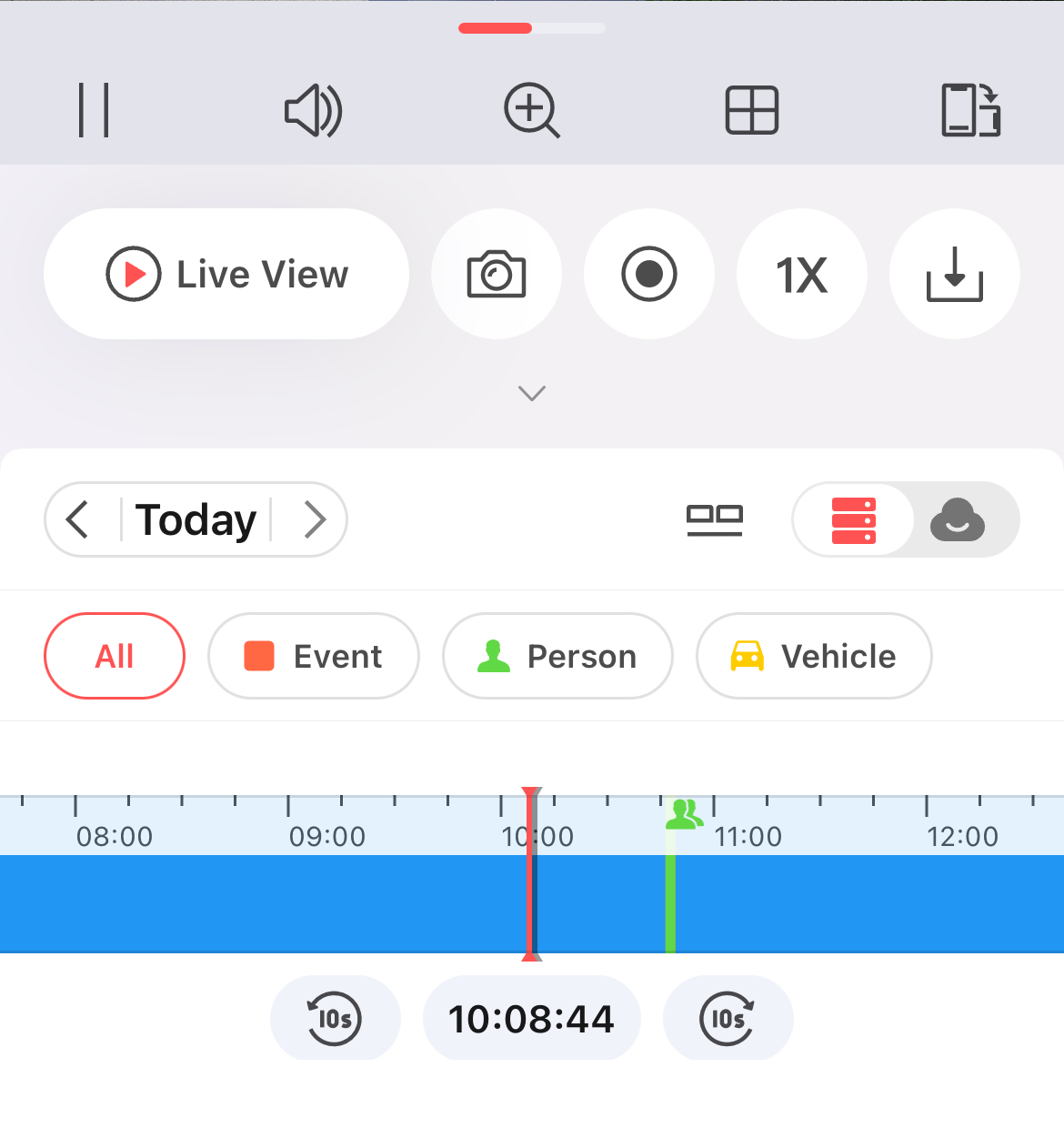

OK we're almost there hopefully - I set the playback to single image window only, and I now get the Human and Vehicle filter buttons. But I'm still not getting the actuals markers shown on the timeline (and the filters don't take me anywhere).
See below images of same camera and timeline - first iPhone image shows human marker just before 11:00, whilst second PC image doesn't show the human marker.
Any other thoughts?
It appears that you have your setup similar to mine. I do have an issue with one of my cameras. The original issue with timeline markers missing in the previous version was fixed in .050. I've been switching back and forth between cameras firmwares 5.7.15 and 5.7.19 due to a bug in the camera firmware (VCA search unavailable for non Human/Vehicle target). I found that when Restored the latest version (5.7.19) onto that camera I lost motion detection markers again. I've not bothered to see if I can fix that yet as I don't need MD on the specific camera.
Hi @JohnD
What are the settings for Linkage Method for both Motion and Smart Events? Is Notify Surveillance Center enabled?
Did you check your cameras GUI interface to see if all the event configuration setting set on your NVR are also "passed" to your cameras? Sometimes some settings are not.
Are Smart Events set to AI by Camera or AI by NVR?
Hi @JB1970 - Yes that might explain it - I updated all my cameras to have 5.7.19 so hoping a future firmware update may fix it.
On your camera that doesn’t show event markers on your computer playback timeline, are the markers present via the phone Hik Connect app? If so then yes we have identical issue so camera firmware must be the issue.
Is there a way to log this error with Hik so Hik fix in future firmware updates?
